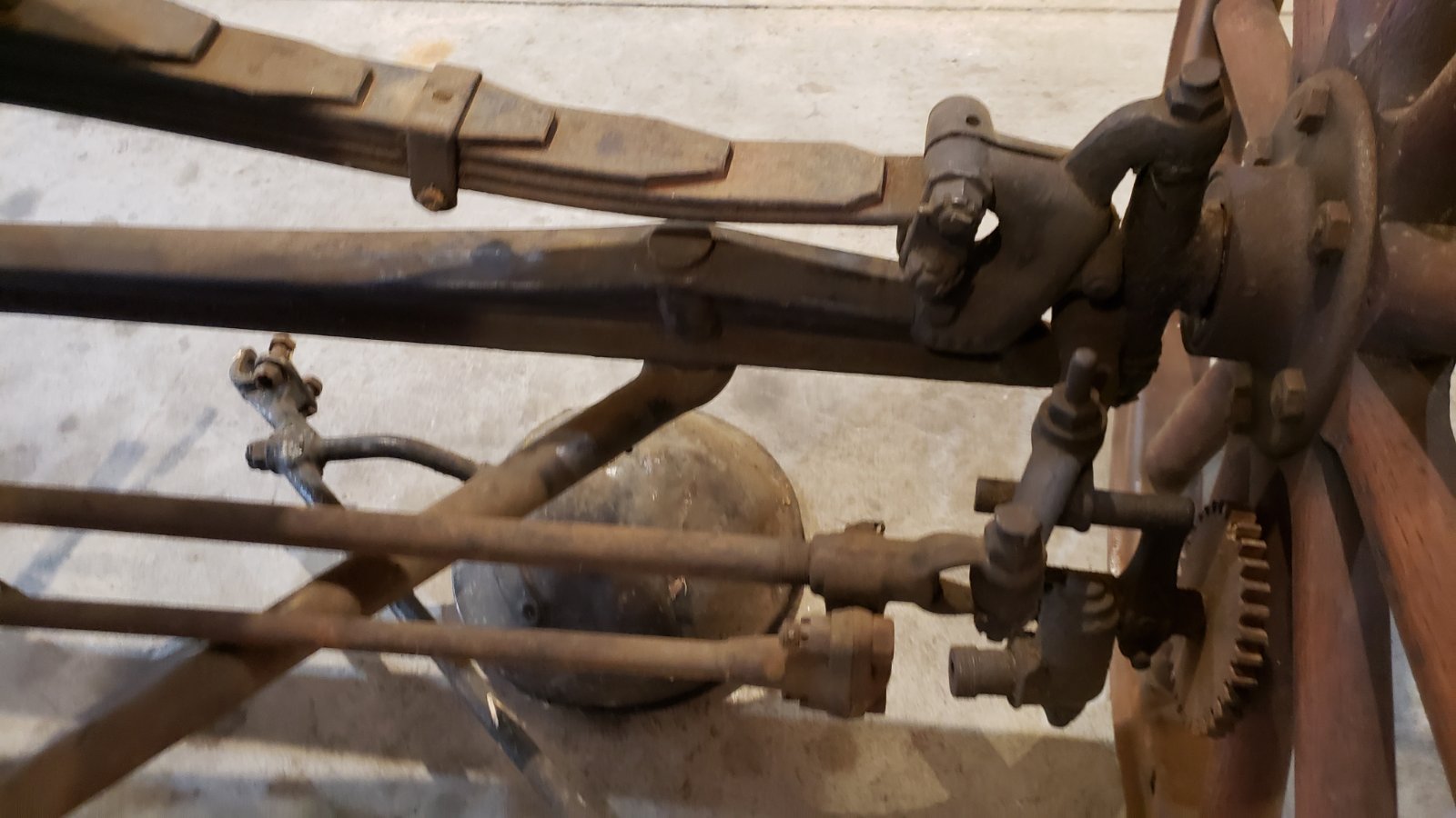

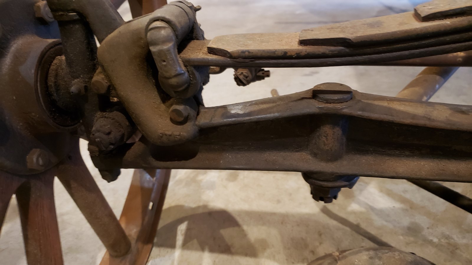

Post by Oldav8tor » Thu Jun 13, 2019 4:59 pm
Thanks - I looked at my steering arms today and they are not the straight version as on earlier cars (see attached photo.) I think I'll be OK.
I got the idea to install an auxiliary wishbone after reading an account from the period of Henry Ford being thrown from a Model T not far from where I live when his speeding T his some soft sand and the axle knuckled under. Apparently it still took a couple of years for the wishbone to be changed as Henry had to use up the stock he had on hand. Obviously it was a known deficiency because people were adding under wishbones for years before the design changed.

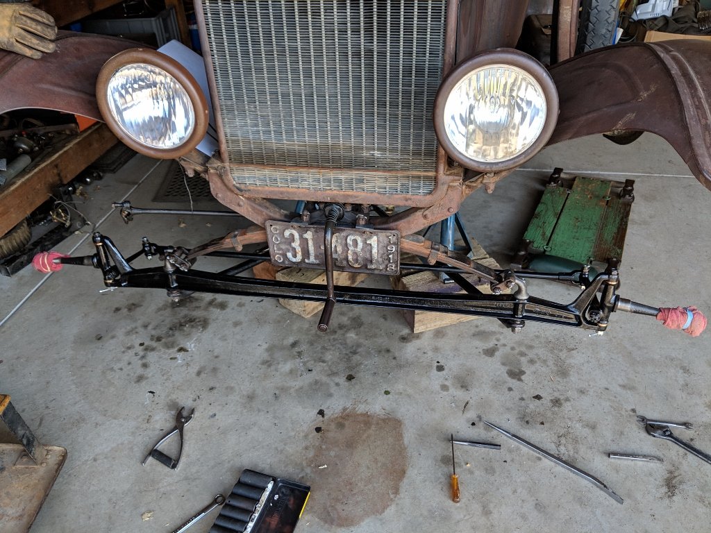

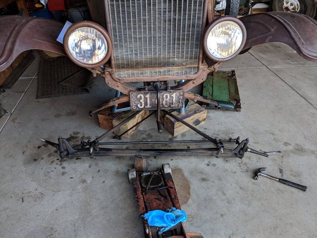

I switched mine over just to be safe. My front axle was very worn out so it seemed like a good idea to do it while I had it out.
Still crankin old iron
