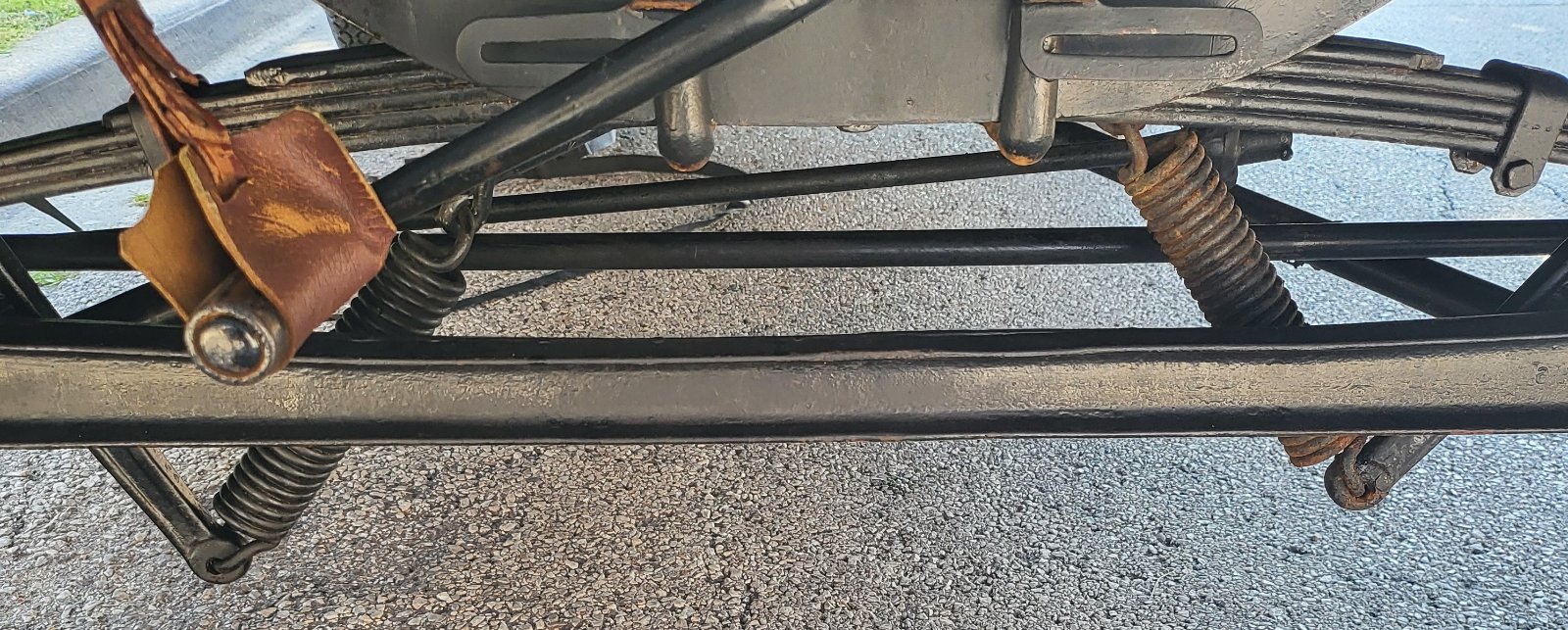

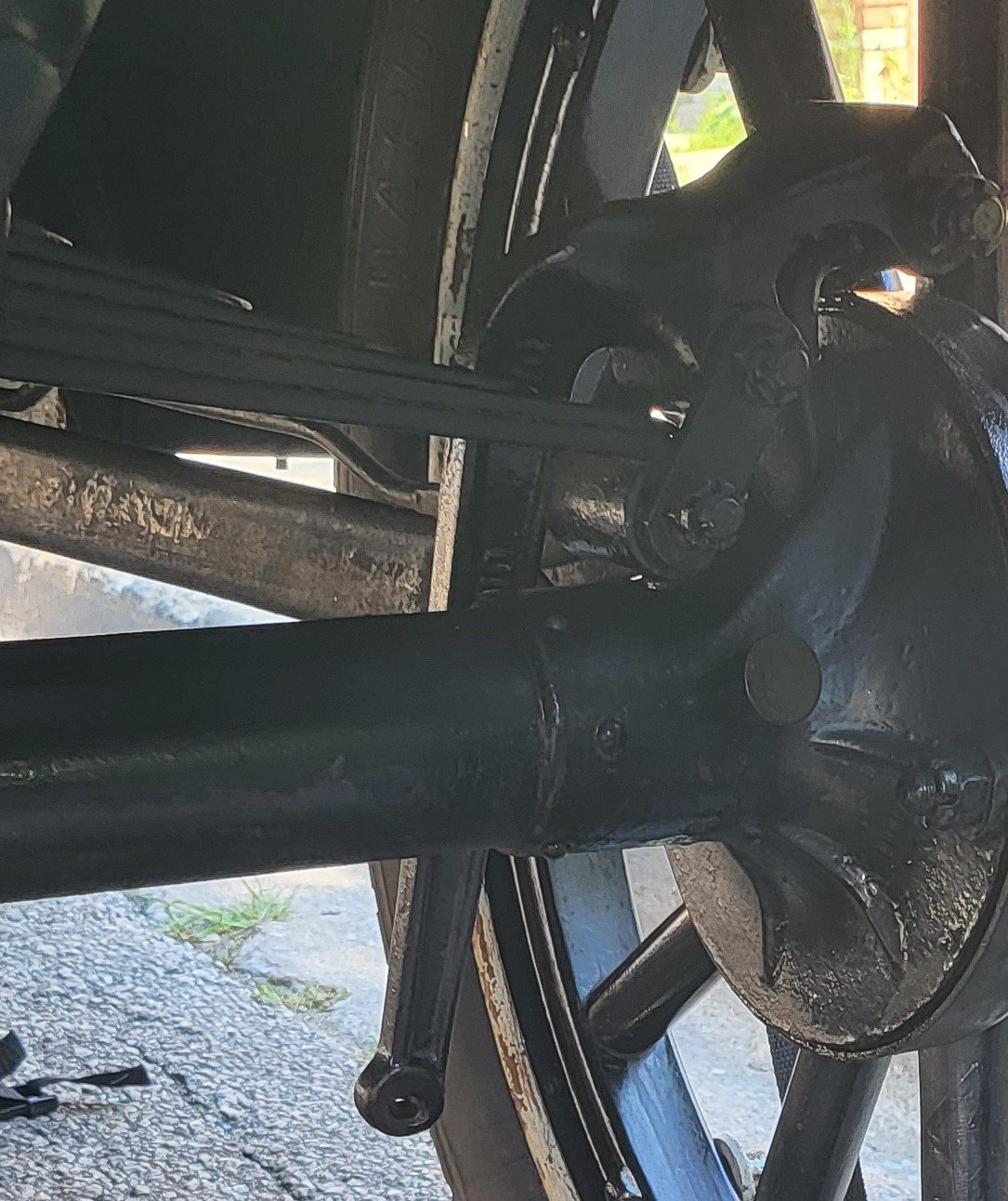

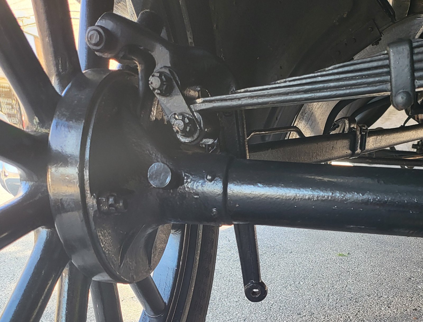

Hello All.

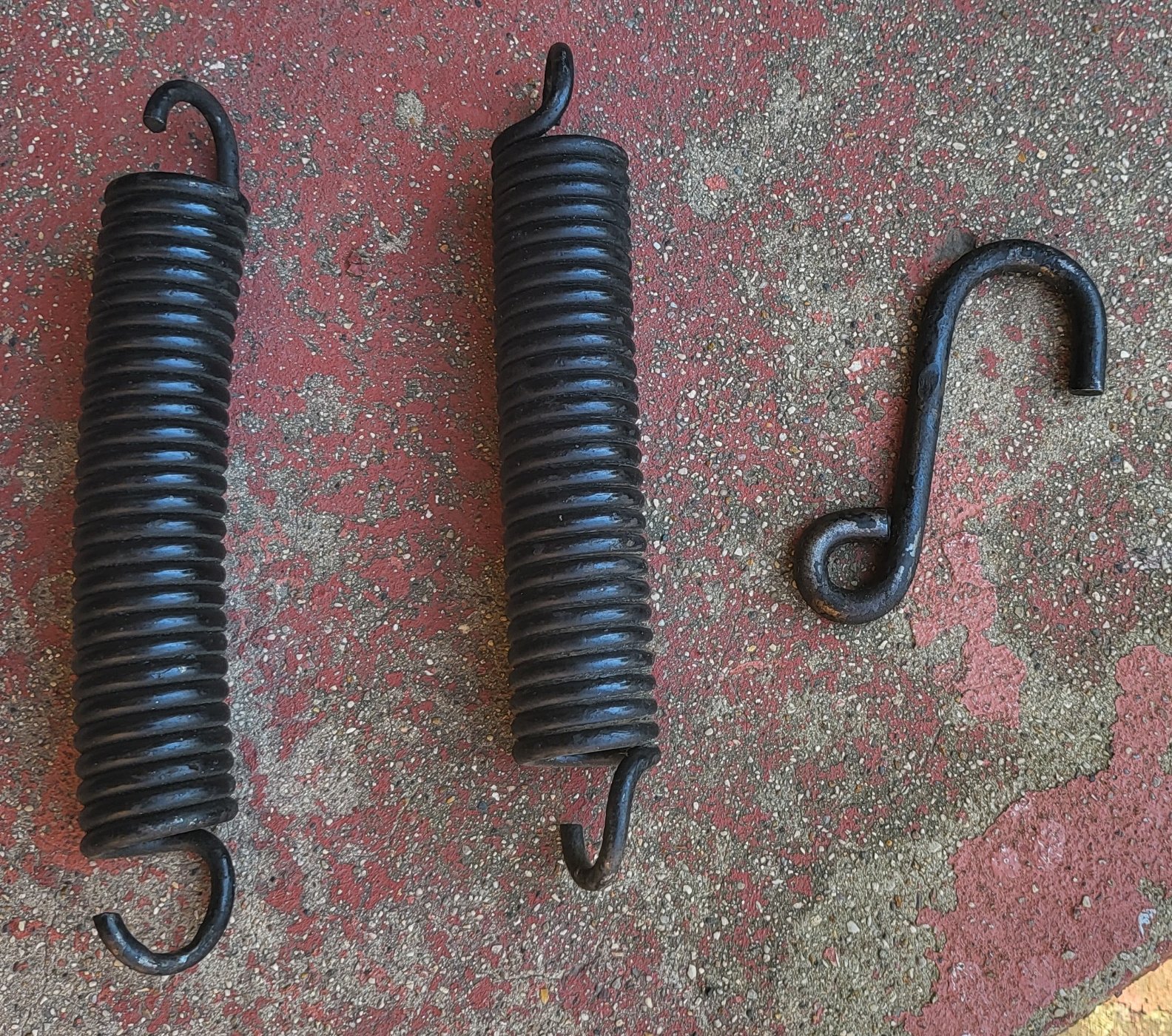

I just got my first Model T (1919), and it is equipped with these weird Hammond shock absorbers. The front ones consist of springs that connect to the oil pan, and the back ones aren't connected. I have the springs, but they connect to a weird hook and I only have one of them. The car drives fine, but if I go over any substantial bump in the road, it starts wobbling and I have to basically pull over to steady it. I can't find too much about these things besides some suggestion that I should just take them off. Any suggestions about how to properly install them, or whether the better option would just be a full delete? I'm attaching some photos for your reference. Please advise and thanks for your help.
Best,
Nick
Best,
Nick

- Posts: 5174
Re: "Shock Absorbers"

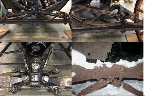

It appears the front springs are not on correctly. The all springs should be stretched in tension.(to double the length) Thats why they feel sloppy now.
What I have is attached, via hooks to the early motor mount castle nuts. (all 4 : different brand with 2 pairs of arms)
The link provided shows the rears hooking to the rear frame ears.
(I don't recall how my rears hook up. Will have to look)
I don't think they do enough to warrant being installed, especially on our current roads.
I don't notice any ride difference. They were on my 14 roadster along with a bunch of other period accessories, so I left them.
Erik makes a good point about wear & safety concerns. A thorough inspection of the pivot points should be done @ a minimum.

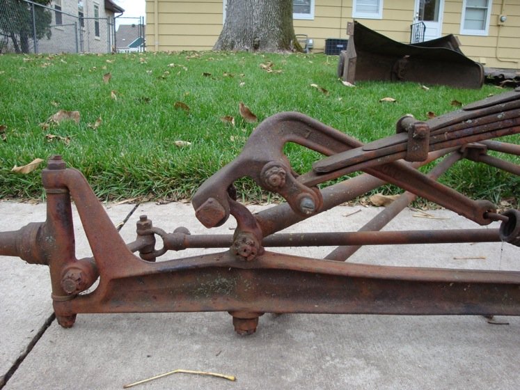

I believe Analysis of the wreck that killed Ken Meek blamed the antique aftermarket shocks that were on the car. I'm with Erik. Better safe than sorry.
- Posts: 6553
The shocks that caused Ken's death were perch style shocks. It may have been a defect in the shock or the overall design.Steve Jelf wrote: ↑Wed Jul 17, 2024 3:36 pmI believe Analysis of the wreck that killed Ken Meek blamed the antique aftermarket shocks that were on the car. I'm with Erik. Better safe than sorry.
https://www.mtfca.com/discus/messages/2 ... 1342495776
- Attachments
- 666666.jpg (66.88 KiB) Viewed 2011 times
- 299419.jpg (72.47 KiB) Viewed 2011 times

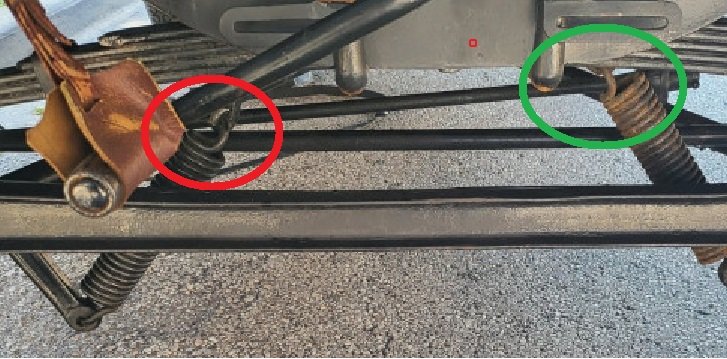

- Posts: 6553

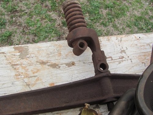

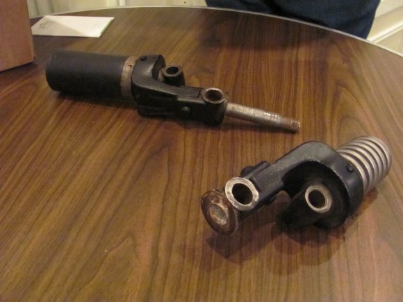

There were many different brands for the shocks you have. The rear are attached incorrectly and could be for the front. Can't tell from the pictures.
Looks like the right side spring is not attached as it should be
These photo's are for similar style shocks of different brands
