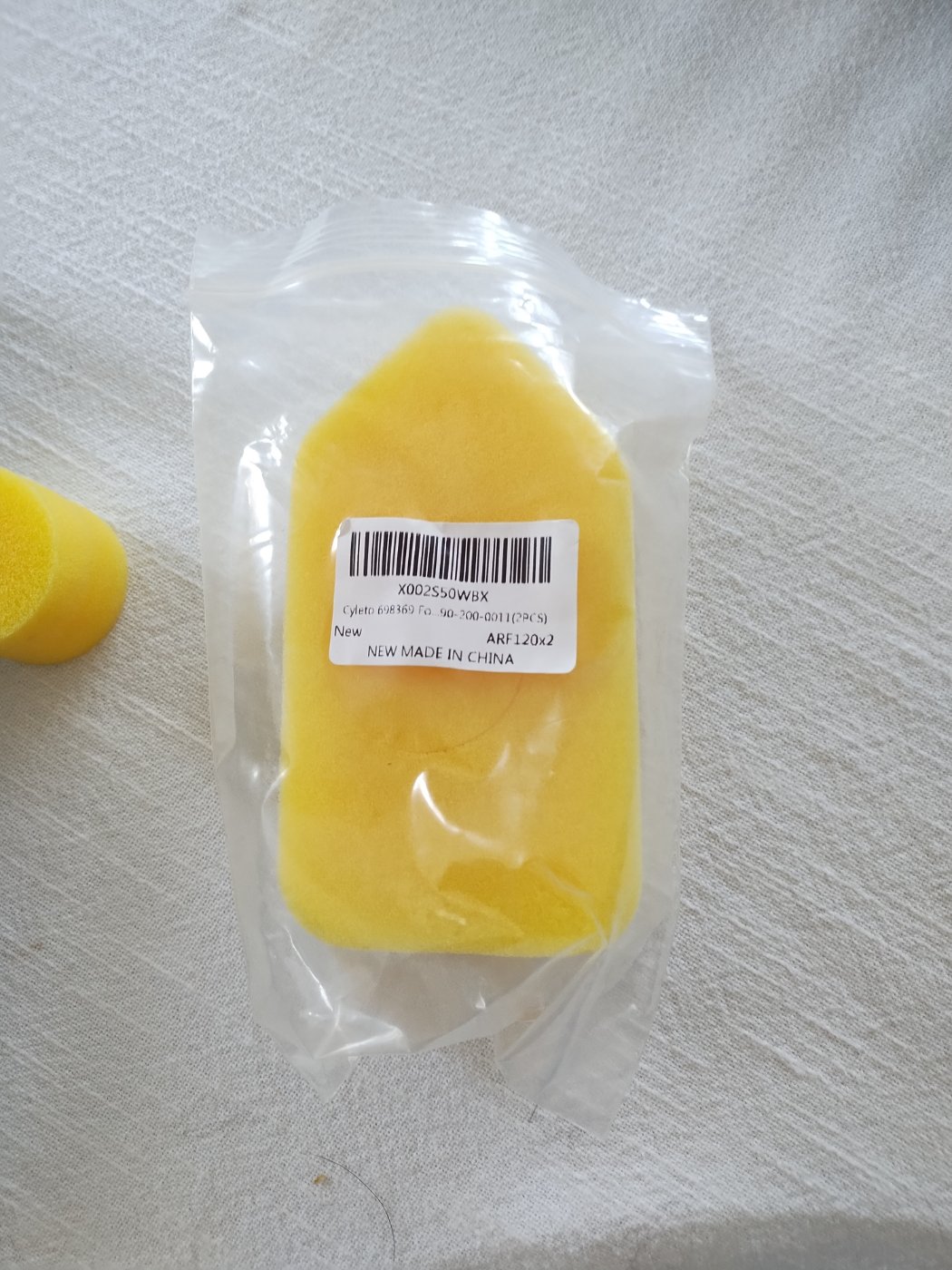

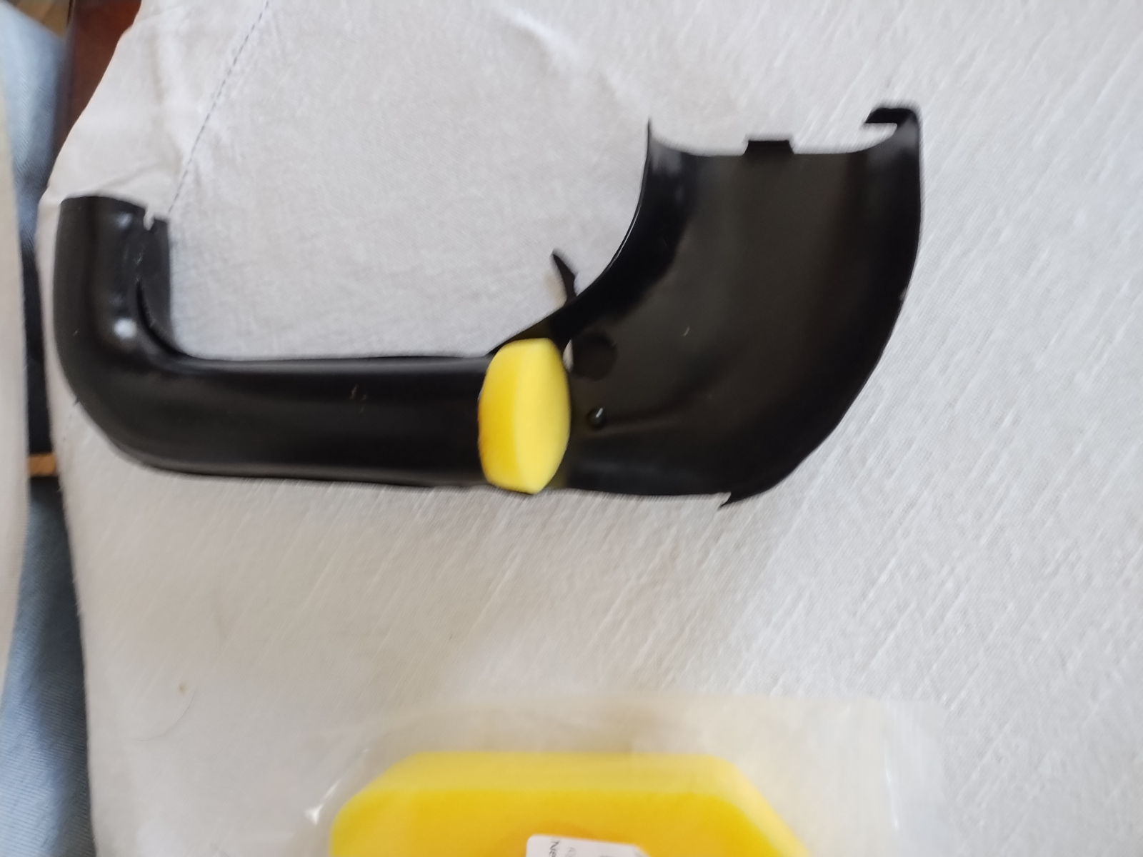

I found a free Air filter for my model T, they claim it improves fuel economy by 150 % when I got this tune-up kit from Amazon. Is this too good to be true? But seriously, would this work? Maybe add a drop of oil or a retaining screen?

Using a heat pipe will lessen top end speed by a bit. Choking the air flow with an additional foam obstruction would be much worse & more noticeable.
Would the foam melt? I think so. Might even seal the foam end & not allow any air.
Would make an interesting test. Without the pipe/with the pipe/pipe stuffed with foam.
Try it & check back.

I thought about that, as I have some I got for a sale but only to stop the foam from being sucked into the carb. A fine mesh cut into a circle fitting the carb opening might work. If the foam is moved down into the end close to the carb and holes are drilled just above the location of the foam's end would the heat issue be mitigated? Modifying the holes with a moveable cover could control the cold air ratio to warm for a beneficial temperature.

Yes, it's way too good to be true. Would it work? No. The hot air stove is not well enough sealed to direct all air flow through the foam. If it were well sealed, the foam most likely would never allow enough air to pass and would probably just choke the engine. (Especially if you added oil, as you proposed.)

Re: Free model T air filter with Briggs and Stratton tune up kit?
I moved the filter to the end that goes into the carb, tested the flow and there is no noticeable reduction. Now that the cooler weather is here ( NJ). I will try it on my T. First a test on the fire risk after checking the rated temp. Then next a temperature decomposition test to try and mitigate carb contamination. The foam's size O.D. and its compression seemingly work, as it is fixed in place and not collapsing choking the flow.
