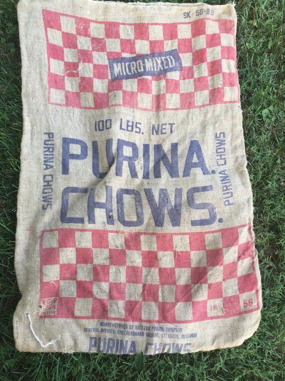

Back in the day, when money was hard to come by and many families had animals they fed Purina feed in burlap bags, the bags were abundant and reused to make clothing and seat covers when the original seat covers wore out or, in this case, protected
