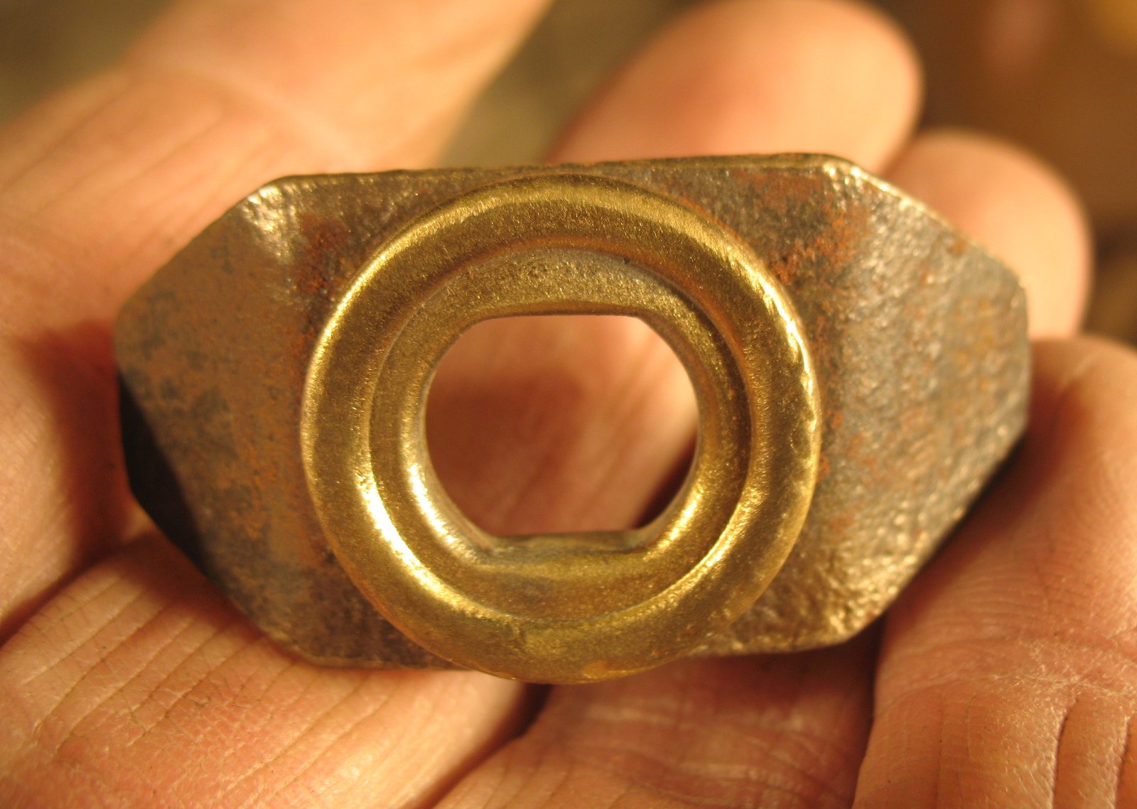

There are bridge washers, and there are bridge washers. There is some variety among originals, made by different companies at different times, but all have the raised ridge around the stem. That ridge presses into the rubber of the tube, squeezing it against the stem base for a good, tight seal. Modern bridge washers lack that ridge. They are perfectly flat on the bottom. I will not use them.

Steve's excellent photo illustrates why I leave a shoulder of the old stem intact when cutting off the stem. The shoulder left coincides with the relief in the bridge washer inside the raised ridge. This increases the footprint of the washer. As well as squeezing on the tube, it engages on the shoulder left from the old stem. It also means there is less chance of the rubber being squeezed out between the valve stem components.

The Model A Ford Bridge washers that the vendors sell have the raised ridge, but the outside shape is wider than Model T. The outer shape can be cut or ground down as needed.
