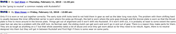

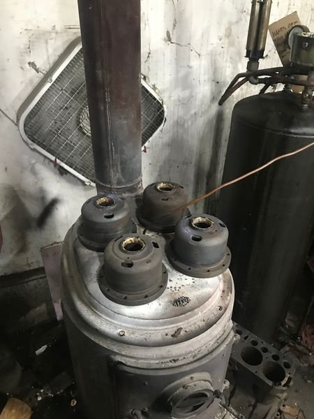

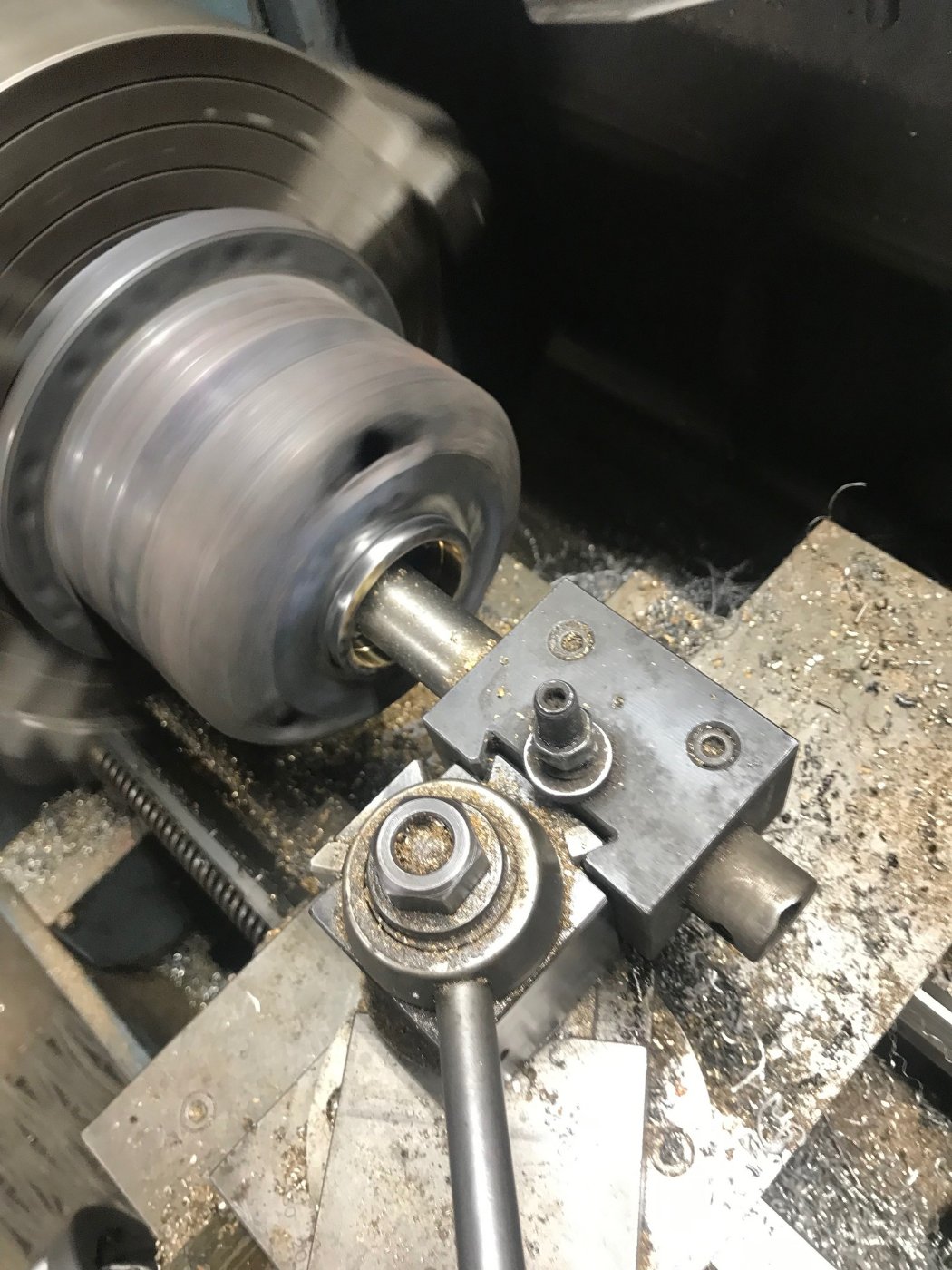

Stan makes the statement that the bell and the differential carrier is worn here the axle goes thru causing alignment issue and hard shifting.ThreePedalTapDancer wrote: ↑Thu Jul 25, 2024 6:44 pmThe late Stan Howe is here again to address this question.
So I think it was Erik Barrett that posted pix on social media showing him brazing up the place(s) where the axle goes thru and then machining it. I think he even mentioned that often times that area when cooled after the brazing shrinks where most of the brazing is machined out afterwards. I looked in my Ruckstell book for that measurement then (-and just now) and I don't see that bore measurement. Am I missing it??
- Posts: 5159
Re: Ruckstell stuck in neutral
That dimension is the same as a stock carrier. 1.812" Axle gear: 1.807" = .005" clearance.
