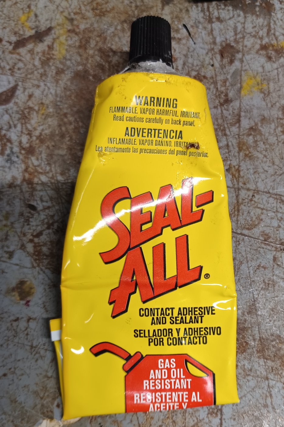

Try this stuff after you've emptied the radiator and made SURE it's DRY. Also wipe the area super clean with lacquer thinner. Then apply 2 or 3 coats with plenty of cure time of course. This study is very thin and does set up taxky very fast. I've stopped top tank seeps with it witj great success. This is fantastic stuff for multiple uses.MR.T.46962 wrote: ↑Sat Jul 27, 2024 8:32 amGreetings! My radiator has recently started seeping from the bottom. I hope I do not have to replace as it is a "seep" and not a leak, What do recommend as a repair vs. replacement? I have had many opinions on this, from my friends,who own Model T,s. Egg whites, modern additives, etc.Thanx,T.

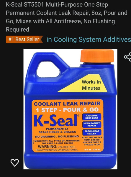

K-seal worked on the coolant leak at the rear coolant passage on my engine due to an over used head gasket during the shortage scare. Since replaced the head gasket. Any vehicle I have worked on with K-seal in it has no globs of goo anywhere during dissambely (usually do to head gasket failure) nor when flushing radiator.
Used frequently on chrysler minivans to stop the common plastic tank to radiator gasket leaks.
