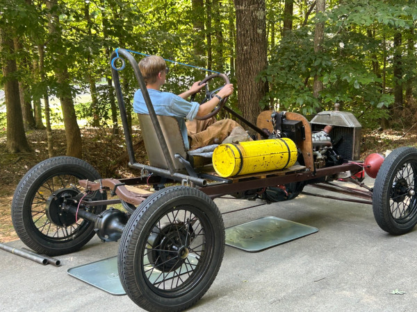

Rough mock up continues. Aux transmission will get a custom bracket and married to an already shortened drive shaft. Lowering steering column angle next priority.

Remind him that he will be most comfortable if he tilts the seats back about 10-15 degrees. Wish I had done it with my speedster.
Thank you for the post. I will enjoy reading it.
Posts: 6731
Re: 1913 Speedster, a 3-Generation Build
Post by Allan » Fri Aug 09, 2024 11:27 pm
Laying the seat back helps, but it still needs to be positioned correctly for the individual driver's comfort. If it is a bucket seat installed individually on the body base, you could consider more than one set of mounting points so it can be shifted at will.

The spindle arm nut should not be tightened onto the spindle until after the front suspension is assembled. The tie rod's bolts will dictate the position of the arm on spindles. Tightening before final assembly will guarantee binding.

Luke & Alex if you have not planned to put auxiliary brakes on your speedster, I strongly recommend you do so since you are putting in an auxiliary transmission. Using period auxiliary transmissions or rear axles make it imperative to do so. If they jump out of gear or your locked out from shifting into a gear puts you in a bad situation with no real way to stop. I’m enjoying the build & progress keep up the good work.
Best John
Craig Leach
Posts: 1933
First Name: craig
Last Name: leach
Location: Laveen Az
Post by Craig Leach » Wed Aug 14, 2024 2:21 am
Great to see the younger generations get into the hobby. I built a 1966 Chevy pickup with my granddaughter best time ever!!! Muncie as a great
choice, with reverse you can eliminate the low peddle & lower the steering column even more. I hate to be a stick in the mud but I would figure
out a trans mount the will allow the frame to flex more than that one will, There should be a drilled & taped hole on the underside of the Muncie
tail shaft that will work very well. Model T frames flex a lot I find it best to not try to stop them from flexing.
Craig.

Great advice. Yes we heard that there is risk of moving and unable to get back into a gear. We have a set of new Rocky Mountain brakes that will get painted and installed.

Maiden voyage of around 15 miles. Stopped by our local hardware shop where lots of the small hardware pieces were sourced. Then lunch. Ran great.

Post by AEyssen » Wed Nov 20, 2024 4:51 pm
Action shot
