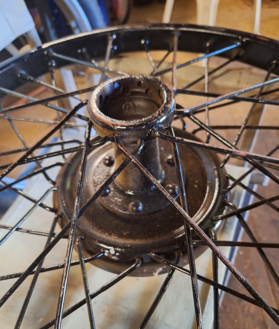

There were 30x3-1/2” and 21” rim variations of Hayes wire wheels. Both had the rear hub made up of the outer “snout”, and the inner drum. The snout did most of the work, but the drum is drilled to accept the inner row of spokes, making it a structural part of the rear hub. This drum doubles as the emergency brake drum and so the spokes interfere with most (maybe all) accessory brakes

Thanks for that, I had no idea that the rear wheels were made that way. The ones on my car do allow the Rockies but I'm not sure if it is a later large drum or the earlier small drum setup. I would love to see a picture of the Hayes rear wheel to see what was different.

Re: Hayes wire wheel rear hubs
Thanks, now that I see these pictures I can see that mine are different and the earlier discussion about brake drums makes sense. I'll save the pics for future reference.
