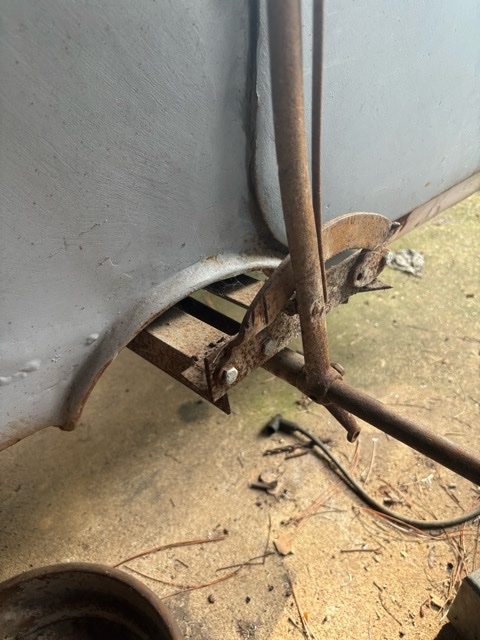

I know this isn’t the middle but I had to relocate the handbrake lever to the outside for my speedster I’m building. You can move the lever anywhere on the shaft then make a bracket to hold the quadrant.

I don’t have Sheller’s book in front of me (loaned it to a friend), but I seem to recall that he said this was a quick and easy modification to make. Corey may be on the right track… if you can easily move the handbrake lever to any location on the shaft, move it to where you want it, fix it in place, cut a new slot in the floorboard, and then come up with a way to deal with the ratchet quadrant with your left foot.
