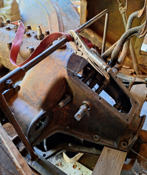

I made this helper that allows me to do the job on my own. It is specially useful with the heavy cast iron covers.

Allan nice set up but my fingers are hurting just thinking about those vice grips slipping off.

John, they are there to allow the cover to be lowered in stages, without me having to support the weight of the cover. Once the pedal rods are lowered to contact the ears, the vice grip holds the cover in place while I manipulate the springs and ears on the pedal shafts. Then it can be dropped a little more, and the ties on the bands removed before lowering it right down.
Our first gear band is the internally adjustable one on a RHD car. I fit the cover with the washer and nut in place, rather than risk dropping either into the abyss No need for stuffing rags tat get in the way. You could do the same with your reverse and brake washers/nuts.
