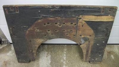

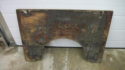

I have only seen one of these fire wall and it came off of my Canadian made 1912 touring Is there other cars with this fire wall. What makes it right or left is it has two carb adjusting holes one drilled from each side the extra hole is when covered with the serial number plate.

Thank you for the pictures and information. I built my 13 RHD touring with very little information. I’m running a OF carburetor so it wasn’t a issue for me

The factory drawings for the dash board from 1911 and updated through 1914 show boring two slanted holes to accept the carburetor mixture adjustment rod, either side of the coil box, to enable its use on either right or left-hand drive cars. At this late date, there are very few original examples remaining, I doubt if any reproduction dashes made the past 50+ years were bored for both applications.

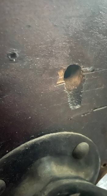

Interestingly the hole for the mixture rod on the left side has the bored angles in the opposite orientation than the hole that is used on the right hand side. This means that on a right hand drive car the entire firewall was turned around before being fitted.

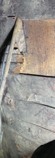

Left hand side unused hole from drivers compartment

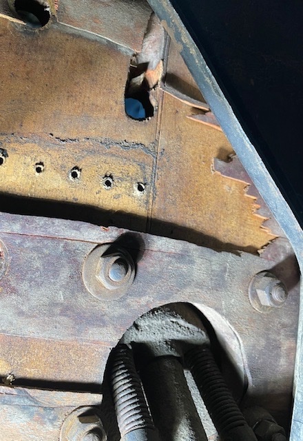

Left hand side from engine compartment

Right hand side from engine compartment

Yes, on the driver compartment side the unused hole was covered by the patent plate but the hole can be seen from the engine bay side.

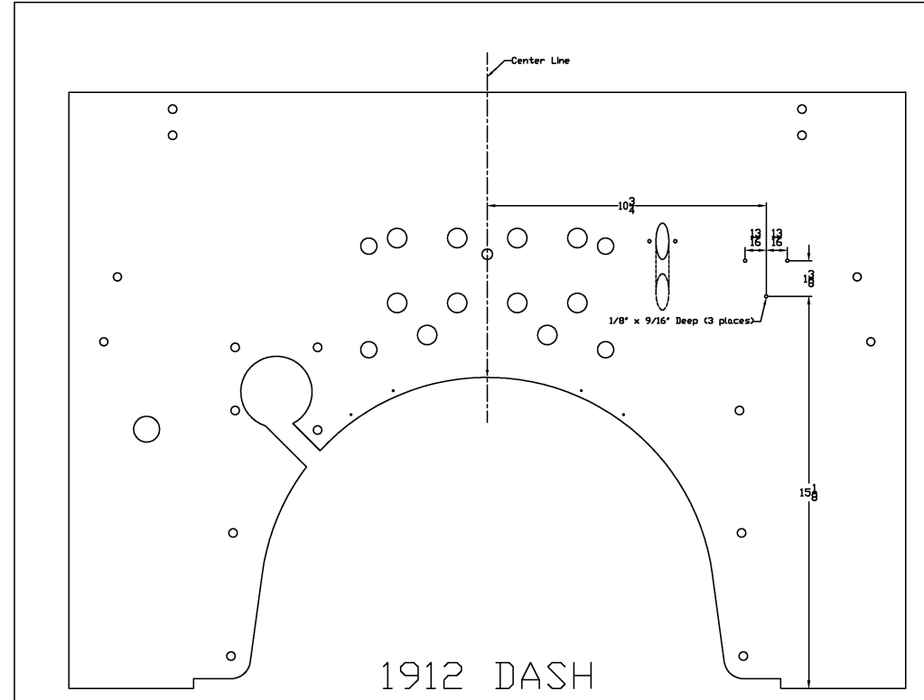

I have this in my files, can't remember its origins but only the one hole showing.
