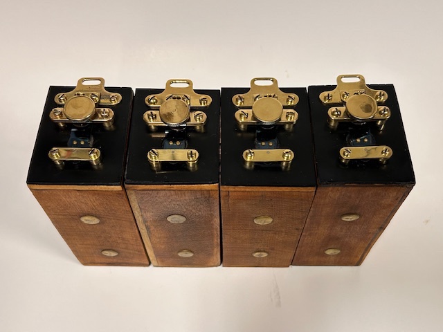

Hello Colin,
You can use the cap’s offered by the vendors. You will need the low profile one to fit in the box. I found some issues with the Kingston points and in the process of making a few prototypes that will perform better.
I am still several months out but getting closer. I can tune the existing points to run better but I know I can make them run better. Without going into too much detail I found the Kingston tuning was being set pretty low which also makes them fire inconsistent and have about half the output they should.
They will fire and run your engine but there is a lot of room for improvement.
So more to come but I have been tuning these for anyone that is in need to keep their cars running.
I also make new tops since the old tops are typically warped.
Feel free to contact me for any additional info. I attached a photo os a recent set I replaced the caps, new points, new tops and tuned.
David Woods
Williamston T Works (Facebook)
David Woods

Woody23
- Posts: 73
- Joined: Thu Jan 07, 2021 1:40 pm
- First Name: David
- Last Name: Woods
- Location: Williamston
Re: Kingston coils
I have seen that post and ran coils at those settings. My findings where this will work and the car will run but they actually have a pretty low output, about half of a tuned KW coil. Almost off of these rebuilt coils ( Kingston, Hienze, Splitdorf and L&B) are now running with KW primary and secondary coils so why not set them to run as hot as KW?
I also found the only way to get these to fire consistently is to run them hotter. The lower settings allow them to double spark and drift, the feedback I get is very positive and typically hear the car never ran as well. Once I finish testing the new points I plan to put out an article explaining in more detail.
In the interim I can get the current version of points to run better but like I mentioned there is plenty of room for improvement.
This applies to all makes, early cars without a magneto are much easier to tune since most owners are running them on 12v batteries but early T’s running on mag add a little more challenge since I need to know the condition of the mag so I can set the coils accordingly. T magnetos ramp up to their peak voltage which will change with RPM’s so several things to consider when tuning for best performance.
Hope that makes sense.
David
Williamston T Works
David
Williamston T Works
