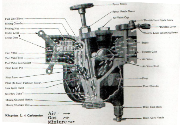

L-4 Carb Diagram.png (456.5 KiB) Viewed 1889 times
Assumed L-4 or general instruction
Some detail step by step L-4 repairing instructions at https://modeltfordfix.com/repairing-a-k ... el-t-ford/
they also show 3 external variations of the L-4
From the Model T service manual

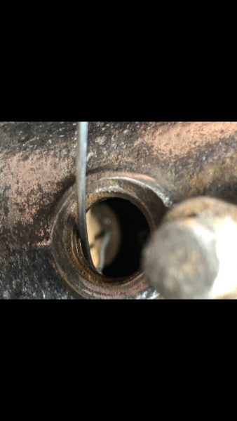

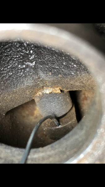

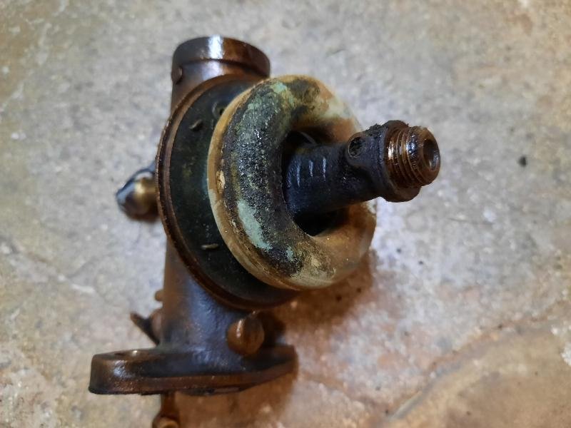

Thanks for the links, info and photos, Frank. I have disassembled this L-4 again, but cannot find those two air bleed holes shown in the two photos posted by Corey Walker in 2022. I used a strong light and poked around with a bent safety wire piece. No holes. I have attached the Walker photos, showing wires leading into these holes that I can't find. The inside of this carb is very clean after a thorough glass beading, but I still can find no evidence of air bleeder holes as shown in the two photos. Our L-4 has a brass body with steel bowl, meaning about 1921+. Would that make a difference in whether internal air bleeder holes are present? Perhaps the photos show an earlier version of the L-4 or even the L or L-2? The only air hole I can find is between the fuel inlet port and the throttle opening, externally. It's a short passageway and is clear.

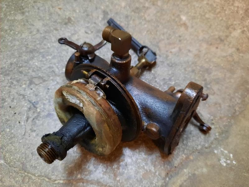

Also, the original info on the Kingston carb says there are four holes drilled in the venturi just above the lower end. Attached is a photo of our carb before the 1st disassembly and cleaning. It looks MUCH better now. Where are those four holes? Can anyone see any problems here?
I am confused because the sources I am using jump around from the L to the L-2 to the L-4. The name plate on this carb was for an L-4 and it has the later oblong-shaped air valve. I just don't know what's going on with this carb and why it won't work. Suggestions?
Mark Nunn - There is no neoprene seal on the fuel inlet. Scratch that one off the list of probable problems.
ADDED: Incidentally, we changed the spray needle to the earlier type for this 1919 Centerdoor. The pictured later '26-27 style had been adapted to this car, complete with fuel mixture rod. Being a brass bodied-L-4, it's unlikely this carb would have appeared on a '26-27 engine as it came to us. It was undoubtedly "retro-fitted" by a previous owner who mixed and matched parts.
