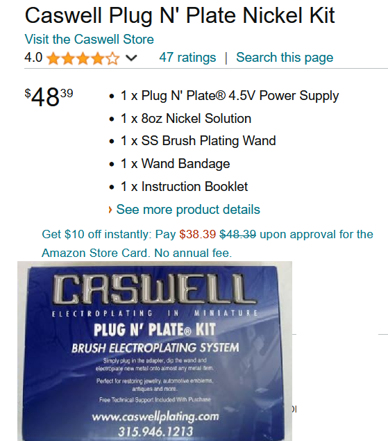

The most recommended plating supplier is Caswell the have a variety of methods all depends on what your intending to do & size, so start looking at this one and others https://caswellplating.com/plug-n-plate-nickel-kit.html same price as on Amazon
