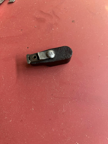

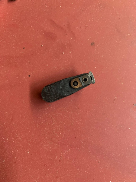

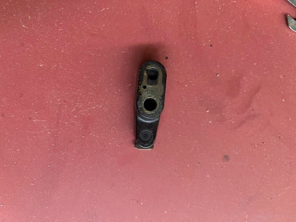

Hello all,
I recently had a mishap with the rotor on my '25 coupe and part of the contact at the top has broken off. There is no identification on the distributor that tells me what make the distributor is, and I have not come across a rotor that looks exactly like this one before, so I am struggling to find a replacement rotor. Would anybody be able to identify what make my rotor/distributor is based on the attached pictures or would anybody have any ideas as to where I could find a replacement?
Thanks,
Henry

Hi Henry,
I'm a distributor fan & I don't think this is a real big issue. There are several rotors with a contact that is very close to that & others can be used
to make a replacement contact for that rotor. The issue is you can't easily drill & cut that kind of spring steel & there is really no way to rivet
it back together so you will need to drill out the rivet & tap & screw it back together. I have even seen them soldered on.
These are some examples of what is available, these are Standard Motor Products part #s & the applications should help too.
Craig.

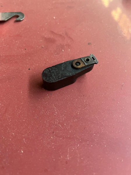

There's a lot of similar rotors, but the one that's needed appears to be driven by a pin that fits into the small hole on the underside. None of the ones pictured above as being possibly "close enough" will work. That drive pin aspect will perhaps be a feature that speaks to someone familiar with that style.
Can you post a picture of the distributor itself? It may be that someone will recognize the brand.

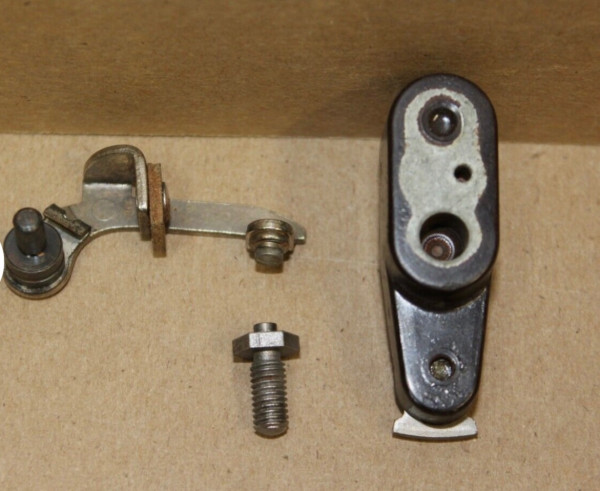

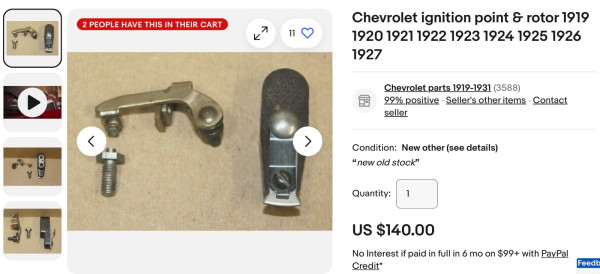

That’s a late teens early 20s Remy Chevrolet rotor.

Craig Leach
Posts: 1951
First Name: craig
Last Name: leach
Location: Laveen Az
Re: Mystery Rotor - ISO replacement
Post by Craig Leach » Sat Aug 17, 2024 10:35 pm
Hi Henry,
That rotor on eBay is a perfect example of what I was talking about it has been repaired the same way.
Craig.
Craig.

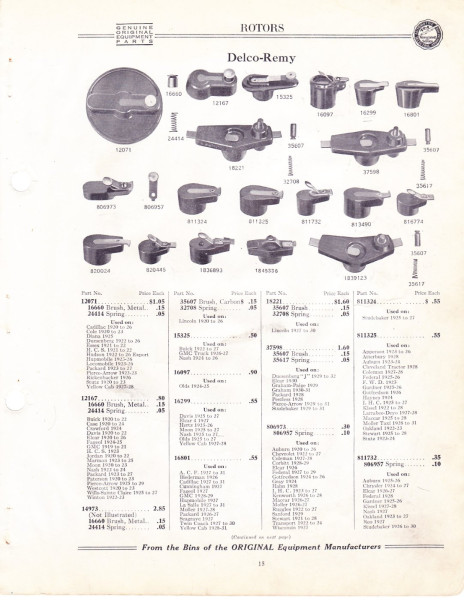

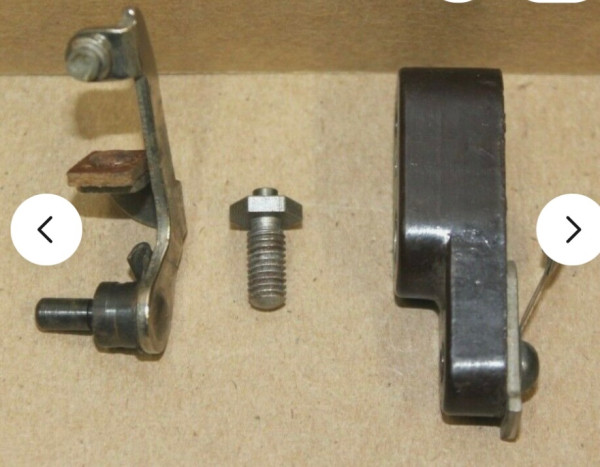

The rotor that is shown in the Ebay listing that was posted by Ed has not been repaired, that is an original Delco-Remy #806973. That rotor has/had a replaceable contact point/spring (#806957) that was sold separately for service. The one that was posted by Henry in his original post is an aftermarket replacement with a non-replaceable spring, I would guess most likely Shurhit or Niehoff.

Notice also, the eBay rotor has the drive pin hole located right of center, while the OP's example has the hole left of center. I assume this denotes a difference in rotation, CCW versus CC, or visa versa. I suppose in a pinch, a new hole could be drilled to suit... maybe.

Yes, I have those rotors in stock. The photos that threepedaltapdancer has above me several posts is not the correct rotor. Look at the underside of the rotor and note the placement of the drive pin hole. The rotor and system is a REMY and was used in the late teens to mid to late 20's. Actually, there were 5 different designs of this rotor with different pin locations. Note the correct rotor in the picture.
