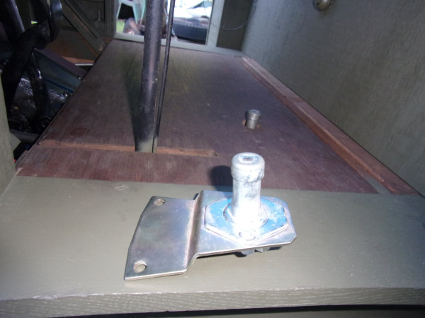

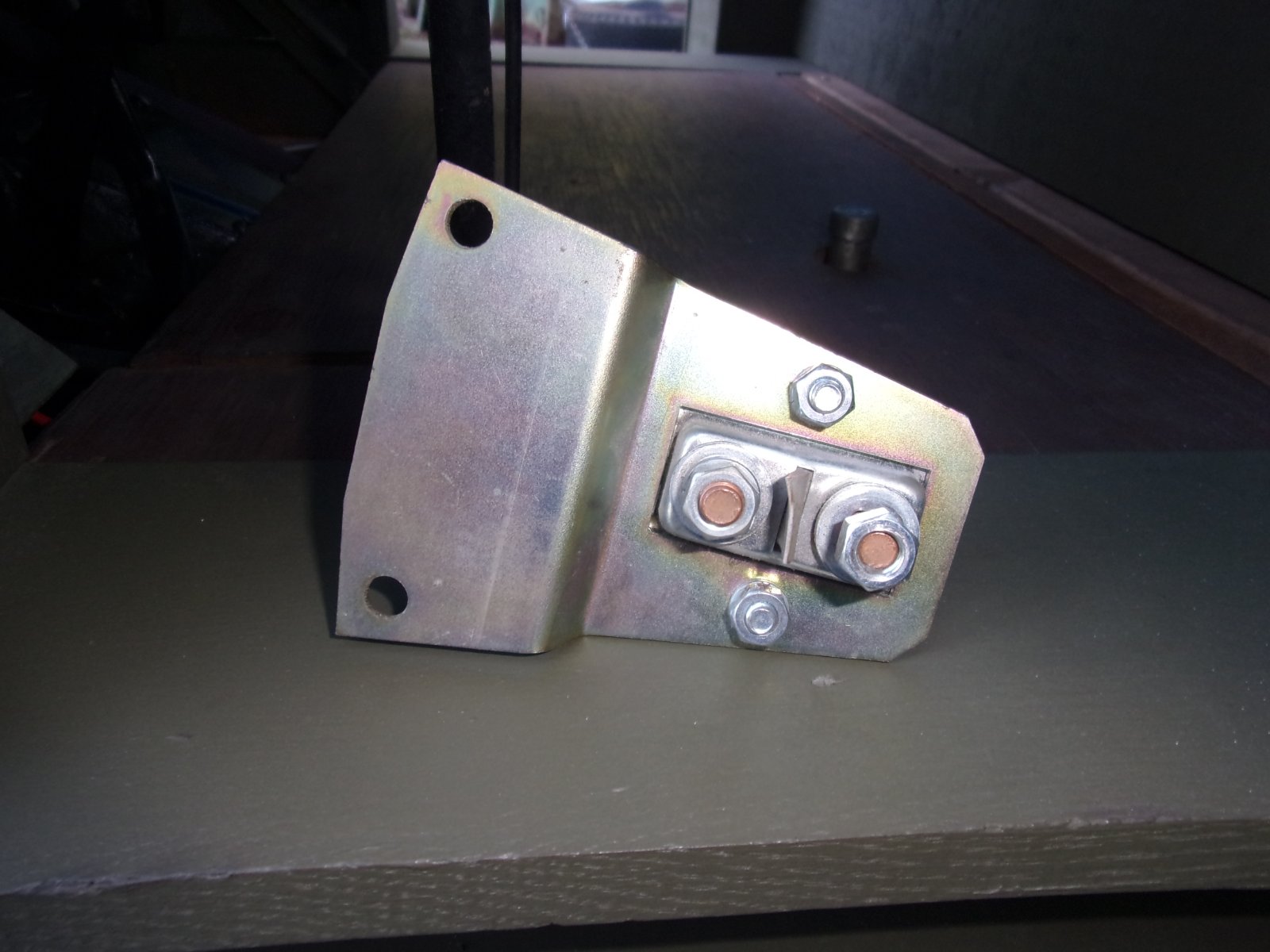

Here is a pic of the two starter switches I have. Identical, but do not know if Model T or tractor switch. Both have rubber flap in between posts.
And, after two days of getting close to the ledge, it turned out to be low voltage on the battery. Charged battery today while running errands and reconnected original switch and it starts as before.
Never occured to me that the starter is a "go" "no go" thing. I"m used to slow starters or clicking or something when battery is low. To have the horn and siren work and the coils buzzing but not even a click on the starter is new to me.
But, looks like dodged bullet and learned something new so all is right with the world. Thanks to all who took the time to comment.

- Posts: 4053
Re: Did I Fry My Starter?
Good to have your report, and that the battery was the culprit
That footswitch is the modern reproduction, which uses a tractor type push switch.

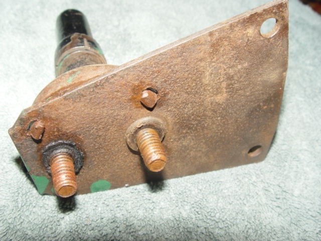

Here is the original Ford design of the later footswitches.

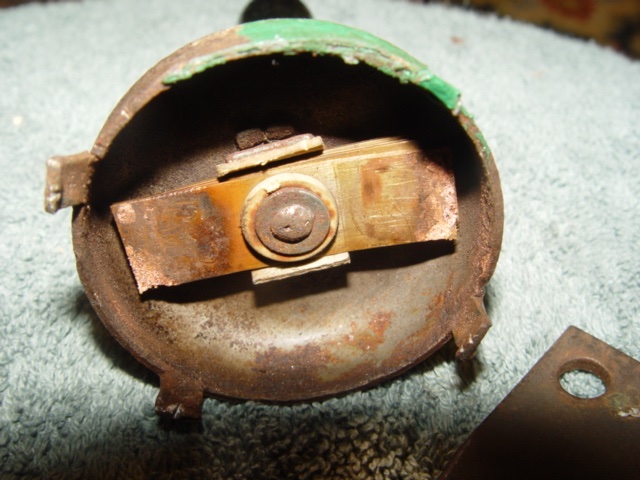

And the guts inside, a simple flex bar that makes contact to the terminals when the button is pressed. The originals do get worn over time, a lot of juice goes when starting, reason enough to never hold down the footswitch for a long period, and also, with long cranking over the starter motor can overheat too. A good tuned T motor will fire over with a brief push of the switch.

- Posts: 7164
The flex bar does look simple, but there is more to it than meets the eye. First it is laminated. That allows it to flex more, each lamination is free to flex as an individual piece. Multiple leafs allow a heavy current to be delivered.
Then there is the material used in the leafs. It is beryllium steel. Very tough and very springy. This helps the switch function well. The combined spring action of each leaf makes the break between contact on the terminals and off again really positive. This disconnect is also aided by the return spring on the foot plunger. I believe this is why many of the repop switches fail, that and the poor construction of the switch body.
