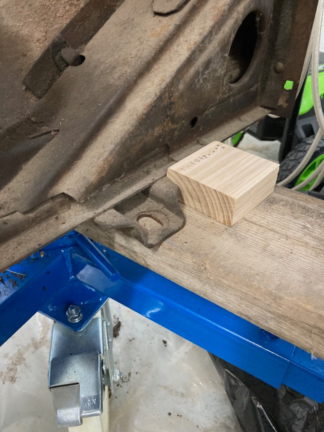

The pictures didn't get added to my previous post - sorry about that.
Here's the original block and the measured location ..
