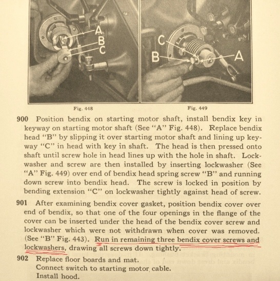

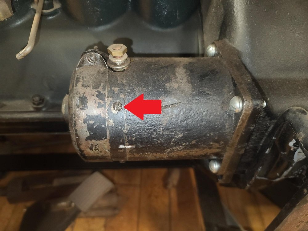

Ok - this is a new one - and I may be getting too picky...
Regrettably I trusted lock washers and I neglected to put thread locker on the slotted screws for my starter rear cover. The rattling noise and oil pouring out was my first clue. One of the screws is lost forever - and these slotted screws are not that easy to get to - so I went in search of Socket Head Cap Screws instead. Here's the rub - these screws are not a 1/4-20 or 1/4-28 pitch. They appear to be 1/4-24 x 1/2 inch ! I never heard of a 1/4-24 thread and neither has McMaster / Olander - and a few other suppliers.
Fortunately Lang's does supply these slotted screws but I still would like to find a SHCS (Because I am fundamentally lazy) So far I found just one supplier with this SHCS thread size / pitch but it's 1 and 1/2 inch long (https://military-fasteners.com/screws/s ... MS16998-60) and its a AN (Army Navy Mil spec')
I suppose I can keep using slotted - but out of curiosity does anyone happen to know of a supplier who might have it in a socket head?
thanks all and have a good one

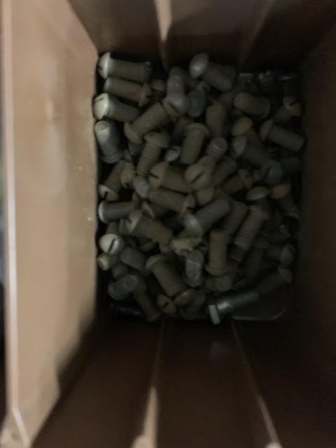

- Posts: 5302
Re: 1/4-24 x 1/2 in. starter end cap screw?
If you must have an allen head, there is a close enuf metric size a lot of guys use. 6MM? & a metric allen wrench. Personally I go with slotted.
Used to be Bob's sold the correct screws when he was retailing. Might try him.
The langs screws have a larger diameter head compared to stock. Still fit fine.
Use a dab of ultra black on the threads. They wont back out on their own or leak.

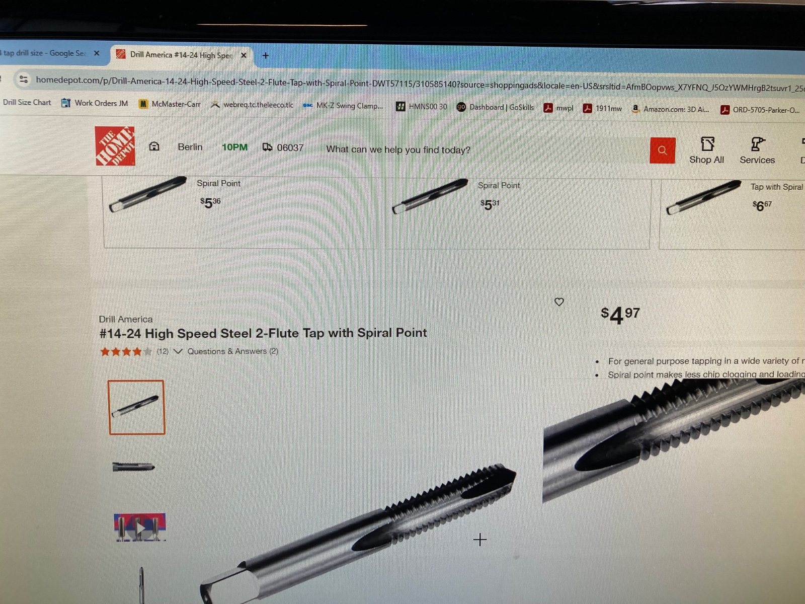

$11 + the cost of the odd tap! Thats a lot of effort & cost to modify your HH. They dont need to be safety wired. (refer to my previous answer)ElGranadaT wrote: ↑Sat Aug 31, 2024 1:36 pmIs this a common problem with these screws?
Getting back to your replies - 14-24 is a definite possibility but my thread tools don't have that one and that's also a bit off the path...
I may have found an answer though.
going back to the military supplier - I just found a 1/4-24 x 1/2 in match
https://military-fasteners.com/screws/s ... AS1351C5-8
for $11.22 for a pack of 5...
they also have a slightly longer one with holes for safety wire ---
https://military-fasteners.com/screws/s ... S1351C5H10
for $13.13 for a pack of 5...
Somehow safety wire seems like a good choice here -
They wont fit without rethreading to the larger 1/4-24.
14-24 & 1/4-24 are not the same diameter.
If you are going to butcher the HH anyway, rethread to 1/4-28 or 1/4-20. I wouldn't do this.
Go metric, at least the next caretaker can go back to the correct screws since the threads wont be changed.

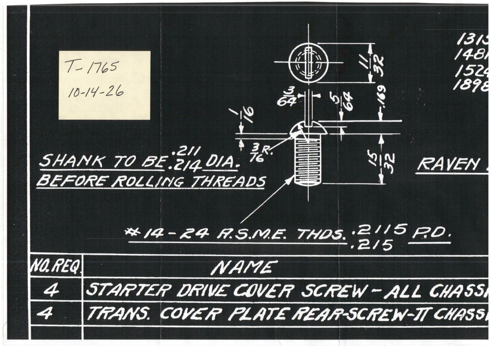

Jeff and John have it correct: #14 x 24tpi
Confirmed on the Model T bolt list.

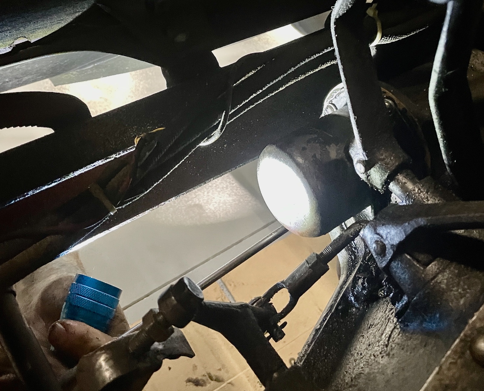

Great conversation- thanks again all - I am always amazed at the depth of knowledge on Ford T's...
At this point- I 100% agree its 14-24 --- I am abandoning my SHCS idea though in favor of "Keep It Simple Sheridan" -
So - solution?
I just bought a set of shiny new slotted screws from Langs. Given the driver slots and threads wont be as worn, and coving all with Loctite RED Threadlocker- this case is closed...
Yes - A bit more twisting and cursing- and maybe a second shot of Tequila after I'm done - but Vert De Furk... It is a T ...
So - solution?
As you can see Bendix cover screws are NOT Metric!

They are #14-24 and yes....unique.
Someone once wrote that they installed the 3 o'clock screw !/2 way without the Bendix cover in place, then turned one hole on the Bendix cover to a notch...wiggled it in place, then tightened. I have never tried this one myself...
I usually just push the screw through blue painters tape, set blade in screw slot, wrap tape around screwdriver shank!... When it is in, it tears away clean.
The late Ralph Ricks always swore by just going metric socket head once and for all and be done with it and use a long key. Even though the M6 metric screw is near identical to a #14 in diameter, the pitch is slightly 'off' and it's 25.4 threads per inch on the M6...Ralph claimed it stretched good enough to stay tight...

Hi all,
just when you thought it was safe to go back in the water... along comes another shark -
So, I ordered Lang's p/n 5060 Screws, Starter rear end cap to motor housing, Included Items:
___4: 5060-I Screws, Starter ear end cap to motor housing... Wouldn't you know it- they were
10-32 x 3/8 screws. Oh well... schtuff happens - Lang's is rarely off - and we all have our days...

Using the correct factory Bendix cover machine screws is the way to go.
And don't forget the lock washers too, while Lang's supply them with their set of Bendix screws (5059S) and only $1.95 for the set!
A long 12" shaft screwdriver helps a bunch to reach those pesky screws

Those 14 X 24 Screws are used in several places.
The original starter ring gears used 14 X 24 brass screws.
I was told they are now being made in China with 1/4 X 24, due to an error translation there that leaving out the / was an American mistake.
The Mag Terminal screws on the earlier transmission covers are also 14 X 24, if I recall correctly.

Post a link to that tap at HD

See pic. There is a self drilling sheetmetal screw of the same size and pitch, could be why they sell the tap. The thread percentage of the threaded hh hole may be greater than the standard H3, so I wouldnt run a tap in the hole unless needed as that would result in a sloppy thread. The hh casting holes are blind and just deep enough to accept the standard screw and washer. For chasing the thead, one may have to grind down the point a little to get the bottom threads cleaned.

You're overthinking this. H3 is a standard thread clearance. It will be fine. The only possible issue is if whoever rammed in the wrong screws also damaged the HH threads. (They obviously did, or you wouldn't need to chase the threads. Just hoping the damage isn't too great.) Yes, if you can't buy a bottoming tap, then grind off the point, or maybe even just a bit more.RecklessKelly wrote: ↑Tue Sep 10, 2024 8:39 amSee pic. There is a self drilling sheetmetal screw of the same size and pitch, could be why they sell the tap. The thread percentage of the threaded hh hole may be greater than the standard H3, so I wouldnt run a tap in the hole unless needed as that would result in a sloppy thread. The hh casting holes are blind and just deep enough to accept the standard screw and washer. For chasing the thead, one may have to grind down the point a little to get the bottom threads cleaned.

Just following up on the difference between 5060 and 5059RE. here is where the 5060 (10-32) screws go. It was entirely my FUBAR to order these -
The description was "Set of 4 small screws that mount the rear end cap to the starter motor housing. Steel"
As pointed out by a few of you- the correct 14-24 screws from Lang are 5059RE

Martin, upon looking @ your starter, I notice a couple issues. Your lower insulator is broken, missing or incorrect.
The washer That sits on top should be smaller than the insulator. There is a large steel washer that sits quite close to your brush cover band.
If your terminal stud is still snug to the internal buss bar, I would put the proper parts in play.
The nut that holds the stud(lower) should be brass & the upper nut to hold the cable S/B steel.
For clarification, Parts are: Formed insulator, thin brass washer, brass nut, cable, then top steel nut.
If the stud is loose, it needs re-soldering. (this is a common problem on these starters & limit cranking current)

The loose stud on the buss bar to which John refers occurs when the lower nut screws the terminal around when it is wound down too tightly. When assembling the components it pays to have a third nut on hand. John's order of assembly is spot on. However, if the lower nut is wound down tight, it will tend to screw the terminal around, thus breaking the solder joint on the internal buss bar. When installing that lower nut I wind three nuts on. The last two are locked together on the end of the stud. Then the lowest one is wound down to contact the brass washer. With a wrench on the lower of the two locked nuts, the lowest nut can then be firmed up on the washer/insulator without screwing the terminal about.
Hope this helps.

Hi - Sorry, I failed to mention that the image I posted of a starter is not my starter. Mine is new. This image came to me from Lang's tech support, after I asked where, exactly, the 10-32 screws go.

For a 14x24 tap, check with your local NAPA store. I purchased 2 or 3 of them from about 12 years ago. They ordered them and were there in about 2 days.

Greetings all - Finally wrapping this one up -
Got the CORRECT Screws from Lang's (Thanks to all for your help with that ! ) Worked great! No real issues but used thread locker and thanks for the tip about a wrench on my square screwdriver - I've done that before - but it's one of those many things you forget about over the years... -
The other piece of related news- swapped out Bendix spring while I was there- and put a new gasket on the starter- Between the cap and started gasket I fixed an annoying oil drip also ...
So - case closed-
until next time-
Thanks again and keep em' flyin'

Hope you bent the tabs over on your bendix screw washers, otherwise you will need to open it up and do that. Should last another 100 years.

Ford used 14 X 24 screws in several places.
Those brass screws that hold the magnets in place are also originally 14 X 24 screws.

As Jerry points out...#14 was a standard size when the Model T was designed. (There were further # sizes even higher but for some reason it appears that Ford chose to use the emerging SAE system for his bigger ones and thus the crossover). While SAE did exist and Ford was even an officer in the era before the T...personalities must of clashed as there is a whole lot of Ford practices that never made it into the SAE system by the time SAE was considered 'mature' about 1921or so.
As to the wives tail that the Chinese got confused and misread and used 1/4-24 and screwed up the whole thing in the first place? That's actually a tongue in cheek deflection that gained traction. For the first 20 years or so of mainland Chinese making product exclusive for export to USA in the Imperial measuring system, all of the companies that held export licenses had the standing rules and expectations right at quote time that the American buyer was to supply all actual tooling with the order so that the Chinese would NOT make a mistake in systems translation...changing OD and ID to metric is a slam dunk in either direction...Drills and taps and hydraulic fittings? Oh my...
