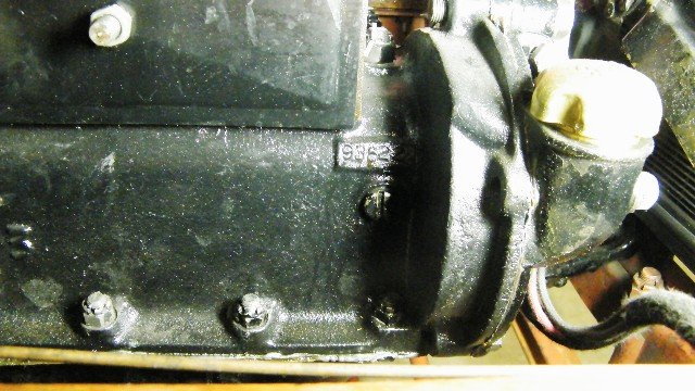

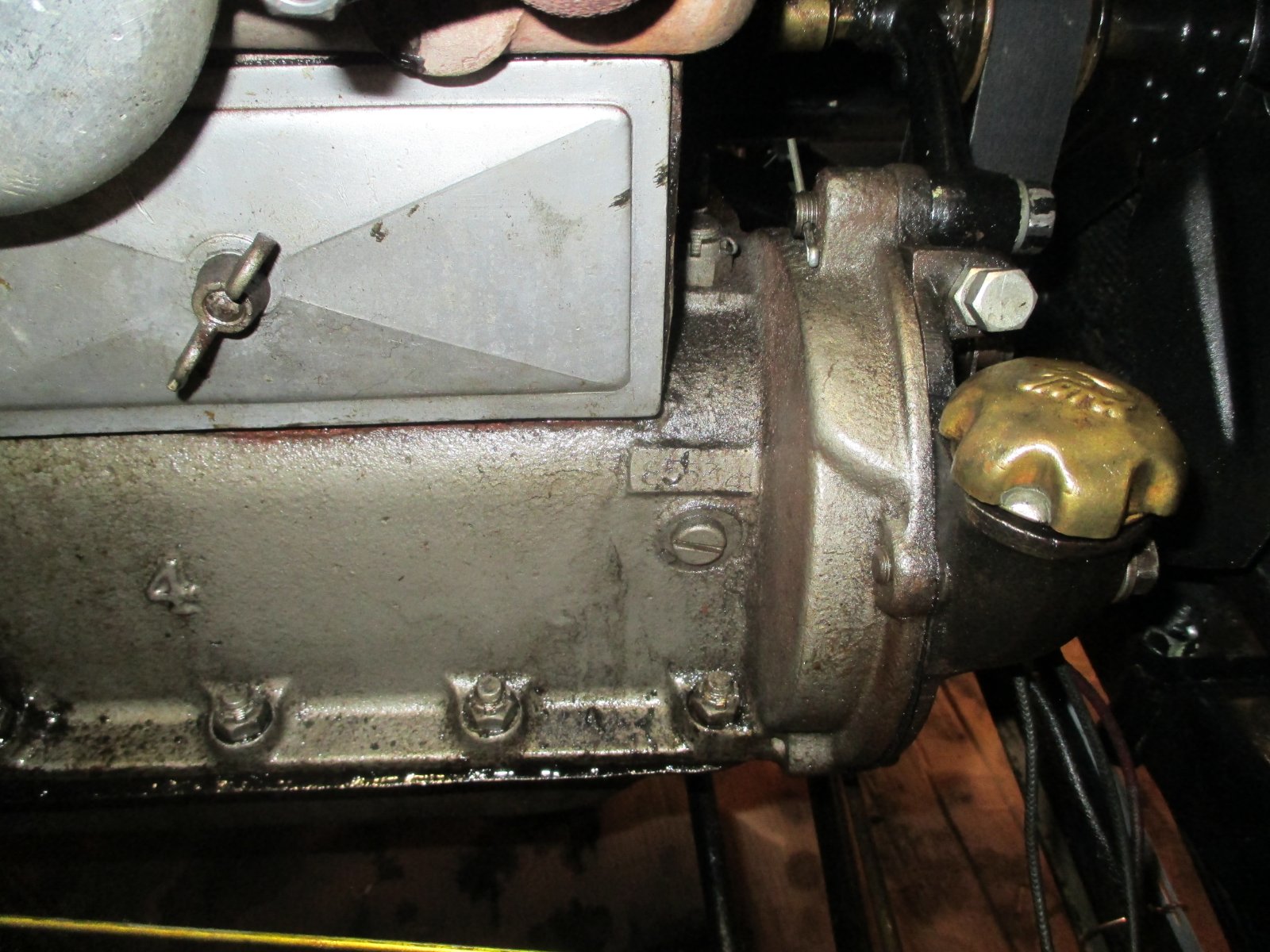

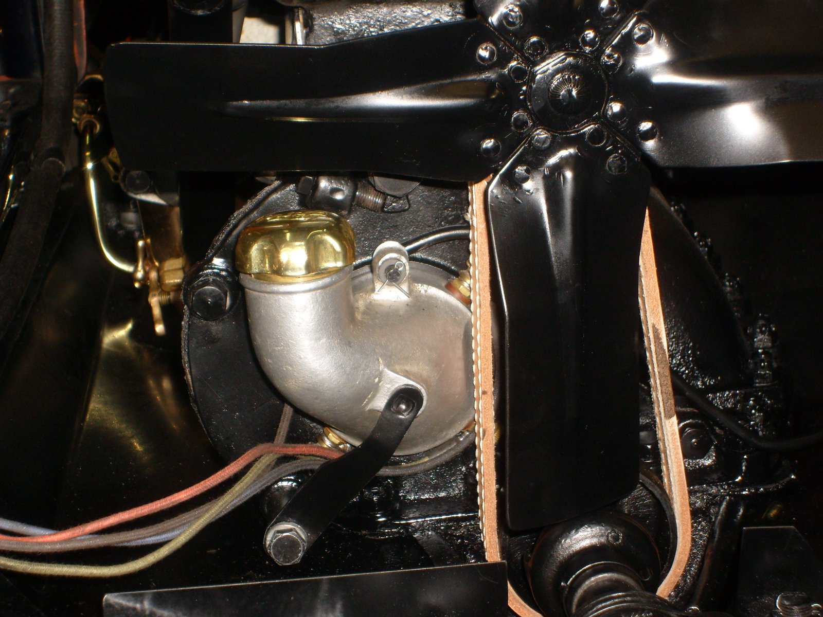

Post by KWTownsend » Sun Sep 15, 2024 3:56 pm
Martynn,

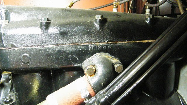

Blocks after about October of 1911 have the 'hump" behind the timing gear that was part of the oil diverter for the ill-fated oil-fill timer.
The timing cover had no spout for the oil filler. It was part of the timer.
1912 oil fill timer and front cover.jpg (68.35 KiB) Viewed 5910 times
Unfortunately, oil would come out of it just as easily as it would go into it!
Keith

Keith T, I have for a long time known of those as a 1912 model feature. However, as many early brass era model Ts and pieces as I have looked at, I can't recall ever seeing one of the timers in person, maybe a couple of the "no filler" timing gear covers at swap meets, or a 1912 model T with the complete setup.
You say used after October 1911, which is arguably early 1912 model, however, do you know how long they were used?
Over the years, I have seen a lot of 1912 model Ts, engines, and bare blocks in person and in photos, but only a few cars, engines, or bare blocks with that hump over the timing gear. So it would seem to me have been a shortly used feature. I would expect that the patterns and mold for the blocks would have been used until they wore out even after the oil-fill timer was discarded as a production item. The regular timing gear cover and timer works just fine on the "humped" blocks.
To me, that whole thing has been a historic curiosity. Any idea how many 1912 model Ts are out there having been properly restored with the oil-fill timer?

Post by KWTownsend » Mon Sep 16, 2024 10:20 am
Wayne,
The photo above is from my friend the late Pete Ratledge. The car he owned (sold to an undisclosed buyer) was made 1059 cars (about a week and a half) before mine. Pete fitted his car with an oil-fill timer and fiddled with it for a long time before taking it off and putting his other timer cover back on. He said it really made a mess. I would be surprised if Ford continued this fiasco very long. I'm sure the complaints came in by the hundreds. Fortunately the standard cover and timer fits fine. Previously, the two-piece brass timer was used. I don't know how long this block style was used. Serial numbers of this era have five digits, but a 'one' is skinny enough to crowd six digits onto the boss. I think they went as high as maybe 105,000 before moving the serial number in 1912 to behind the water inlet, then to standard location of just above the water inlet.
Keith

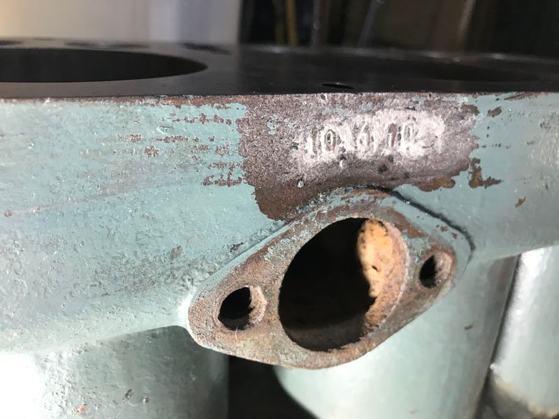

Here is another block cast 11-22-11, and number 93,823(?) (February 1912).
This seems like the "bump" example Keith posted above. The casting date
is over the water inlet.

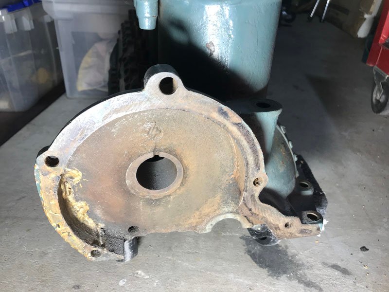

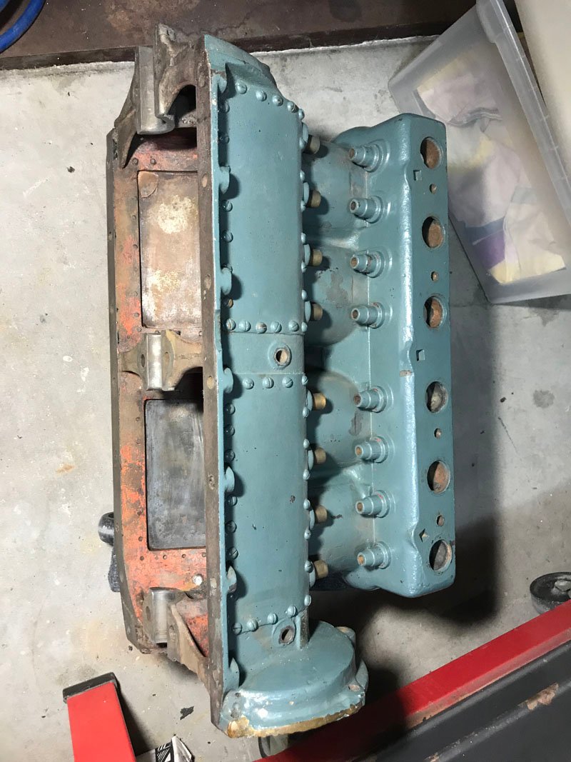

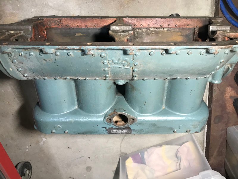

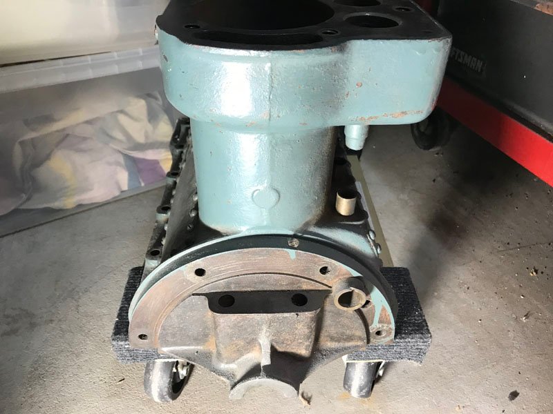

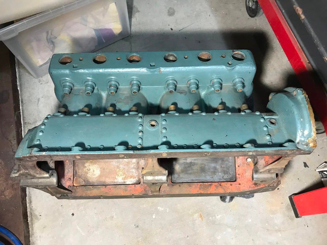

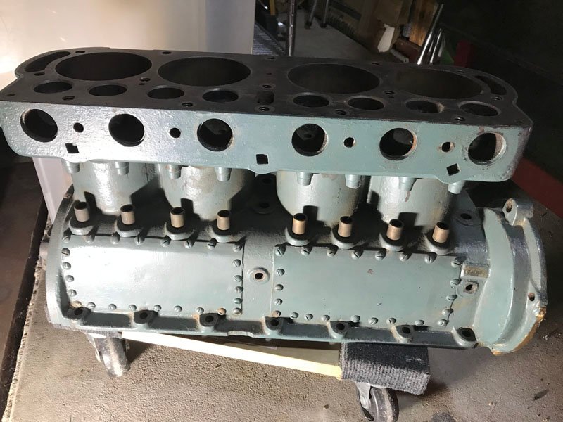

o.k. here are some pictures of the 09 block set up for dealer display. you can see that the side plates are to fill in the machined holes in the side of the block to show the insides of the engine. you will also see that there are 4 screws on the side at the top that were for the hinges for the head. any questions ?

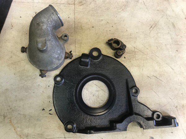

more pictures

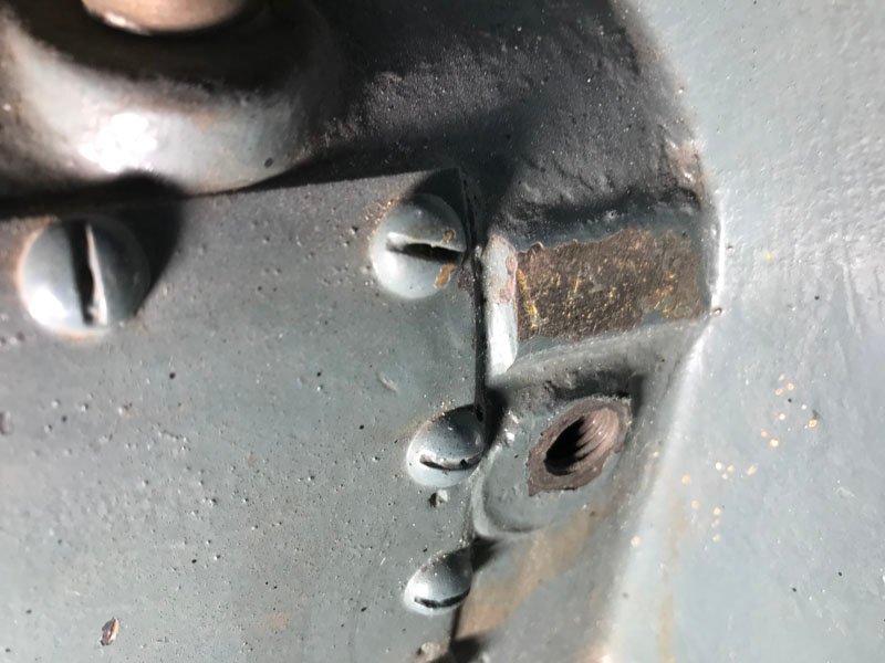

Harold....what are the two holes in the side of the block below the valves for? They've both got a hex looking form on the holes....what either went there or goes there? And is it anything that is actually supposed to be part of the engine?

Post by RajoRacer » Tue Oct 01, 2024 8:11 pm

Steve, the retainer bolts are screws. Okay, did they have a jam nut on them then, because there seems to be a very clear hex left unpainted on the block where these screws would've been?

Re: 1911 Engine Block.....
Post by speedytinc » Thu Oct 03, 2024 8:07 am
Later hex head retainer bolts were in the block when painted....hense, the hex pattern.
There is no room for a jam nut with the correct bolts.

Post by VowellArt » Fri Oct 04, 2024 6:23 pm
Do you have a picture of one of these screws? I'm wondering if they had a step down cut onto them to mate against the Cam Bearing Retainer or not....just curious.

Post by speedytinc » Fri Oct 04, 2024 6:37 pm
Look @ Langs. They have an early type available.
