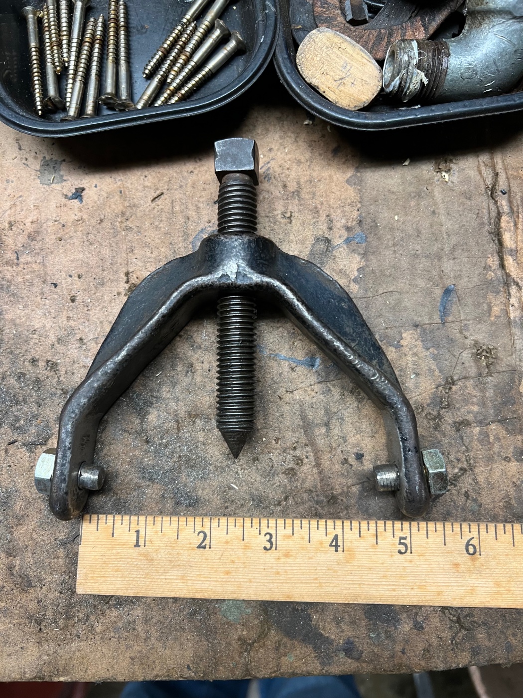

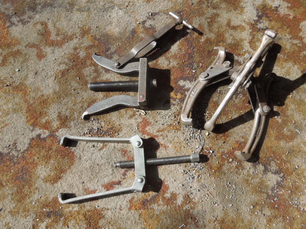

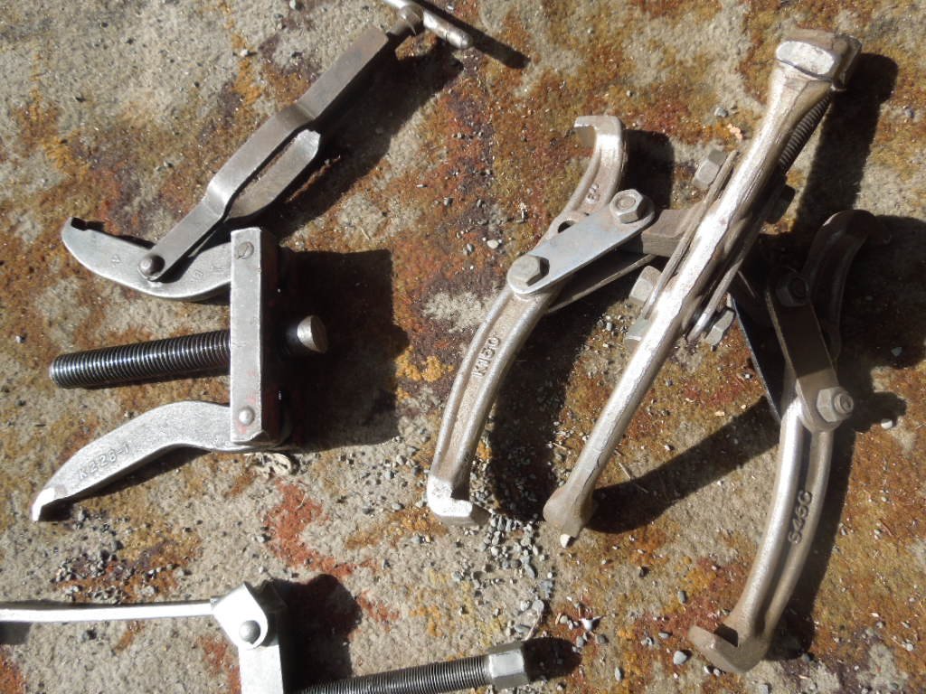

I do have a few pullers, top right is a 6".
I'm going to a swap meet this Saturday so any ideas on what to look out for would be great.

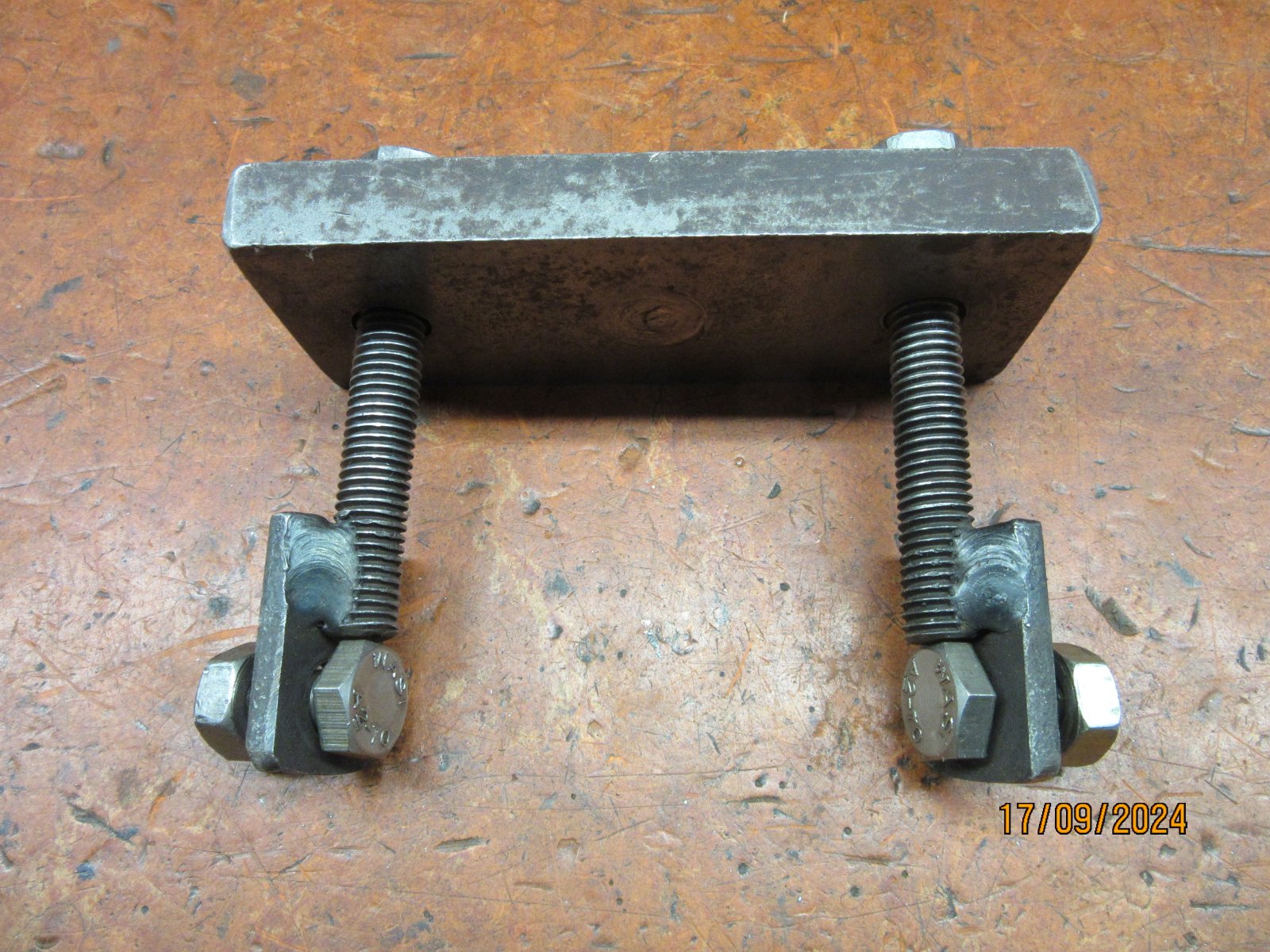

I use this puller , and works good .

Toon - That looks a simple build, What's the distance between the 2 holes in the plate?

Kevin W .
The plate is : 125 x 50 x 12 mm
The holes are 13 mm , and centre to centre 82 mm .
And the two small plates are : 40 x 25 x 6 mm with a 10 mm hole .
I hope this helps you .

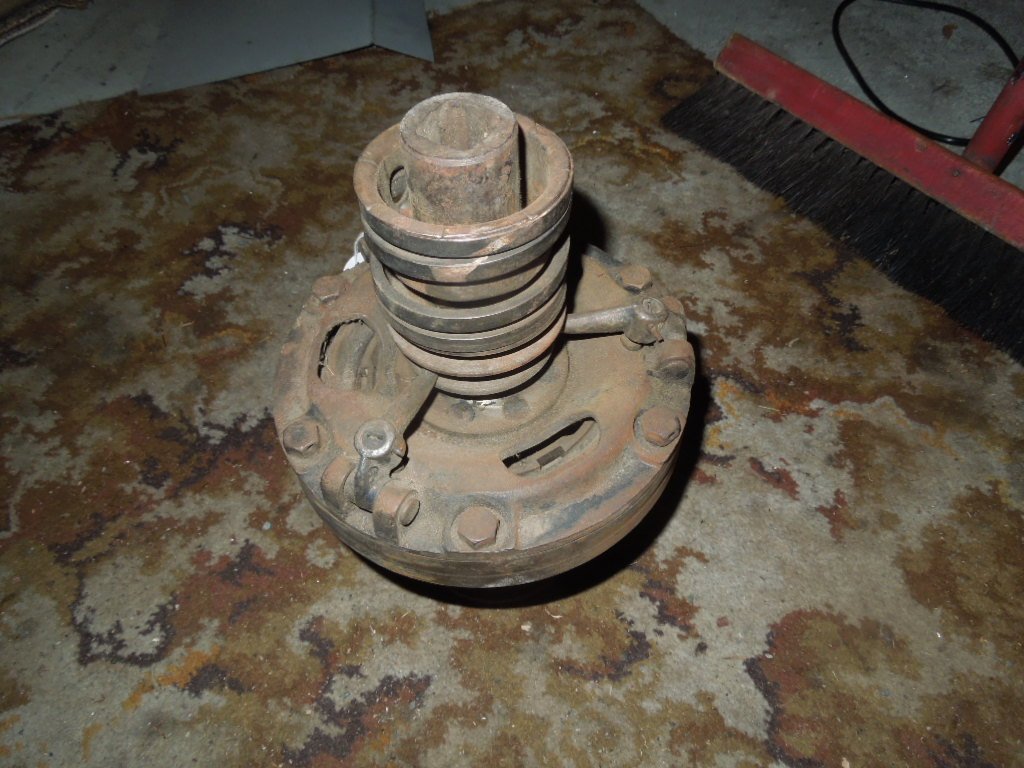

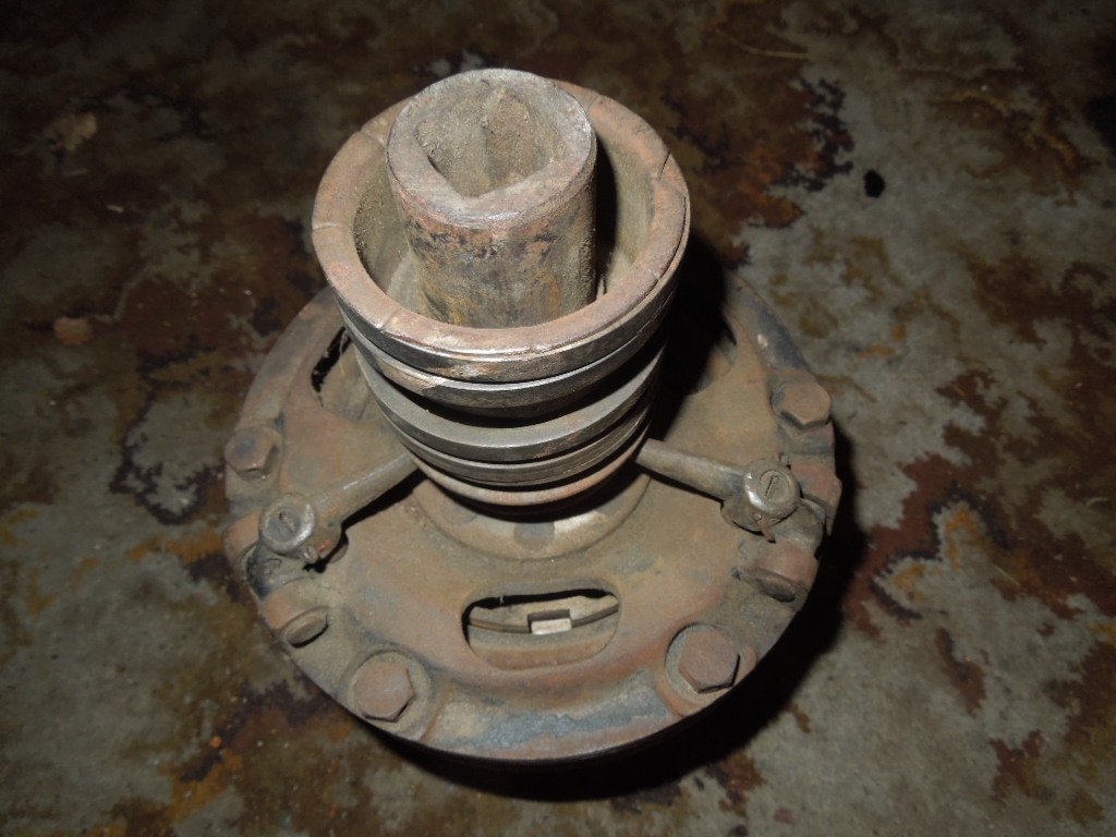

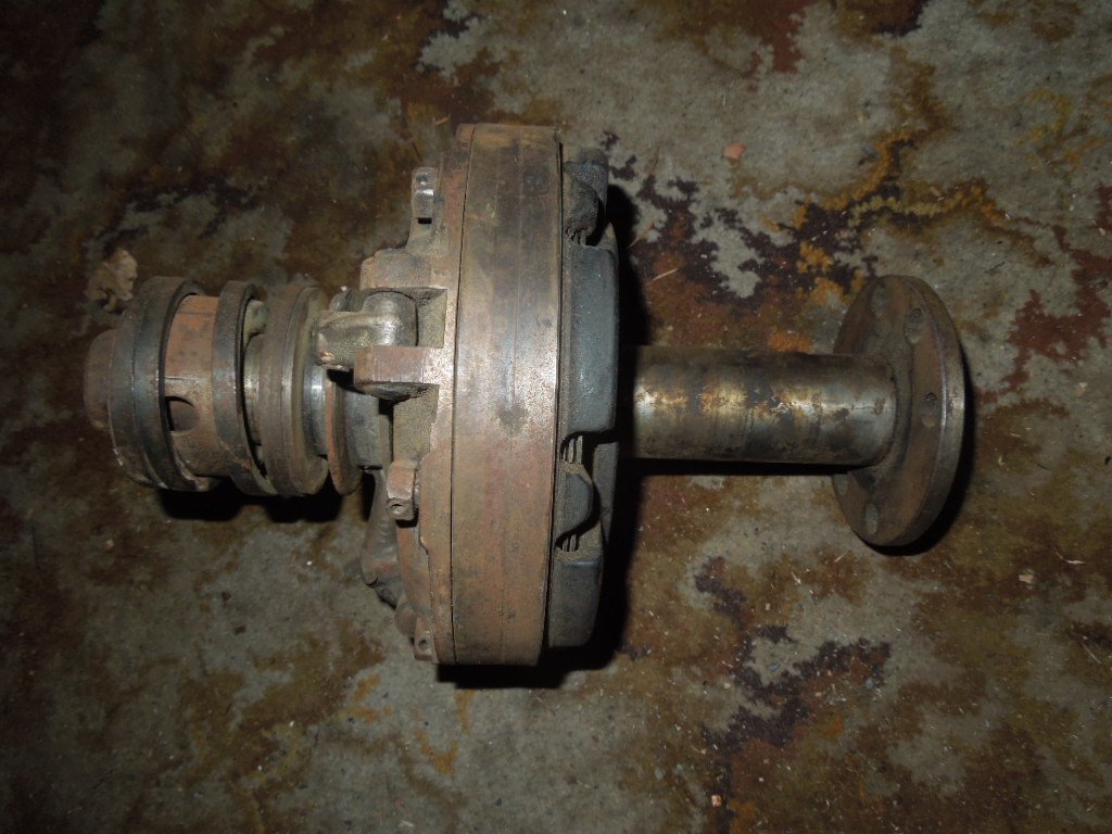

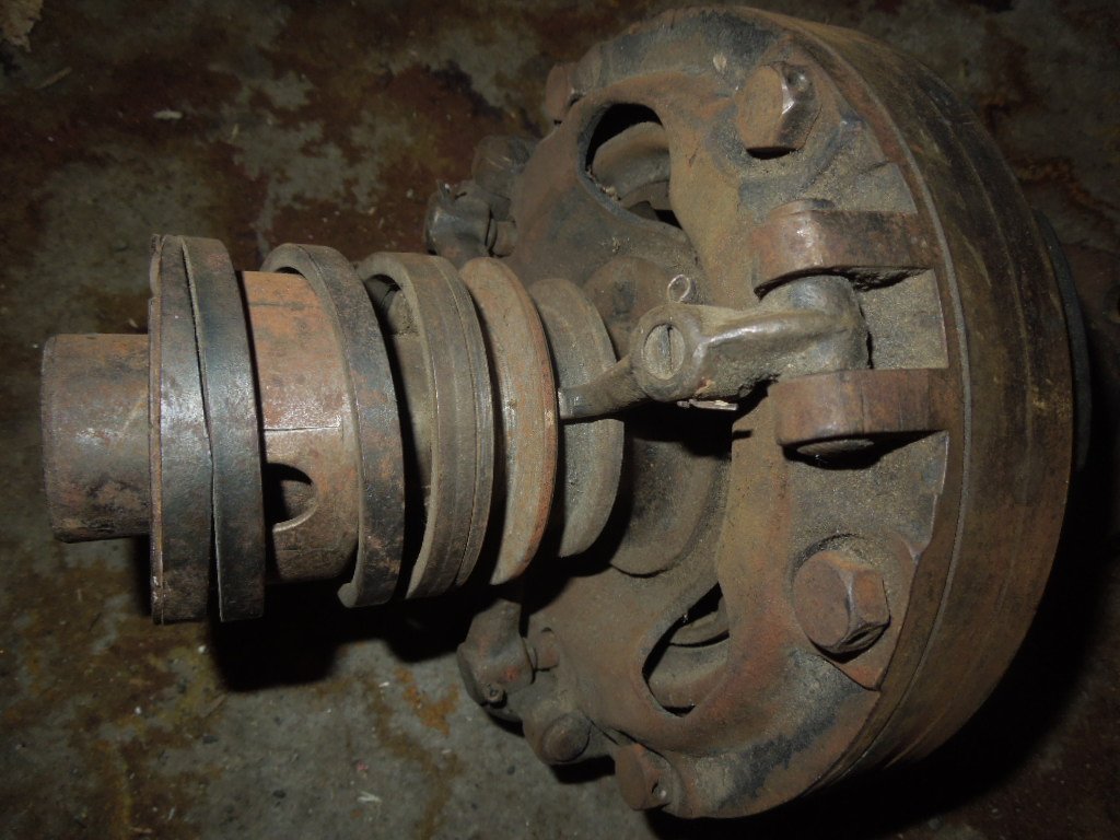

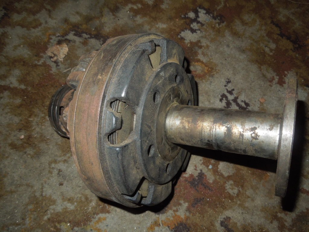

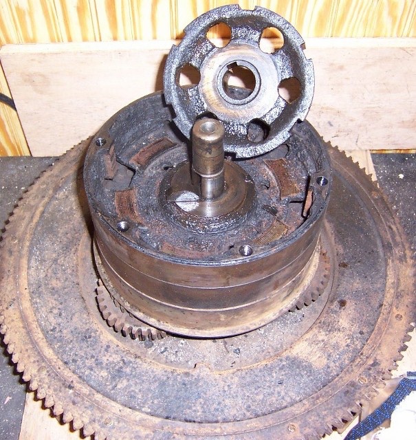

Couldn't find a suitable puller but I bought this today at a swap meet.
I'll pull it apart tomorrow and that might confirm if what I have on hand is suitable for the job.
What years is this set up from?
