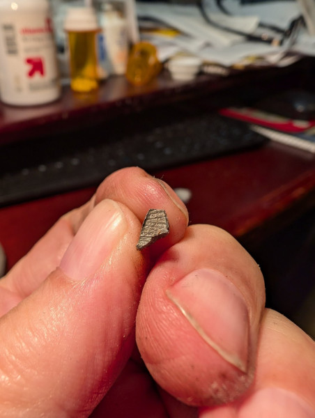

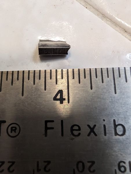

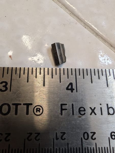

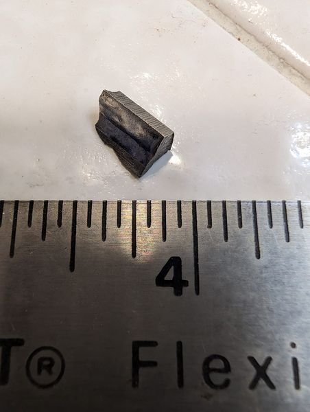

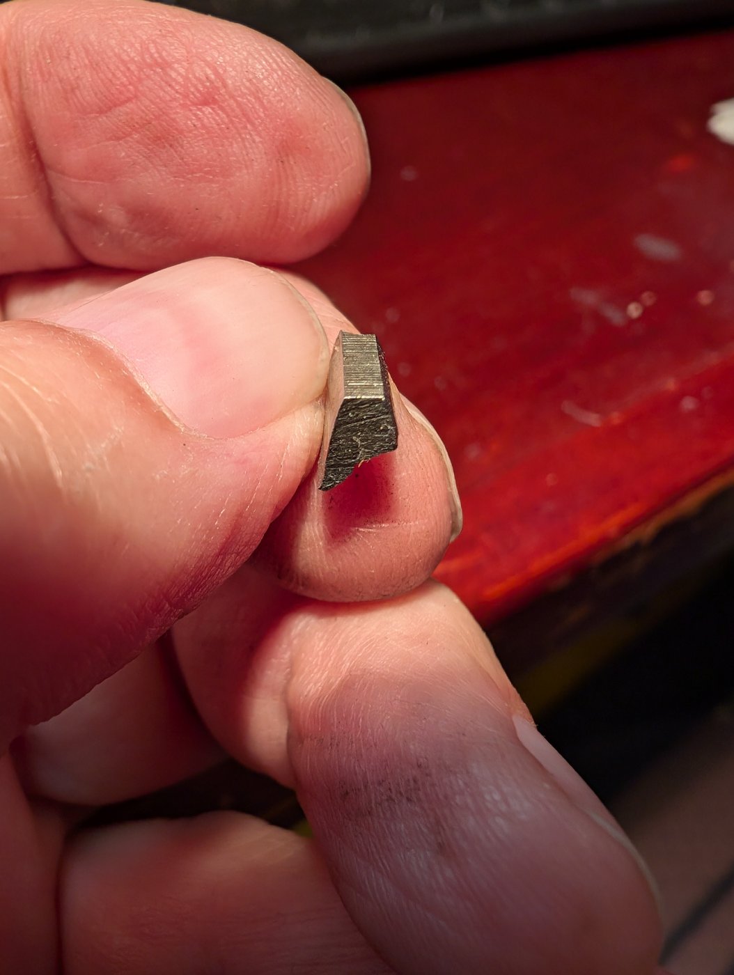

I found this in my transmission screen. I am assuming I am going to have to
pull the engine and repair the tranny.
What gear did it come from?

Re: What part of the tranny did this come from?
Dave, I'm NO expert, but that looks like a lug out of the clutch drum that holds the clutch discs in place. If that is what it really is, there may be more cracked and ready to break as well. Take it real easy on the clutch when you drive it.
I hope a more knowledgeable T person can confirm or deny my assessment.
I'm going to venture to say it is starter bendix tooth.
That is a disc lug from the brake drum.
I jumped in prior to seeing the size - I regress.
Best guess: a tooth off the driven gear or a triple gear.
Viewable thru the inspection cover. May need a mirror or endoscope.
I compared it to a triple gear, the middle gear on a triple gear I think is a match.
Wrong profile for the gears on the drums. The gears on the drum are much wider.
Richard, could I be that lucky?
I agree with John, triple gear tooth from one of the earlier 3 piece gears.

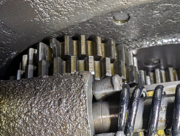

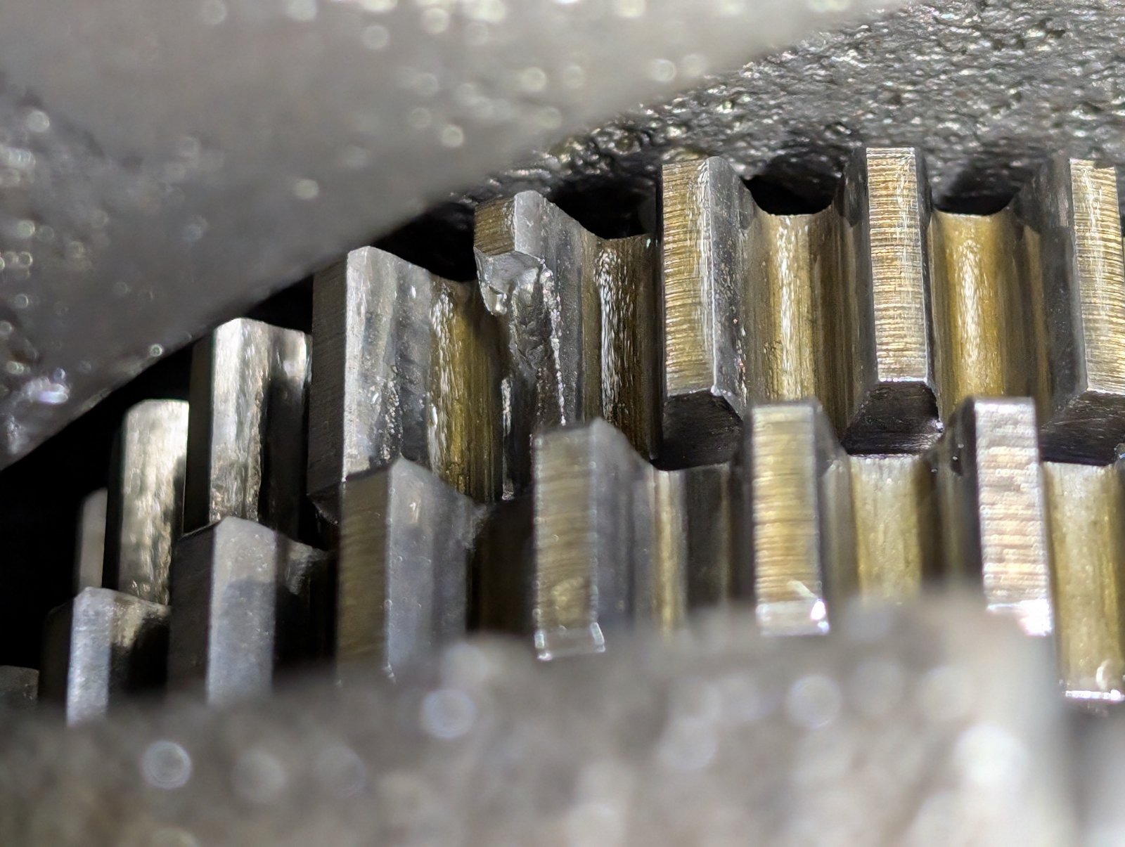

Well well. Would you look at that. Out comes the engine. Good thing I just purchased an engine hoist.

From what I see of those two mating parts, there is something missing.

Looks like you know what you will be doing for a few Fall and Winter months?
An observation. firstly, the missing tooth there doesn't appear to match the tooth you found?
Secondly, there appears to be discoloration on the gear where the tooth broke off. I would speculate that this gear had cracked years ago, the tooth broke off and went through the gears, breaking off another one somewhere?
Doesn't change anything. The engine has to come out, be largely taken apart to remove and completely disassemble the transmission to rebuild it.
Carefully clean everything. Try to do an accounting of teeth and other things to make sure you have all significant pieces removed before final assembly. As I mentioned earlier. broken bits do like to find their way onto the magneto magnets and stay there to shake out sometimes years later. You don't want to have a future day ruined by a revisit by a broken gear tooth!
Looking at the pictures , I can see that the triple gear itself is flaking and should of been changed out for a better example or new ones installed.
Anytime you can see metal being removed from gear tooth itself it's setting itself up for this to happen.
Most likely the low speed/reverse and drive gear are also marginalized from amount of wear.
As others have mentioned a thorough cleaning and inspection is definitely needed.
It appears the broken piece fits exactly to the original gear. Tranny is taken apart and will be inspected. Engine looks fine. All triple gears have evidence that this break might have occurred some time ago. Question is, should all the triple gears be replaced?

I've re-built many T engine/transmissions and dismantled many for parts, I have never come across a triple gear that had broken a piece off.
- Posts: 4404
I rarely trash model T parts. And I like the early style triple gears if they look good. The truth is, that you cannot always tell if a gear has been compromised or not. So any gear you use may have been damaged in this way regardless of how good it looks.
Yes, you should trash all three triple gears as pieces of the broken gear likely ran through them. Closely inspect the drum gears for any signs of damage also.
- Posts: 7259
I agree with Wayne, replace all three gears, from the same set if you can get them. I'd also stick with the earlier 3 piece gears. There wider teeth spread the load better than the later one piece gears with the narrower teeth. Plus your drum shafts have been running the wider gears, so bedding in will likely be less noisy. If you re-bush replacement gears, check that the rivets are tight before installing new bushes.
