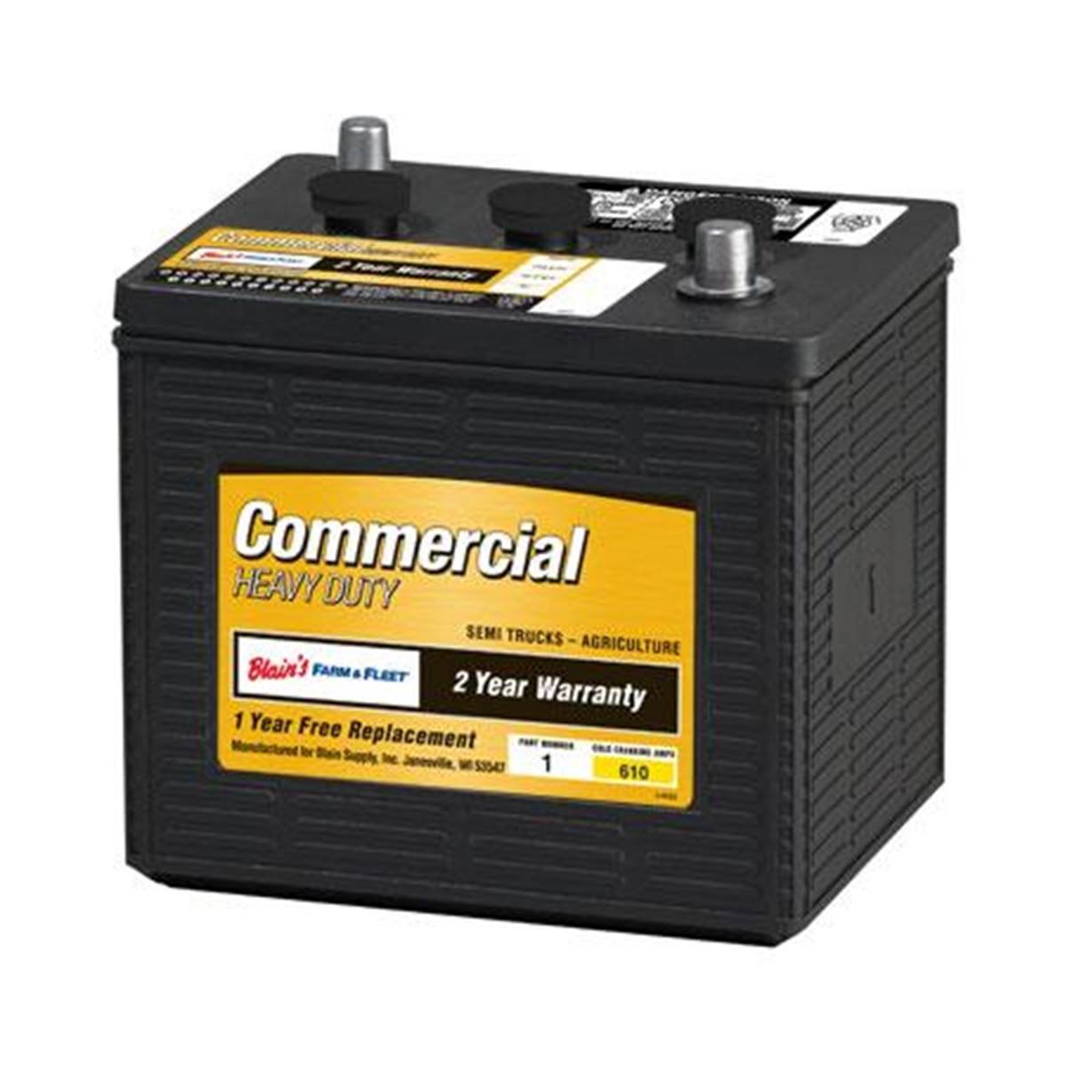

Eckler's used to sell a repro 6 volt FORD battery whose dimensions were 9-1/4" long x 7-3/8" wide x 9" high. Height is measured to Top of posts & 550 cold cranking amps. I some further searching and found that the BCI (Battery Council International) Group Size is 1. This battery size will best fit the physical dimensions, terminal locations and type required for your vehicle. A 19L may be too big to fit in the space available. Check it out
There are many 6 volt batteries available and group sizes, but the first thing to determine is what physical size do you need. While cold crank power is important another factor is charging. There are 6 volt "golf cart" batteries that are designed to withstand deep recharging. I came across some explanation of the common types available. AGM stands out as it is more resistant to vibrations and may be a good choice if you have a voltage regulator.
Flooded lead acid batteries are the most common type of battery you’ll find on the market. They’re versatile in terms of design and use. They come in a number of sizes and aren’t sealed. This means that you can replenish any lost electrolyte. These batteries have lead plates based on sulphuric acid.
Gel lead acid batteries utilize a thickening agent to keep the electrolyte still. It can’t move freely. This is great if you ride rough. If your battery gets cracked, it’ll still run smoothly. The one downside is that it’s completely sealed.
AGM lead acid batteries are relatively new. These batteries use a fiberglass separator to keep the electrolyte in place. AGM batteries are considered to be one of the most robust battery options because they’re spill-proof, resistant to vibrations, and hold up well to impacts.
Posts: 6546
Re: recommendation on 6 volt battery purchase
Post by TRDxB2 » Sun Jun 16, 2019 12:18 am
Just one more thing -- Blain's Farm & Fleet $59.99 after $10 exchange Dimensions:9" X 6-7/8" X 8-3/4" Group Size: 1 Power: 640 CCA
