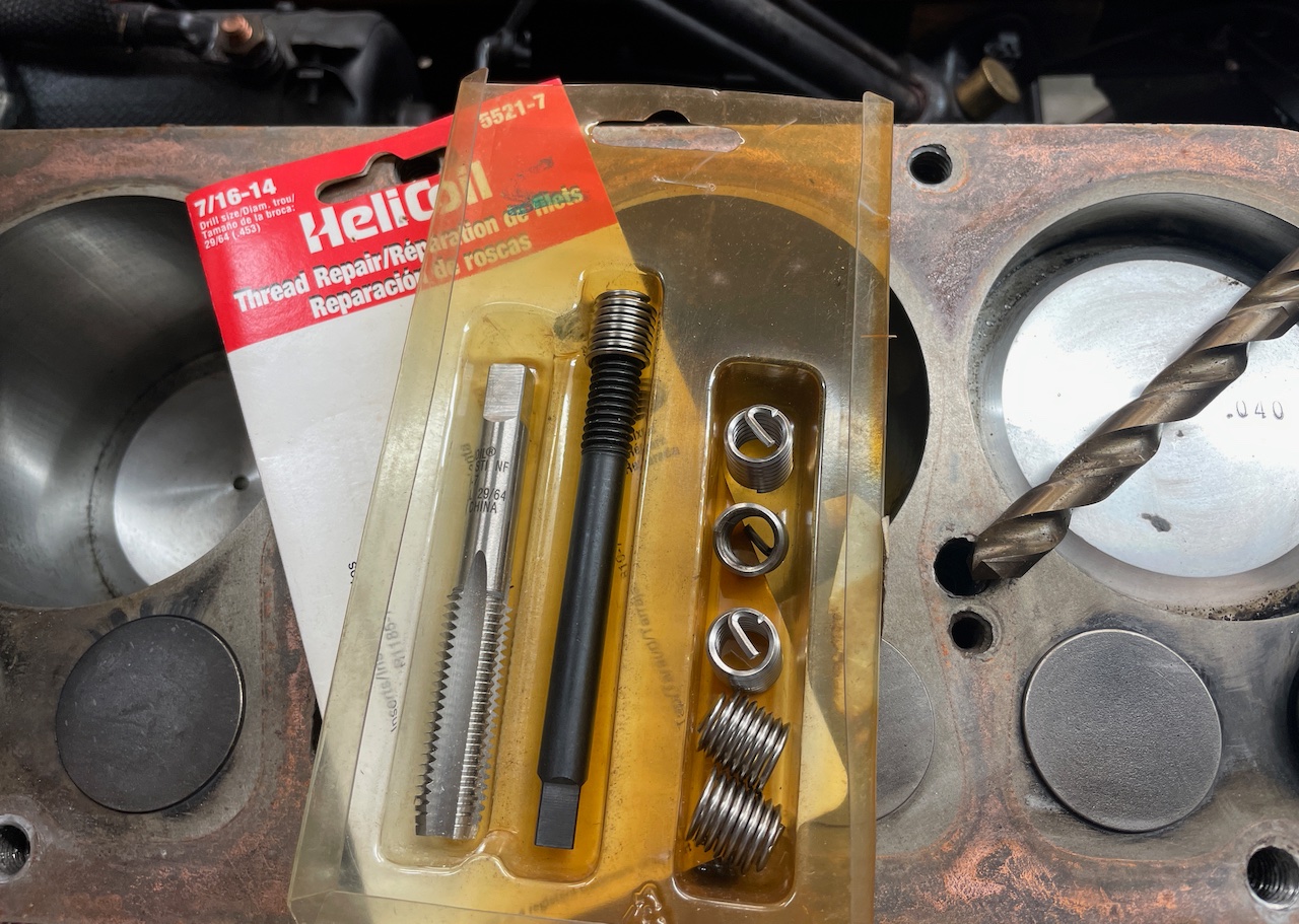

Just stripped a head bolt hole out on my block. What’s the correct heli-coil kit to use?
- Posts: 4053
Re: Head bolt thread repair
This type works well.

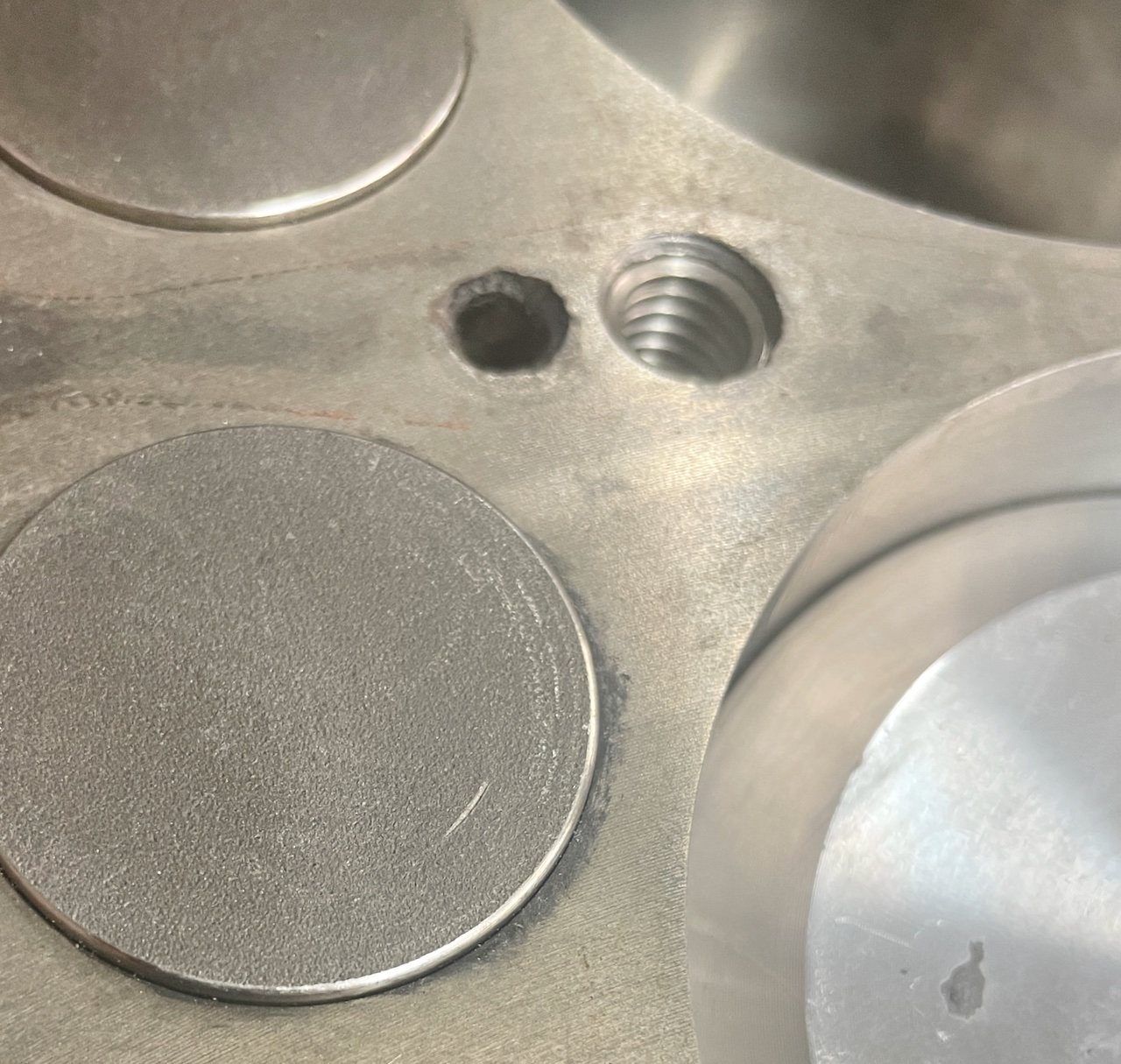

The beauty of key lock/threadloc inserts is you can use standard size taps to fit the insert. There is no need to buy a whole kit to do the job. They also come in different outside diameters that allow fitting to oversized/wallowed holes.

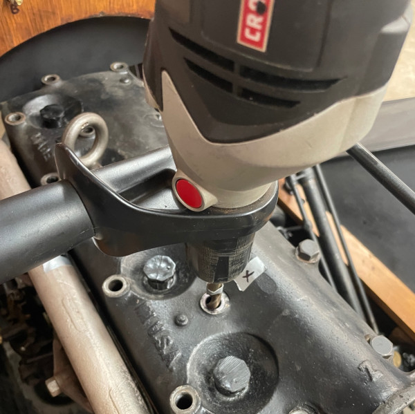

There are a number of types of inserts available. Ive used most. They all worked well. The solid type with pink adhesive is sold locally. I've used the thin wall variety for high heat areas.The key to a good repair is getting a perpendicular to the deck alignment. Not as easy as it sounds. You can use a head to align things. I've used a junk head after enlarging the holes to accept a drill bit. I repaced all threads on an early block on a mill bed once to get square cuts and it came out right. For just a few threads using a head is relatively fast and simple. Im sure the subject has been addressed before.

Drill bit size is 29/64” for the Helicoil tap.
Recently used the cylinder head on my T as drill guide for this drill bit, as Ford cylinder head bolt holes are oversized for clearance of the head bolts, so the drill bit fit just fine. Easy to keep a vertical drill oversize hole in the block. Just measure carefully the depth needed for the insert.

I'm in total agreement with Richard & Dan about using a old head. I keep cracked heads just for that reason. I also drill
the head out to use as a tap guide to be sure I get the threads straight in the hole. My BIL used the Key-Lock inserts in a
engine in the car using a mag drill on several misaligned & inserted head bolt holes. I have a junk low head that
someone tried to wallow out the holes to fit misaligned inserts to no avail.

I rescued an early block which had been modified to take 1/2" head STUDS! I used Keyserts to repair all 15 holes. They come in three different wall thicknesses. They use standard size drills for tapping the holes in which they are to be fitted. They use a standard size tap to cut the threads used to fit them in the holes. An added bonus is the three tangs on the side of the insert, which when driven home, lock the insert in place.
