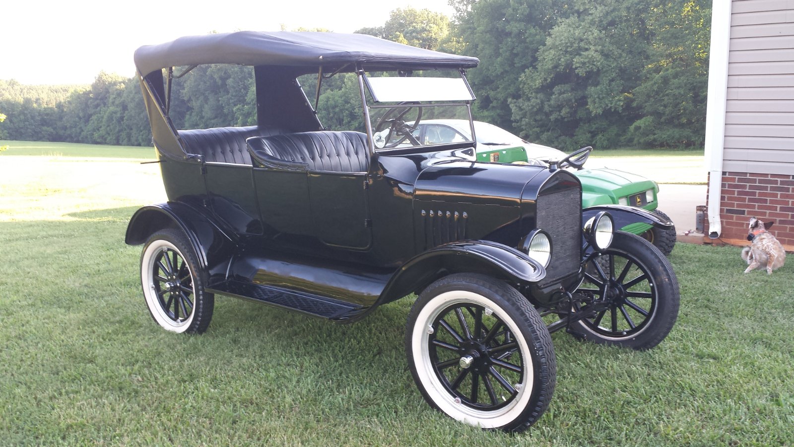

i used classtiques kit for my 24 touring i was very happy with it. i used their top as well.

I absolutely agree with Philip. I have two cars with Classtique's upholstery and tops. Mike the owner, uses original patterns for his kits. Give him a call or go to his website.

At the risk of being too redundant..I also agree with Phillip and Daniel. You want Classtique. I have their products
on my '13 and they are fantastic. Finally got to meet Mike at Homecoming last week. Great guy. A skinny great guy at that!!
And, if by any chance you can swing the extra cost and work out a schedule with Elizabeth, I highly recommend having her at least do the seat backs. Mike can ship you the seat bottoms all done on your springs too. Worth every penny. Just sayin'.
