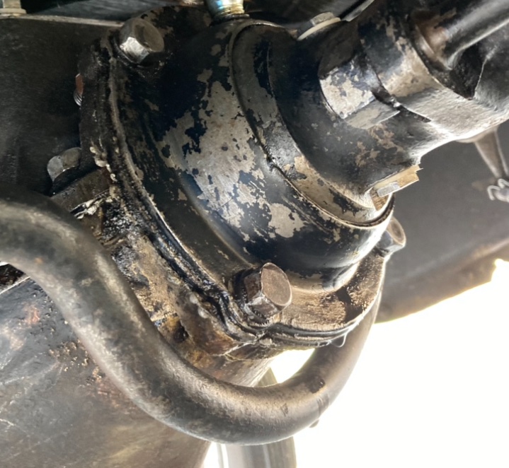

Oil Leak at Ball Cap
I have an oil leak that lets oil out of the driveshaft ball cap. Its hard to see the oil on the cap but it is coming from there and leaking down onto the flange. Otherwise the engine is pretty much leak free. What would be the cause? Can I repair with engine in place?
I know the safety wire is missing but I did check the bolt tightness.

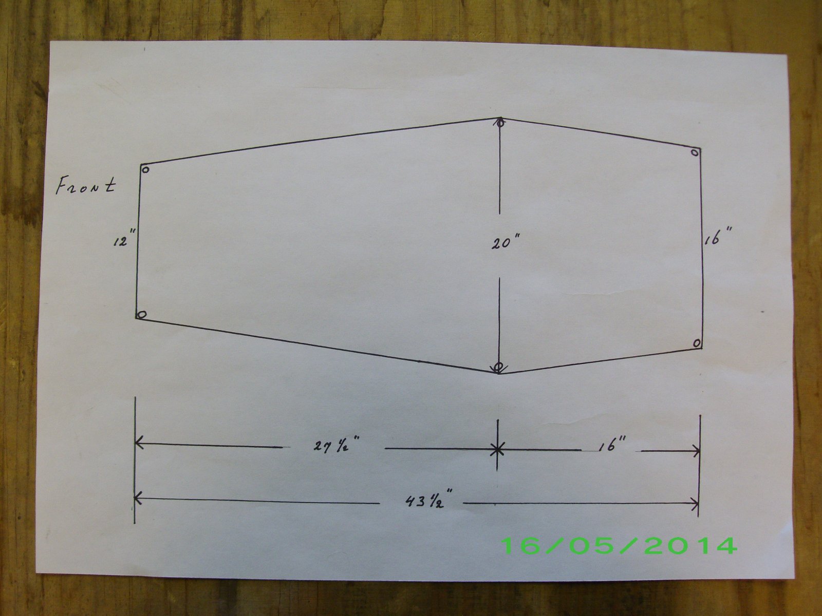

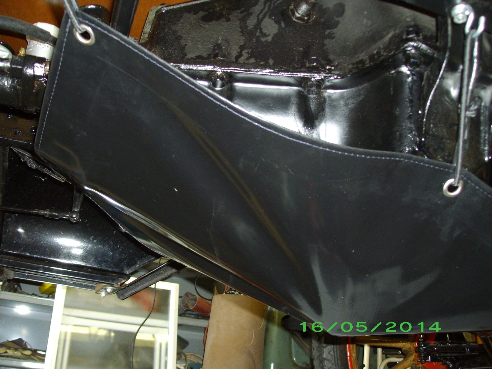

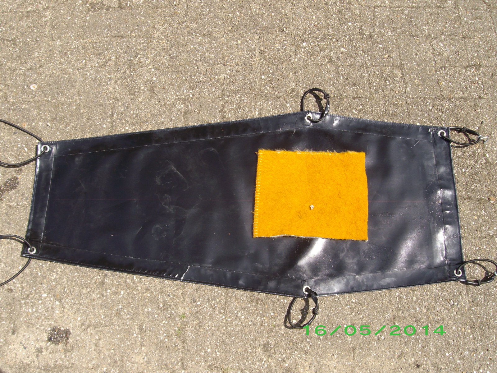

For that oil leak , I use a ]DIAPER ] see pictures .
Toon
Toon

Its hard to see in the photo but oil is poaring out at the white arrow.TRDxB2 wrote: ↑Sun Sep 29, 2024 12:08 ampast discussion

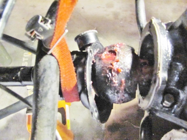

As others replied, the way to subdue oil leaking is to keep the U-Joint ball smack full of grease. Ford put the largest grease cup there for that reason.
Noticed in your photo no grease oozing from the ball cap, that would IMO mean your ball joint is lacking grease.
On assembly the U-joint ball should be completely full of grease.
And when greasing the joint, fill or pump until grease flows from the gap between the cap and ball housing, that shows it's full up.
