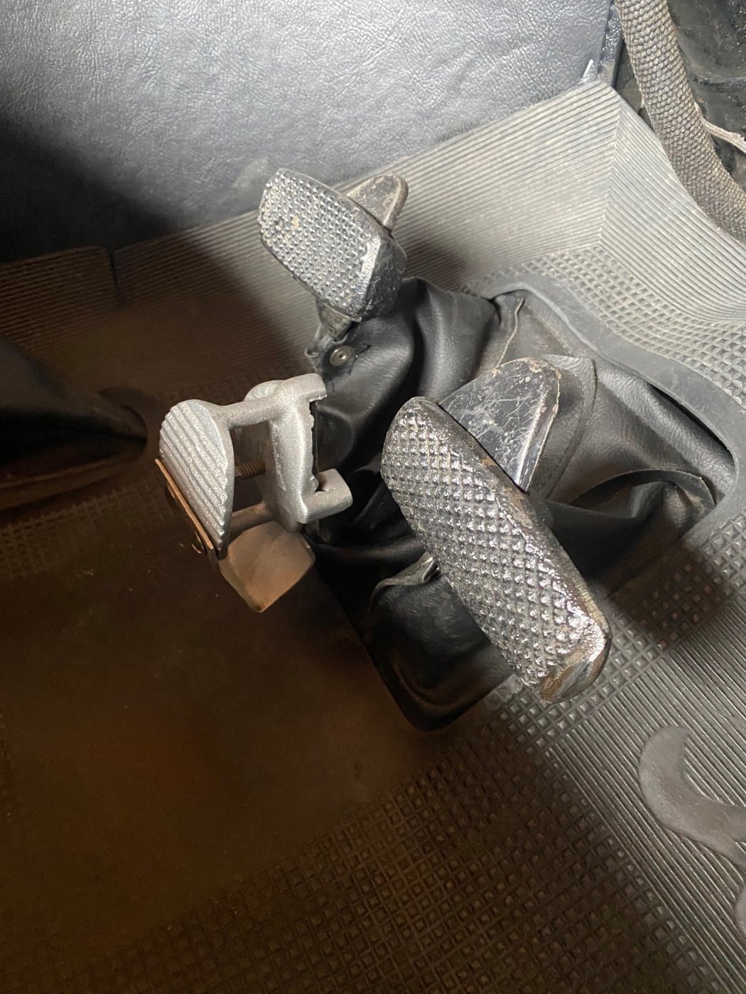

Model T's could use a gear between low and high but you have to deal with what you've got. I accelerate to around 16 mph before shifting - To shift I reduce the throttle fully while releasing the low pedal. I advance the throttle after the clutches are fully engaged. I may experience a moment of stumbling during the transition which smooths out by the time I reach 20 mph.
I have huge feet - 14 extra wide. I use extenders on all pedals.

Ot- Oldavi8tor, I like your pedal grommeting that you have. Did you make it yourself?
