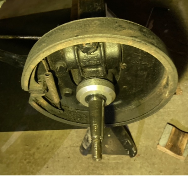

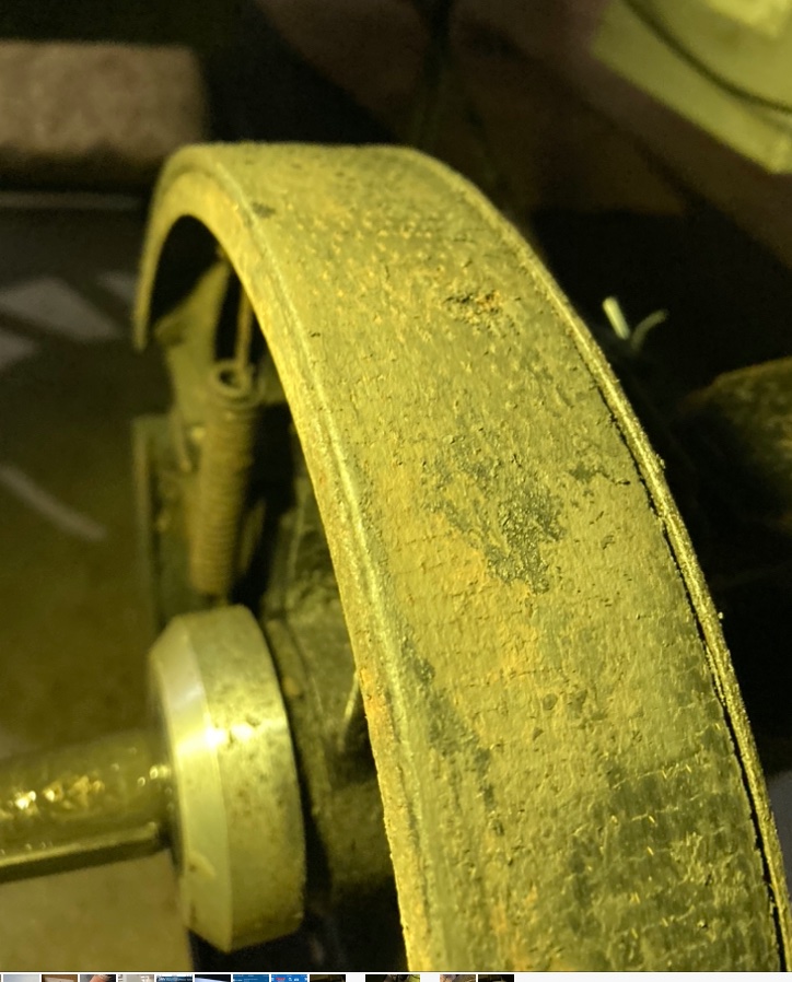

I got the wheel off. I tried turning the wheel but it would only go backwards. I sprayed a little brake fluid in the hub vents and it spun back and forth real easy and came right off the axle. Looks like alot of crud on the shoe could be dragging it down but I need to measure the shoe and compare to the drum to see how close it fits. Might have to sand some high spots off of the shoe after I clean it.

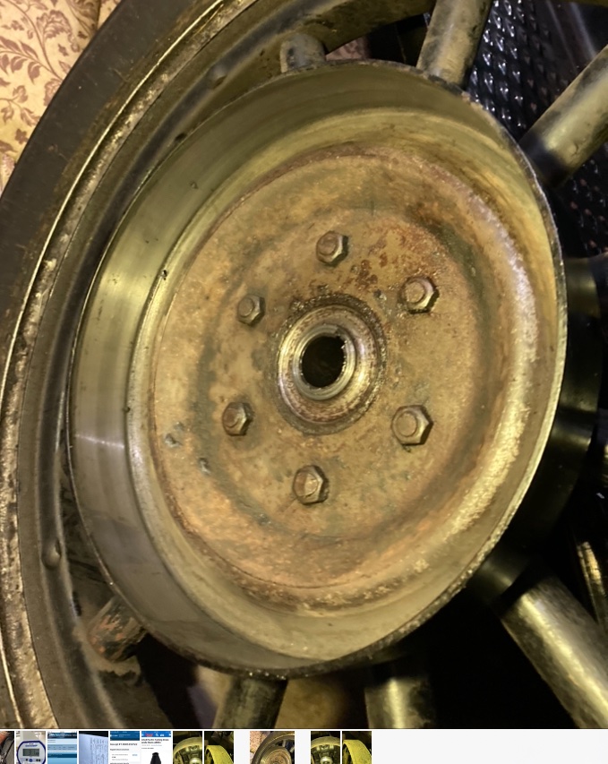

The drum looks good. There is a newer looking seal on the shaft. Alot of crud on the shoes.
