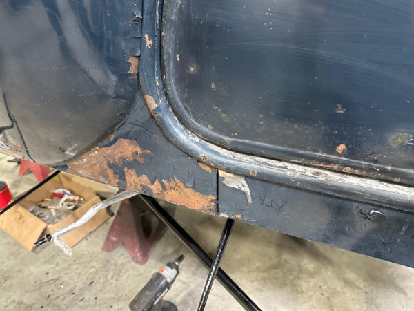

I am restoirng my 14 Runabout and everywhere I look I can only find traces of dark blue paint on the body. There is no indication of it ever being black except the fenders and running boards and aprons. This is an October 14 built car. Is it possible that this car was originally dark blue? I have looked at several old posts and discussion and most agree that only Touring cars built early in 1914 were blue.

Brent, the car has been repainted and I have looked everywhere for black but dont see any. Art

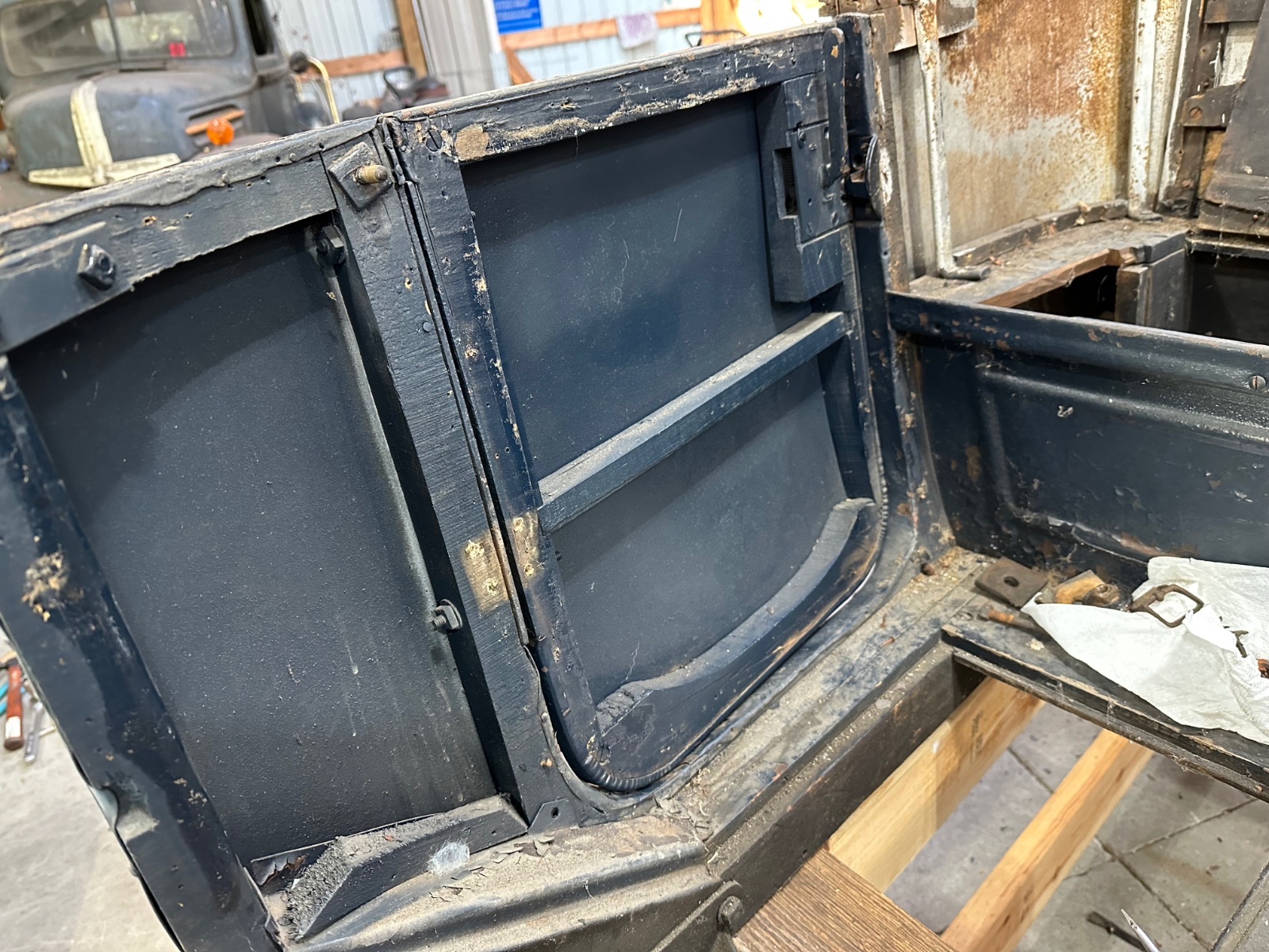

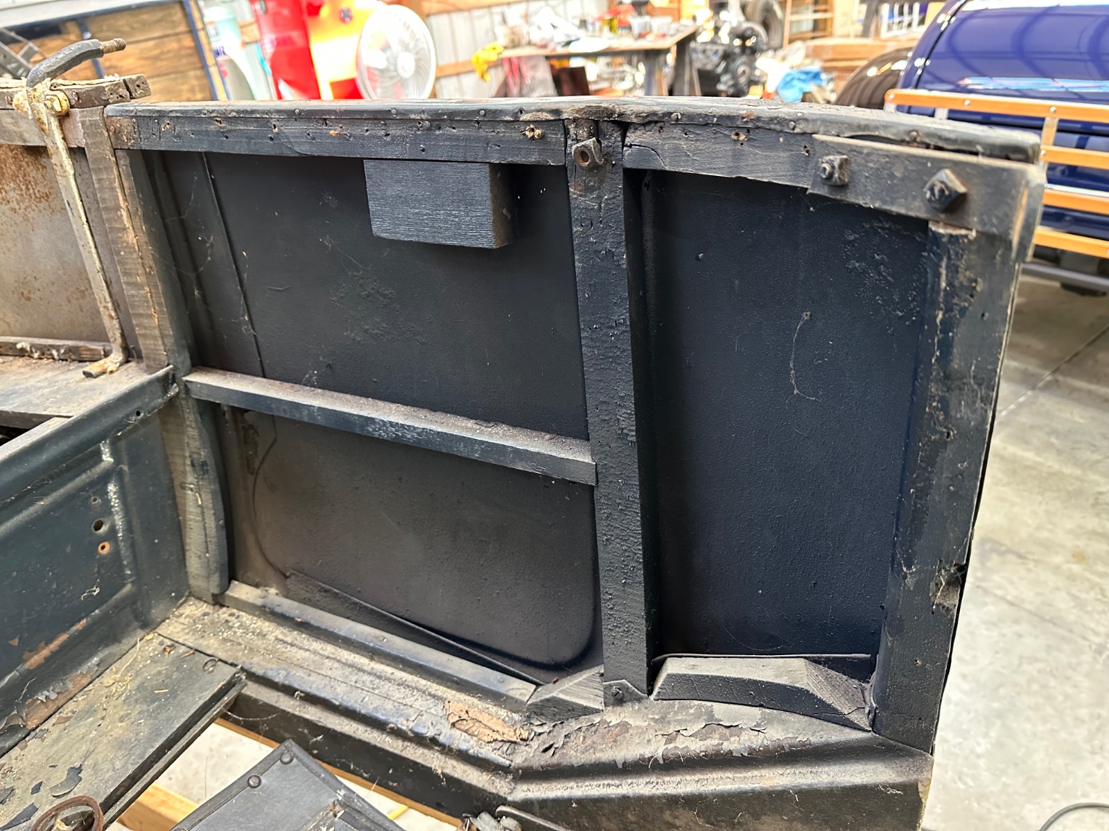

The wood is original and the upholstery did look like it may have been replaced, the seat backrest was made in three pieces, overlapping in the curved sections, as much as I would like it to be blue I will probably paint it black just to be correct. I just find it hard to believe an old repaint would have been do thorough. Art

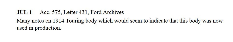

Attached is the July 1, (1913) note from the old Ency.

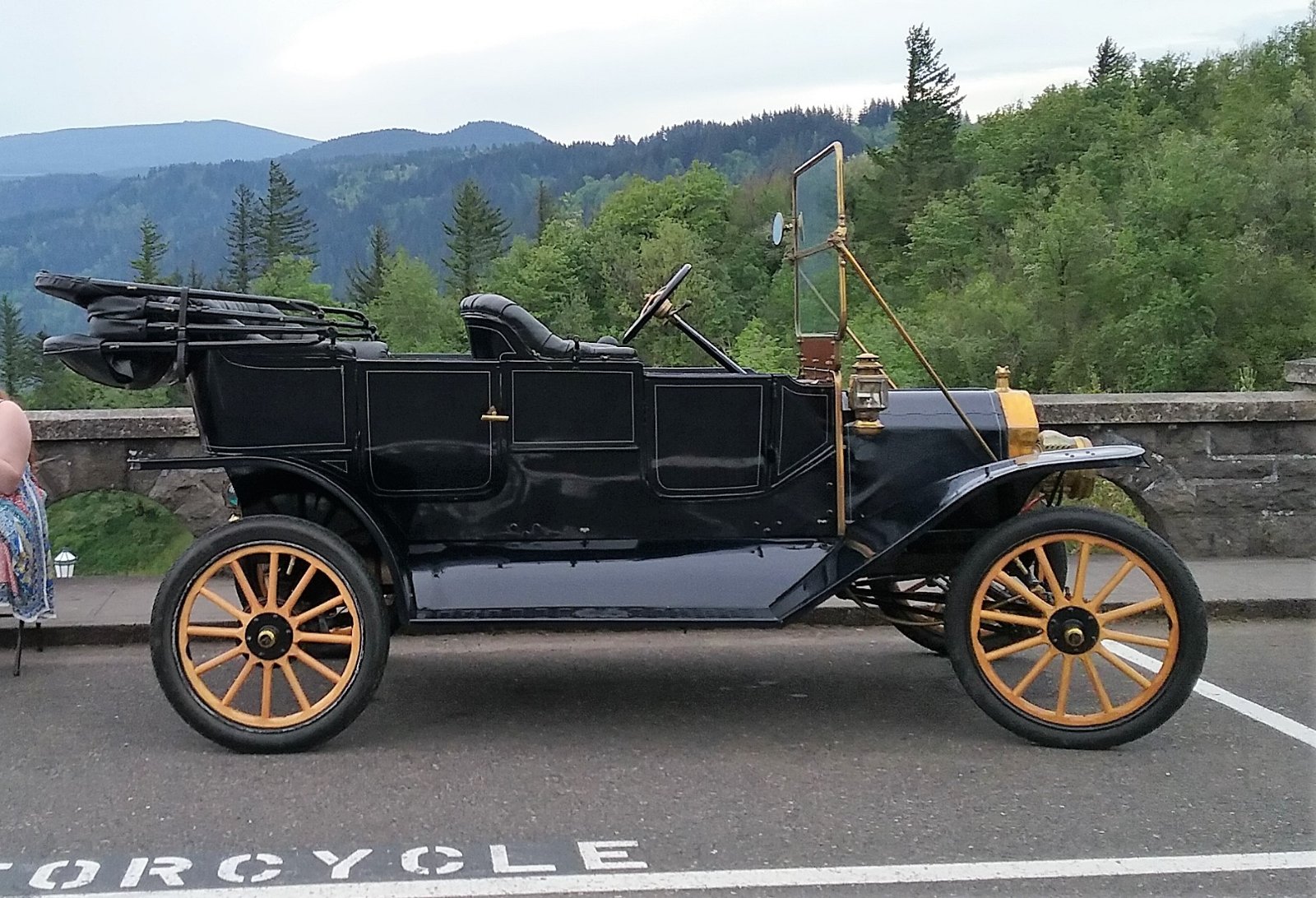

I have a 1914 Touring that was built in October of 1913. There are times I think I see some dark blue in a crack or crevice, but I just thought it could have been from a repaint in the past. Maybe it was blue from the factory...
