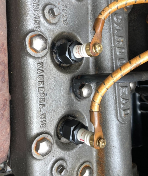

A few weeks ago I went to take a drive in my T and it was running excessively rich from the start, it was barely driveable. I suspected the carb so I ultrasonic cleaned the carb and parts, replaced the needle/seat and float with new, new gaskets, set the float height. I saw some bubbles when I put the old float in hot water and thought that may have been the cause. The needle looked fine. The mixture needle is nice and sharp and everything looks fine in the carb. Appears up to snuff according to the service manual. After getting it all together and starting the engine, it still ran the same, puffing black smoke from the pipe and pumping fuel out of the plugs threads. Number one had a puddle of gas around the plug. I had the mixture needle set out one turn, I tried turning it in with no improvement. There are no signs of bowl leaking, I let the car sit for 5 minutes with the tap on before starting and no leaking was found. I am using the hot air inlet tube. The plugs are new and I spark tested them with the hand crank, all four give a nice big blue spark. The old plugs sparked just fine but werent the correct plugs. Either way it runs excessively rich. Any ideas why it would run so rich? Up until then, the carb was not problematic and untouched. The car had sat for a few weeks while I replaced some leaky transmission and pan, valve cover gaskets.

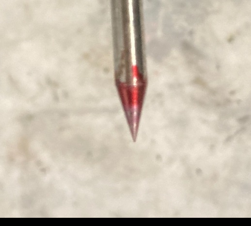

I got the nut to go in more so I ended up with at least one more turn in of the spray needle. I marked up the needle tip and ran it down all of the way to see witness of it closing. Does this look good for a bottomed needle? The picture shows that the first half of the needle bottoms out in the spray nozzle seat.

- Posts: 5018
Re: Engine flooding, running rich, black smoke
Does it run with the needle closed? Is there an adjustable range where you can get the idle to stumble when closed & @ a point when unscrewed several turns?
It runs nice and smooth now, not blowing black smoke as far as I can see in the dark. It idles smooth with the needle 3/4 turn out. If I turn it in any more, it starts to die out. A big improvement over when I first got it. My throttle rod is a little short, I cant get the throttle to close all of the way with the lever so I leaned it out to drop the speed. I tried a bunch of times bending the rod to get it perfect but it needs some bend in it to clear the block center hole, which it was rubbing on for years. I have a rod on backorder. I'll wait till tomorrow to take a run in it before dark. Its all dark backroads where I live.
