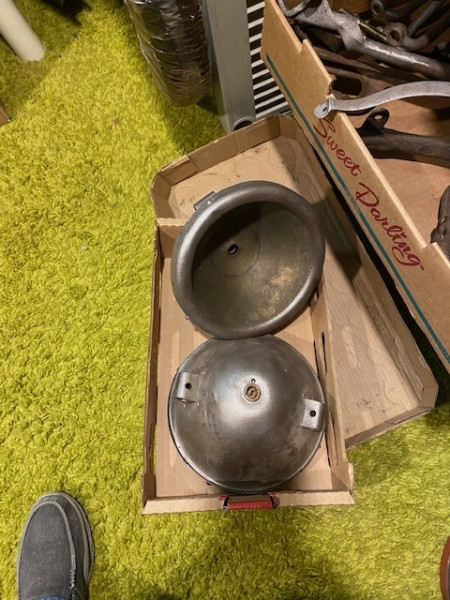

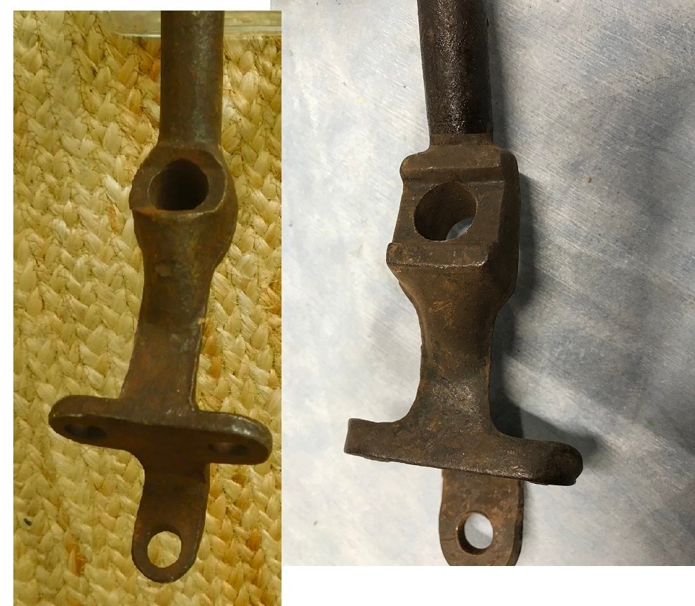

I’m looking for a matching headlight and bracket for my speedster. The one I have (driver’s side) is labeled “1917-1925” that I picked up at a swap meet earlier in the year, and that’s the era I’m sticking too for my speedster. I put an ad in the Foothills T Club looking for a matching set, and I got a photo sent back asking “how about these?”
I came to realize, I actually don’t know! In my head I assumed that the 1917-1925 was one style, interchangeable throughout the years. However, I don’t actually know that to be the case. I’m looking for answers on the different styles of electric headlamps and the corresponding brackets, from 1915-1927 if the forum can help me please.

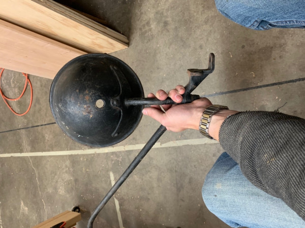

Here is my headlamp
And here is the set I was shown. Clearly different mounting methods, but I don’t know the years for this set.

Very early 1915 . Used the same fork as the gas headlights.

Canadian not US production.

The 2ed photo of light on fender support, that style was used on TT trucks in 1926/27 too. So, 1915 to 1927 would be correct with some changes to the location of the focus screw.

The one on the fender iron looks like it might be one of those center door lights with the bulb socket offset?
Good luck finding a mate and reflectors.

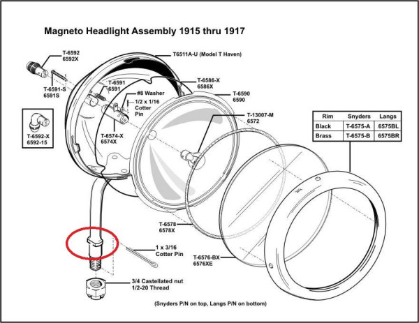

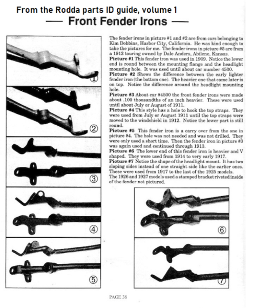

There ends of the headlight posts that bolt to the fender irons are slightly different.

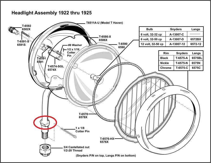

There are several changes to the electric headlights https://www.mtfca.com/encyclo/I-O.htm#lamps
Early 1915 electric used the same U forks of the predecessors

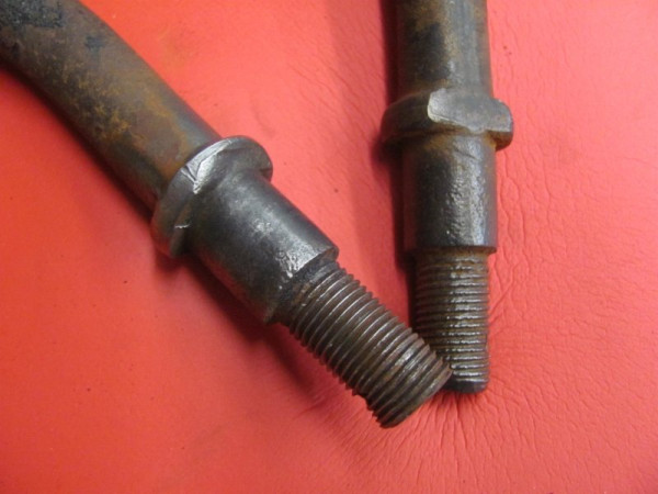

1915-1917 have flat sides at the stop, while 1922-1925 have a tapered stop
Even though the stops are od a different design, I would guess that it would be possible to reshape the later style to have flat sides like the earlier design to fit into the corresponding fender iron. -- --
There are some differences in the buckets as well. some had the adjusting screw at 12 o'clock, then none for the two bulb buckets then at 9 o'clock as explain the link above. Notice too, in the line drawings that there is a lens difference which also means that th clips inside the rims are different to hold the different style glass
While there are slight differences at the base of the fender irons those had nothing to do with attaching the headlights

If it has a riveted on mounting stalk, about the only variations are the shoulders on the threaded end, the focus screw position and one other cosmetic difference. The top of the mounting stalk may be forged directly onto the curved bucket mounting, or there may be a raised collar around the stalk at that point. Most of these minor differences can be fudged to resemble another. It just depends on how anal you are about things being a perfect match.
On a speedster it really doesn't matter, and the differences are hardly noticeable even if left as they are.

Ryan F, The two fork mounted electric headlamps you show in the second photo of your second post above might be Canadian electric headlamps, or maybe likely after-market electric headlamps. If you were in the USA, I would say they were most likely after-market headlamps as literally thousands of such lamps were sold beginning about 1912 to upgrade brass era model Ts to the more modern electric headlamps.
It used to be believed that early 1915 USA built model Ts had fork mounted electric headlamps, however, serious research has never found any evidence of that. Canadian production on the other hand did use fork mounted electric headlamps at least 1915 through most of 1916 and era photographs show even on some 1917 models with fork mounted electric headlamps.
