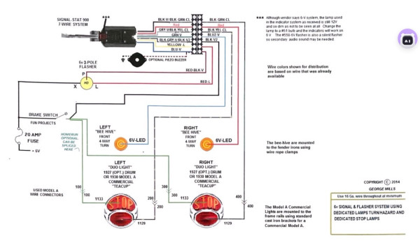

George Mills
- Posts: 644
- Last Name: Mills
Re: How to wire brake light on Sure Stop Disc Brakes.
This is how I did my '19 Hack. It has everything turn/4-way/brake.
Works well, only had issue when I tried full LED all the way around...made some incandescent all is good...
Just take the 100/200/300/400 connector points and make a trailer plug...
