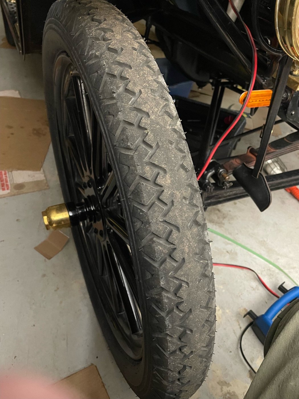

The Wards Riverside tire on the wheel is not as beefy as the Firestone tires. The Firestone's seem to be larger even though the size call out is the same.

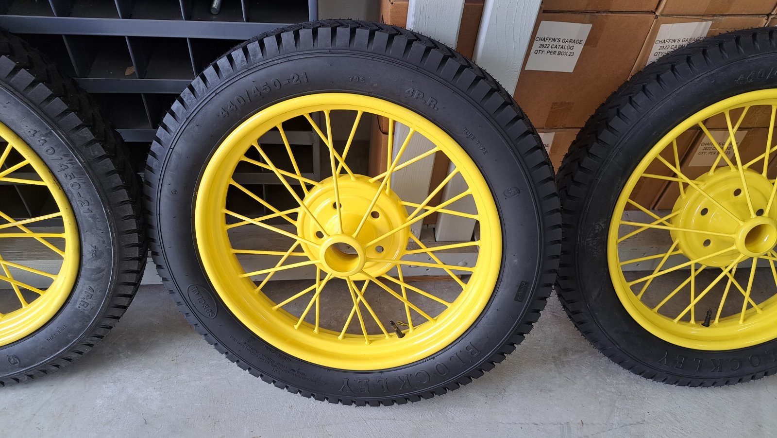

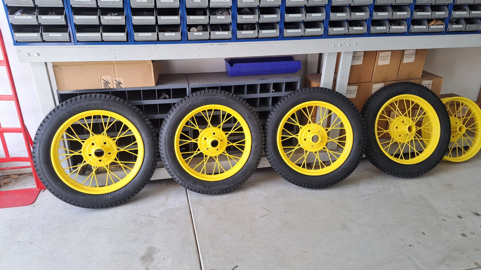

After hearing the hype about Blockley tires, I had to order a set for the Ranch Doodle bug project. With the exchange rate and shipping it was expensive. About $1,600 for five tires, tubes and rim liners (450-21 size). The tires are no doubt better quality. Much thicker sidewall and tread. The tubes much thicker as well. I've mounted many tires over the years. These were much more of a challenge due to their construction. They are also DOT approved! Well worth the money and effort.
