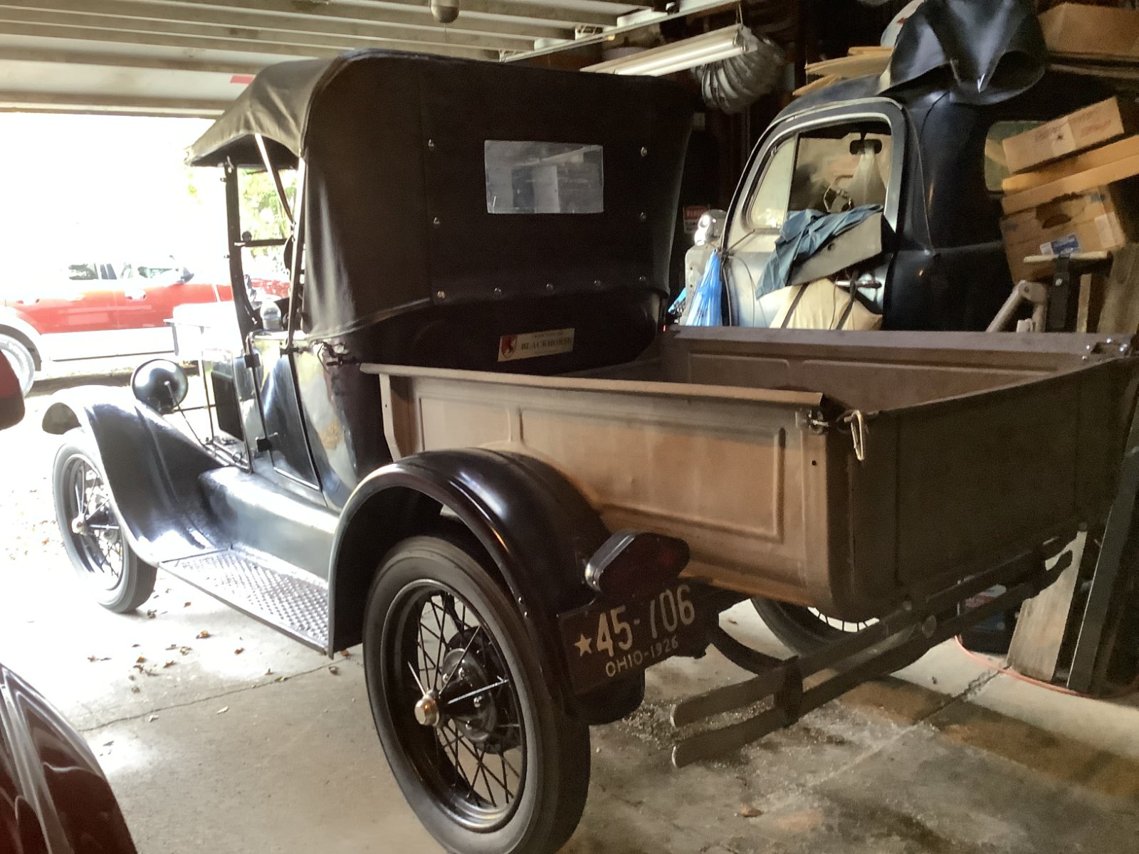

As long as we are discussing these beds I have looked thru a lot of former posts and can't find an answer to my question which is, What style of bolts do I use to mount it both to the frame and to the fenders? The existing holes are round so I don't think they are a carriage style of bolt, I'm thinking maybe some square head bolts would look more period correct than hex. Sorry if this is a hijack. Jim

The bed to body subframe bolts are hex head, fine thread.

Thanks Dan, hex it will be. Jim
