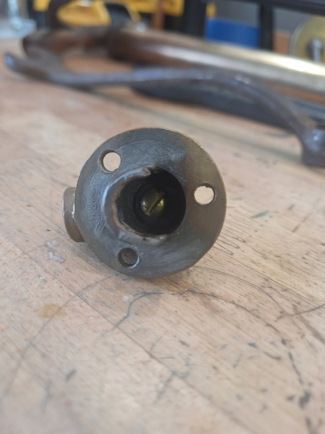

There were questions recently about outside oil lines.
Personally, I use two. One from the transmission cover, and one from the magneto port. ( And a large funnel inside).
Pictured is the authentic part for the magneto oil line.The ones sold by vendors are the 26-27 style with an adapter.
Notice this one has a deflector scoop to guide the oil in.
Just sharing a very hard to find gizmo. (It is the only one I ever found).

That's a nice one in brass.

Thank you Dan. The one in your picture is outside thread, as this one is internal, so there are at least two variations.
Always something new( to me).
