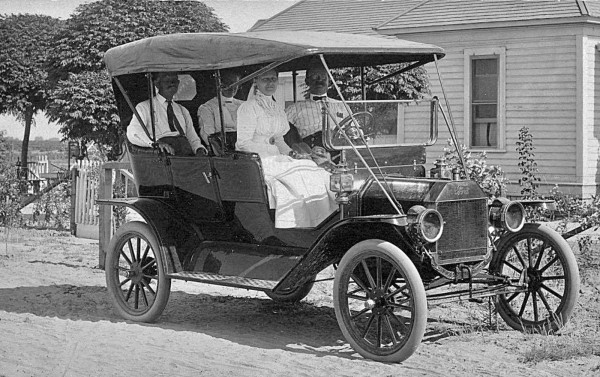

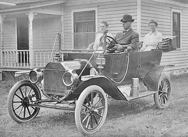

Re: Gas Headlight Orientation
With John Browns from Ford, 1912 - 1914, depended on what two headlamps you got.
Here is a '12 with two JB lefts and another with two JB rights (hinges).
E&J's of this time period were all lamp hinge left.
Since you have a L & R "pair", I like the knurled knobs out on mine so I can close and
secure the lamp away from the radiator (especially on relighting}.

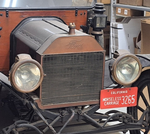

Re: Gas Headlamp Orientation
Early 13' John Brown headlamps. Hinges outboard. Nuts inboard.

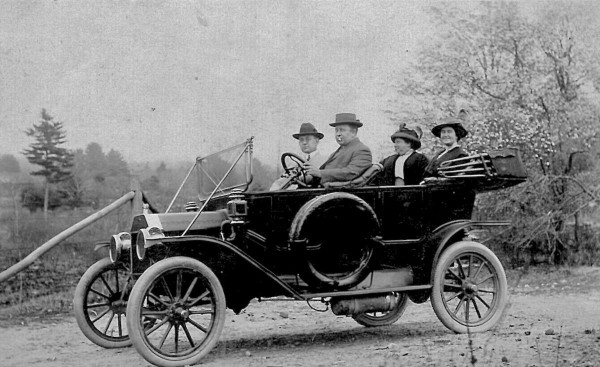

The reason I asked is because I looked at several old photos of original T's and found a wide variety of how the headlamps were mounted. Some hinge inside, some outside, etc. Of course, lamps could have been changed around so who knows. Not sure of the lamps in the attached photo but they have hinges on the left side. Are these E&J or Brown?
Just wondering if there was an "original from the factory" convention. One of those anal details, you know........I do however plan to mount them as per Mark Chaffin's post above, so I guess it is academic. Just curious.
Pic above are John Brown.
Last photo is an example of what seems to happen often,
the headlamps are one supplier and side lamps another.
In this case, the side lamps are E&J.

I spent a moment puzzling over this too. Interesting Mark’s “untouched” ‘13 has lamps with hinges outboard.
Also interesting to learn not all lamp mfgrs. made “pairs”. Not a big thing, I mounted mine hinges inboard as the lenses can touch the fenders the other way.
Do I see light bulbs?Mark Chaffin wrote: ↑Sun Nov 10, 2024 11:39 pmEarly 13' John Brown headlamps. Hinges outboard. Nuts inboard.Screenshot_20241110_203642_Gallery.jpg
- Posts: 3887
- * REQUIRED* Type and Year of Model Ts owned: ‘12 open express,'23 cutoff, '27 touring
Yep, has later reflector so is electrified, did the same on my pair of old, beat up and missing parts Victor lamps.big2bird wrote: ↑Tue Nov 12, 2024 10:41 amDo I see light bulbs?Mark Chaffin wrote: ↑Sun Nov 10, 2024 11:39 pmEarly 13' John Brown headlamps. Hinges outboard. Nuts inboard.Screenshot_20241110_203642_Gallery.jpg
The later Ford reflector fit the bucket, and the later Ford script rims in brass (were nickel plated) fit too by just riveting the hinges and latch parts to the rims.
- Posts: 4360
- Last Name: Chaffin
- Location: Lake Elsinore
Actually, they are original accessory inserts to convert to electric headlights. The gas burners and reflectors remain in place behind the electric bulb and reflector. Neat accessory for sure.
