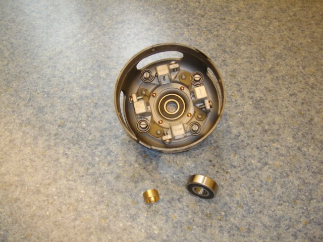

Ron Patterson
Re: 26 T Brass replacement starter front bushing orientation
Post by Ron Patterson » Wed Nov 13, 2024 1:16 pm
The problem with the starter brush cap replacement brass bushing is as Mark pointed out. It needs to be pressed (seated) into the cap stamping AND align reamed which requires some special tools AND it may need to be spot faced (more special tools) to get the armature lengthways oriented correctly inside the case assembly AND when your done you have no way to perodically lube which was the main fault with the original Ford Babbitt bushing.
The pre lubed ball bearing/spacer solution is easy to install, can be easily aligned, is prelubed and will last another 100 years because the duty cycle of the starting motor is relatively low.
Why anyone would waste time with the brass bushing which has a long term problem is beyond me?
Ron Patterson
RecklessKelly
Post by RecklessKelly » Wed Nov 13, 2024 2:12 pm
