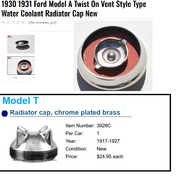

A Model T radiator cap screws on and has the threads on the outside of the cap. A 1930-31 Model A radiator cap is a twist on type
A Moto-Meter is designed to measures water vapor temperature. An A cap's Inner diameter of bottom opening: is 2.44" & the T cap radiator cap has as 2" outside diameter. The system is not pressurized so some method to hold the cap in position may be necessary. Having said all this, Moto-Meter accuracy can be questioned - age etc.
As suggested best to get a thermal sensor HF has one for $29
