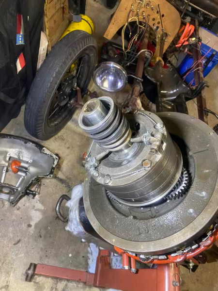

Rough mock up continues. Aux transmission will get a custom bracket and married to an already shortened drive shaft. Lowering steering column angle next priority.

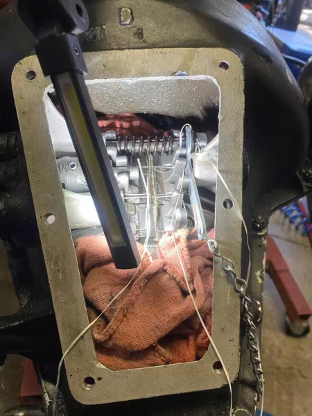

More gears! The speedster will have a Muncie aux transmission. Luke cut, welded, and painted a support bracket.

The spindle arm nut should not be tightened onto the spindle until after the front suspension is assembled. The tie rod's bolts will dictate the position of the arm on spindles. Tightening before final assembly will guarantee binding.

Luke & Alex if you have not planned to put auxiliary brakes on your speedster, I strongly recommend you do so since you are putting in an auxiliary transmission. Using period auxiliary transmissions or rear axles make it imperative to do so. If they jump out of gear or your locked out from shifting into a gear puts you in a bad situation with no real way to stop. I’m enjoying the build & progress keep up the good work.

Great advice. Yes we heard that there is risk of moving and unable to get back into a gear. We have a set of new Rocky Mountain brakes that will get painted and installed.

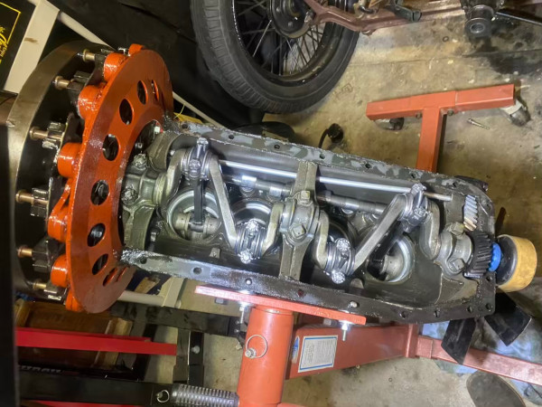

The engine - a ‘13 - will get an aluminum head upgrade. Machine shop cleaned it up before install. New copper head gasket ready too.

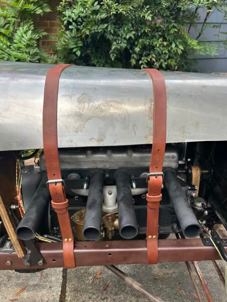

A few random progress pictures.

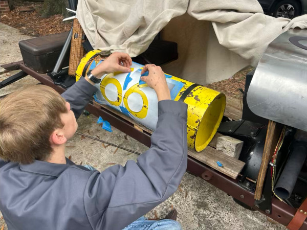

Weekend progress pics

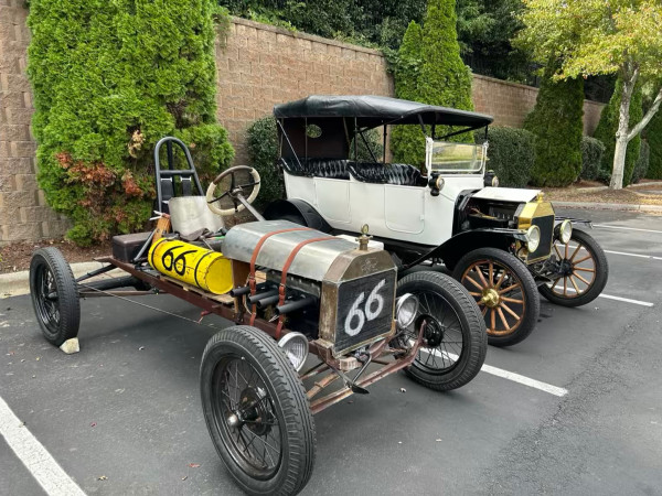

AEyssen
Posts: 43
Joined: Sat Jun 20, 2020 11:27 am
First Name: Alex
Last Name: Eyssen
Location: Charlotte
Re: 1913 Speedster, a 3-Generation Build
Post by AEyssen » Sun Nov 03, 2024 11:15 am

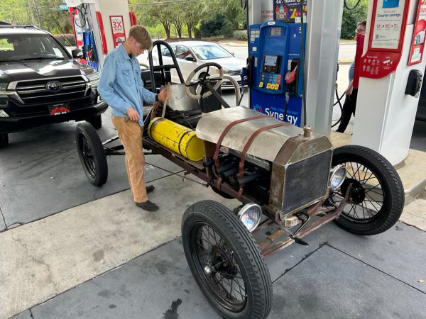

It’s finally a roller. Major components installed. Still planning to “z” the rear frame to align with the drop axle.

Maiden voyage of around 15 miles. Stopped by our local hardware shop where lots of the small hardware pieces were sourced. Then lunch. Ran great.

The speedster has been accepted to The Race of the Gentlemen 2025. The race requires a roll bar so Luke, with the help of a great teacher, was able to make a custom roll bar (75% so far) that will be mounted to the frame rails. It will have a couple gussets & braces, then will be fully tig welded.

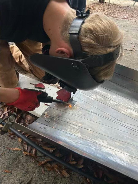

Luke decided to make a half hood. Kinda difficult with only a grinder and without an English wheel. But, it is taking shape. Not sure why the pics are rotated.

Just a couple weeks before two major T events and Luke started feeling a little clutch slippage. So, he single-handedly pulled the engine, dropped the pan, and removed the hogs head. Pulled the fiber Watts clutch out and installed a metal clutch pack and new, stronger spring. Process required he make a clutch spring tool.

Only 1 week before The Race of Gentlemen and two weeks before the Texas T Party. So, crunch time for all the final preps.

Besides the tension of the straps, I'm hoping there is something on the bottom side of the hood to prevent it from sliding backwards, towards the driver.
Very cool BTW. I'm already jealous of the fun you'll have in the race!

Yes, great question. Luke welded some angle iron to the underside that rests against the firewall to prevent the hood sliding back.

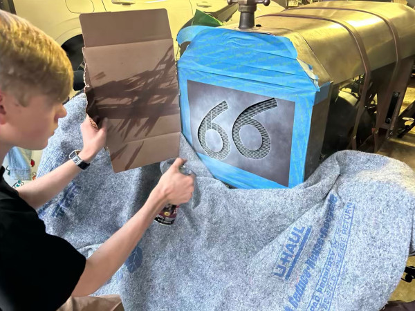

TROG assigned Luke car/racer number 66 so it was time to get the livery painted on.
