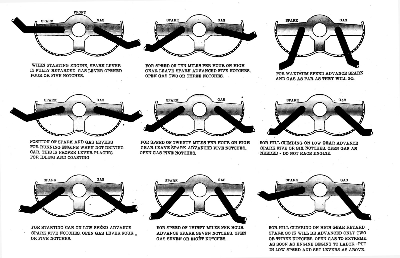

I believe Murray Fahnestock's chart of spark and throttle settings applies only to driving on BAT. On MAG the number of effective spark settings is limited. Are there three, or four?

On mag, you will have 2 or 3 "null spots" within the spark lever's range where magneto output is near or at zero. They are very narrow, with mag output increasing to either side as the lever is moved. Likewise, you'll have 2 or 3 spots where mag output is at the maximum, with decreasing output either side of them. For starting, it's best to put the spark lever close to a maximum mag output point consistent with suitable timing for starting. Experimentation could reveal the maximum output points, or running the engine a little above idle and connecting an AC voltmeter to one of the coil primary wires, then moving the spark lever through its range, ought to give a good idea of where the maximum mag output "hot spots" are located on the spark lever. Every car will be different. On battery, the current supply is constant, so coil output will be very nearly constant throughout the spark lever's range.

If your timer is set to start on battery, the full retard position of the lever is all but useless for magneto operation. As you advance the spark, the first useful current spike happens about 5/8" down from the top. The second (useful) one, about half way through the sweep of the lever, is good for slow speeds in high pedal and for pulling hills if the engine begins to struggle. When the lever is at about 7 o'clock is full advance where it spends most of its time. On my car, you can pull the lever farther, straight down to 6 o'clock, but that is not a useful setting. It's too far advanced and the engine vibrates.
So by my count:
1. Full retard, useless for magneto use.
2. Good for easy starting on mag.
3. Slow driving or heavy going.
4. General driving at road speed.
5. Good for nothing

You unfortunately missed last January's Model T clinic, but there was an excellent ignition presentation by Larry Azevedo. Among other things, he talked about the spark setting when running on MAGNETO and that there is essentially one setting that works the best from idle to cruise speed. I seem to remember him showing data backing that up. I had never really thought about it before, but it made sense because once I adjust the spark setting, I rarely touch it while driving.
I almost always start our 11 set to magneto and hand crank (no starter) and may back off the spark advance a bit for starting, but never to fully retarded. I only retard it if using the battery to tickle the coils.

We live in the mountains so almost everywhere we drive is either uphill or downhill. There are a few relatively flat places. So this is what I have found. I start on battery with the lever all the way up. As soon as it starts, I immediately switch to magneto. The best place for idle on mag is a few notches down. For 25 to 30 mph about half way down and for high speeds up to about 45 mph about 3/4 way down. When I come to a hill I try to go as fast as I can as I approach the hill and then it will usually go up in high gear with the spark about half way down. If I get behind another car going slower, I have to shift down or it will lug the engine. In low or Ruckstell I can advance the spark a bit. When I go down hill, I push the gas all the way up but leave the spark at least half way down otherwise it will pop and possibly blow off the muffler. There is one place I need to drive from time to time which is a divided highway with high speed limits. I approach at the closest ramp to the bridge and take the right lane and go as fast as the car will go for about 400' across a bridge and then take the closest ramp off. Fortunately there are ramps at both ends of the bridge so don't have to go that fast for long! Only other route would be a long way around through the mountains.
