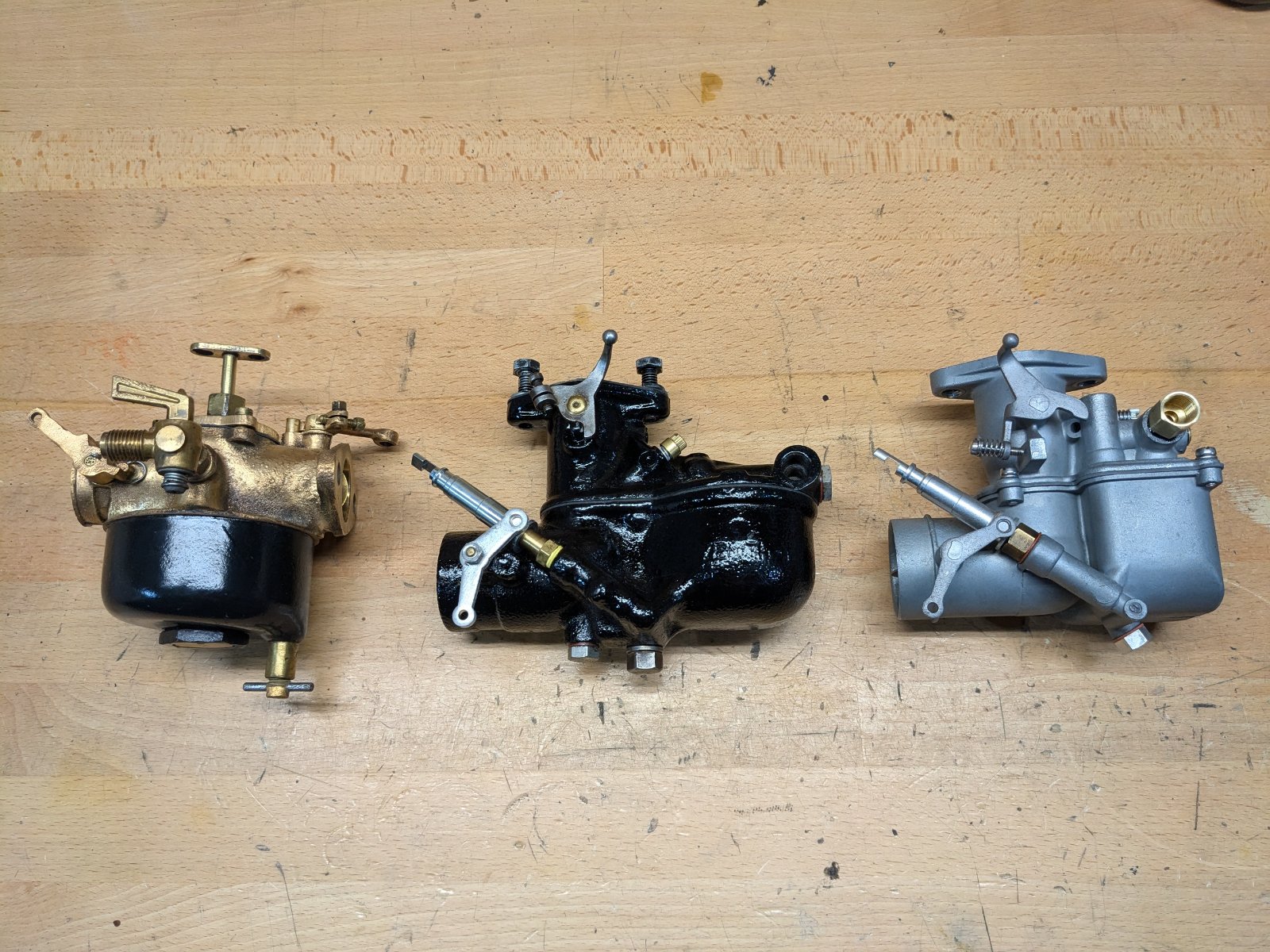

This past week I finished rebuilding one of the Marvel carburetors and took a picture of it next to a rebuilt Holley G Model T carburetor and rebuilt Zenith Model A carburetor (shown below). The Holley G is considered by many to be one of the best early Model T carburetors (and I happened to have one on hand), so it is shown for this comparison. The Zenith carburetor was a major improvement in carburetor technology over the Model T carburetors, and a bit more complicated. Even so, they are very easy to work on. They do have 4 jets to handle both idling and higher RPM/power conditions. They have a float and needle like a Model T carburetor and yes, they can overflow too if something gets under the needle! The Model A at least has a fuel shutoff under the dash which is much more convenient than having to crawl under a T or opening the hood of a T if the car has a shutoff installed at the carburetor. The diagonal cylinder on the two A carburetors is where the mixture and choke lever attach. On the bottom of the Zenith you can see a large head of a bolt. That is the single bolt that holds the two halves of the carb together. That was Henry's input to the design. It originally had multiple bolts and he told them to simplify it.
The Marvel carb is a little simpler than the Zenith, with only 2 jets. It is an "emulsion tube" carburetor with a more complicated main jet. The float hinge is oriented so that the float is sideways instead of facing forward in the Zenith design, and that supposedly helps prevent the sloshing in the bowl from a sudden start and stop. The Ford Model B Zenith carb's float was similarly arranged. The biggest drawback of the Marvel design is that it uses an aluminum body, which is easy to strip out the threads. I had to put a threaded insert in the inlet attach flange on this carb. I have not yet tried the Marvel carb on the Model A, but "according to the internet", a lot of Model A owners consider it the best carb for the Model A. You would hope so since it was designed in the 1930s when even more was known about carburetor design. I have seen an airflow test comparing the Marvel to the Model A carburetors and it definitely flowed more air at partial throttle settings than the stock carburetors. At full throttle, they were all about the same as you would expect with all having the same throat diameter.

My comments on the Zenith carburetor.
Harold Hicks at Ford was tasked with producing 40 horsepower out of the A Engine. He found the Zenith carburetor capable of this. Henry did encourage the designers to cut complexity to the point of having only one bolt secure the bowl. Tillotson was an aftermarket offering that was never offered on the Model A from Ford. Other manufacturers were enlisted to produce the Zenith so a -1 or -2 was added to the bowl to identify makers since the carbs were identical. The Zenith-3 is the carburetor on my ‘31 Ford. It has a different inlet with a side bowl strainer/ sediment bulb with a drain. And my fuel shut off is under the hood because Ford changed the firewall and relocated the gas shut off in 1931.

You are correct. My mistake on the Tillotson. Again, "according to the internet", it seems at least that some of the A owners don't care for the Tillotson carb. The Zenith on our A seems to work well, but it also has calibrated jets from Renners and other new parts.TMiller6 wrote: ↑Sat Nov 23, 2024 9:48 amTillotson was an aftermarket offering that was never offered on the Model A from Ford. Other manufacturers were enlisted to produce the Zenith so a -1 or -2 was added to the bowl to identify makers since the carbs were identical. The Zenith-3 is the carburetor on my ‘31 Ford. It has a different inlet with a side bowl strainer/ sediment bulb with a drain. And my fuel shut off is under the hood because Ford changed the firewall and relocated the gas shut off in 1931.
