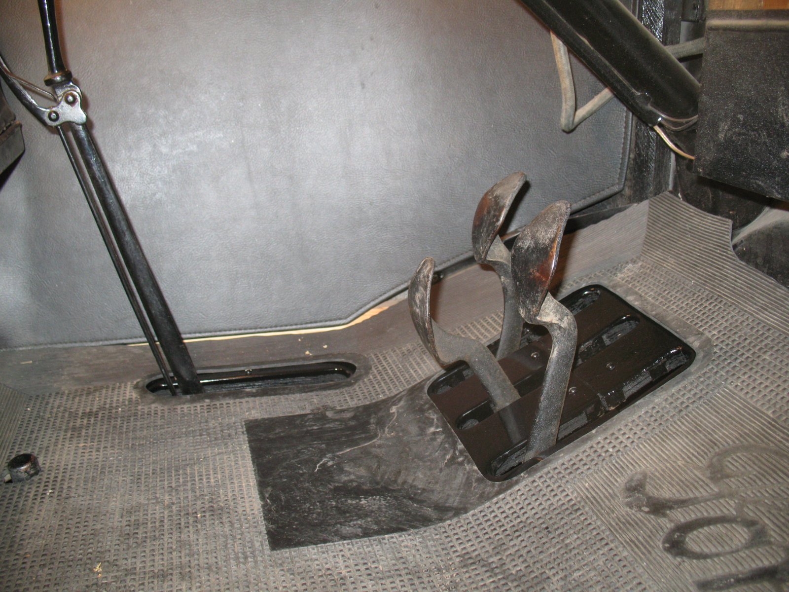

Don't you have the metal trim for the lever and the pedals?
My mat is in a 1923, but I'd be surprised if the same thing isn't available for 25-27.
https://dauntlessgeezer.com/DG114.html

Steve, I've never seen a trim plate like yours. That would probably solve my installation problems.

Steve - the metal trim for the pedals and lever is supposed to go under the rubber mat and attached directly to the wood floorboards.
Posts: 7411
Re: 26-27 Floor mat
Post by Steve Jelf » Mon Nov 25, 2024 11:47 pm
Yes, that's why most mats have a square cutout to go around the pedals.

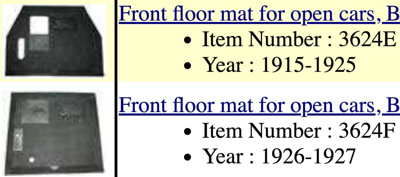

Steve, your metal plate around the pedals is so nice and shiny I mistook it for an accessory plate fitting over the mat. After closer inspection I see that the older mats are cut out around the pedals. Looks like Ford wanted to make the interior more weather proof and made the pedals fit through slits to keep some of the air from coming in.
Using the image from Lang's catalog, we can see the difference between the earlier and later floor mat design.
