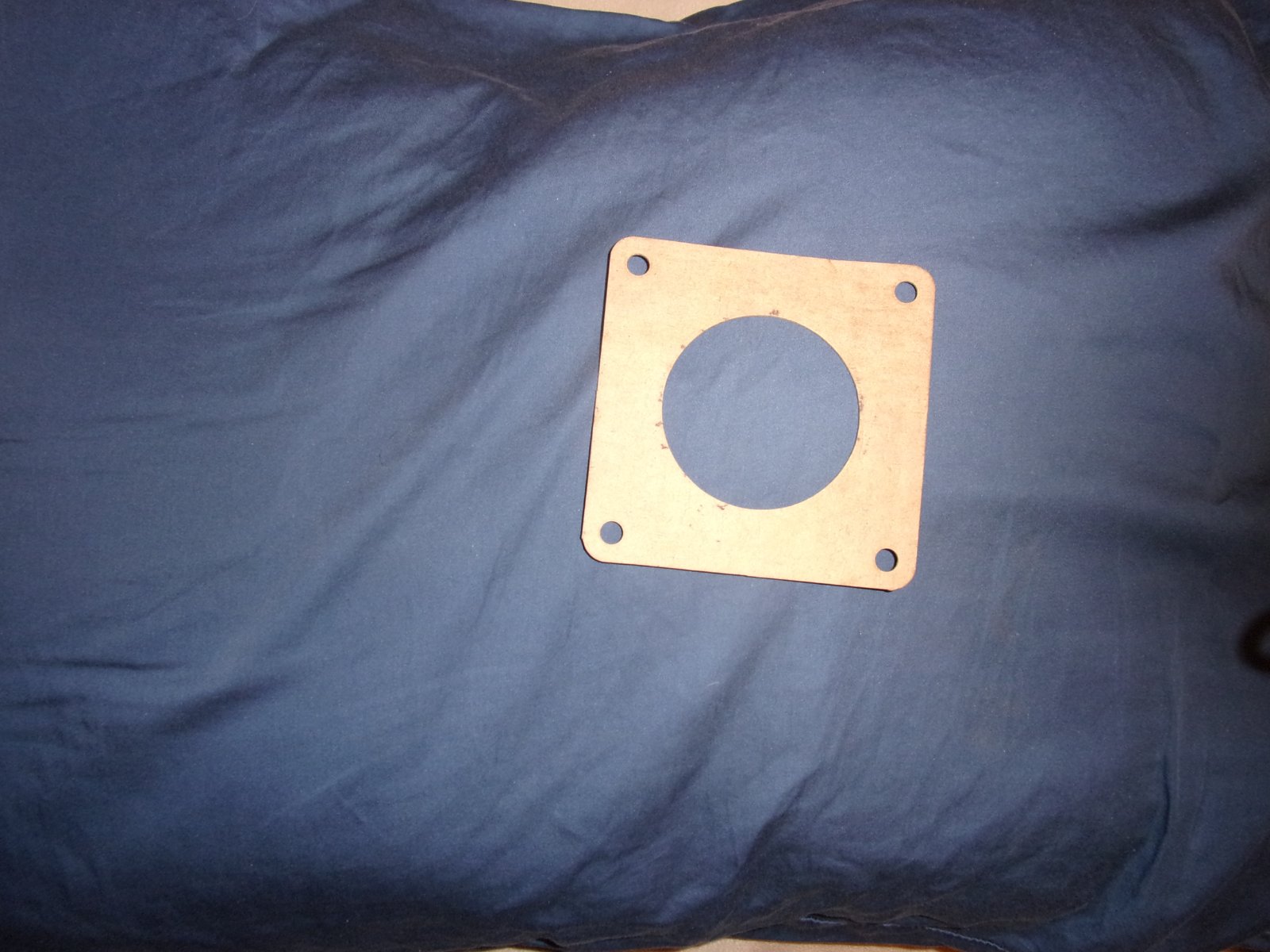

The next time my wife tells me to throw something away, I'll remind her of this scenario ...no, I don't sleep with this under my pillow, just used it as a backdrop. Found it in the T parts stash. FYI the thickness is 5 business cards.
But, nice to know I had some options.
Thanks to all.

The one I brought online is 1/32", same as the one I took off.

The one that came off was so gooped onto the bell housing that I had to use a scraper to get it off and it felt like paper, then rubber, then paper again, so I had no idea what the original was supposed to be. Now I know. Bubba may have used that six pack cardboard and a tube of CRV silicone. I will try to use just enough to hold the gasket in place while assembling the starter.
