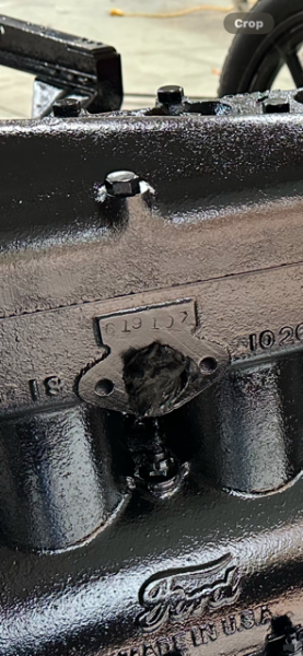

Terry, I used just one piece of brass which was cut/shaped to conform with the whole boss, including the water out;et. That way the plate is held in place by the outlet bolts. The brass is approx. 1/16" thick. I stamp the plate with the required number. This will distort it somewhat from flat, but it can be tapped down flat again of after being numbered.I fit the plate and water outlet with a coat of black silicone gasket maker next to the block, and the usual gasket between the plate and the outlet. Smear the excess silicone around the perimeter of the plate and you won't know it is there.

Terry, my advice on this is probably controversial, but just whom are you trying to convince with that number? If it is the DMV or your insurance provider, that brass tag will be useless!! Matter of fact, likely it will be such a 'red flag' that it will likely cause you more issues than you would have if you just had the incorrect number on the engine block.
If you feel compelled to display a number, then remove the existing number from the engine block and deface the pad with a needle scaler. Then purchase one of the early brass tag (https://cdn.modeltford.com/i/c/476307l.jpg) and have a trophy shop or local machine shop engrave/stamp the number you are wanting. Then discretely affix the data plate to the firewall or healboard of your T. The less 'MacGyvered' you make the restamping, the less of a chance you will ever have anything said. Gluing a brass plate to the engine block will definitely have the look of MacGyver!

If the car was in a bad accident or got stolen and recovered, the brass plate would be a call for vin fraud. Best to restamp to look as authentic as possible.

A good DMV inspector wouldn’t pass a car with a brass plate over the original engine number location. That’s a dead giveaway of possible fraud. My opinion. If you don’t have a original number to go by but have the correct year engine for the car carefully remove the number of the block and restamp the number you have on the title if you have one. Many a T block has been done that way. If your trying to restore a car as original as you can get it good luck with it being perfect. More than a few T’s have been built up with parts for a certain year and have an engine from that year range. The titles have usually come from a bonded title service.

Terry, As others have said, the brass plate over the original Ford number boss is a bad idea, it would be easy to spot by any offical checking the number. You don’t have to take the 1926-27 block that you are using back to the machine shop to remove the non Ford number. Get a good sharp mill file and a good right angle handle. Take the water inlet off the block and carefully and slowly file the old number off, the number stamping wouldn’t be that deep, be sure to file the complete boss and water inlet area. You should keep the cracked 1926-27 block that you are going to use the number off of, with the crack marked with some paint. Now you can stamp the good block with that number and not worry about how close the stamps you use are to the Ford stamps because you still have the damaged block in case something comes up. By the way you say that you are going to use a vaporizer carburetor so you would need a late 1926 engine number or a 1927 engine number so you should be ok if that junk block had a 1927 number even if the car is called a 1926 on your title. A 1927 car made in late 1926 could have had a later 1927 engine installed at some point. Enjoy your car and good luck at your State DMV.

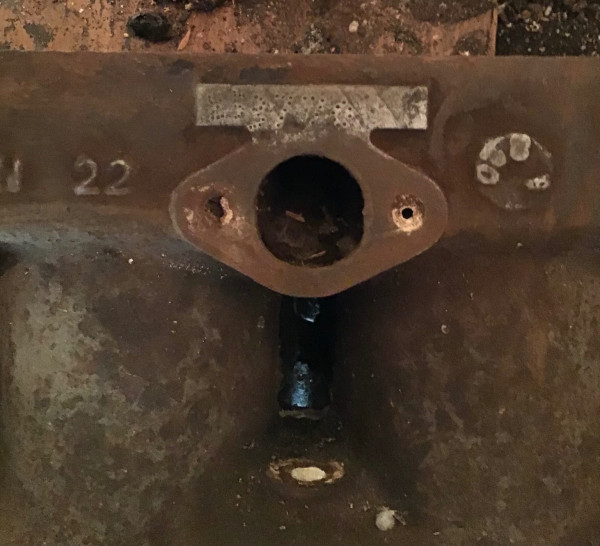

I Had planned to try to remove the non-Ford number from my 27 block with a hand file or a Demel tool, even before I read the months earlier post about stamping a brass plate. After reading everyone's posts, i think I will revert back to that method. If any file marks are left with the file, I'll either go over the area lightly with a finer file or use a piece of Emory cloth attached to a small wooden block. As for legality, in Texas, even if you are changing the motor number on a title, it can be done (and I have done it previously) at my county office where title applications are made, prior to them going to the state for finalization.kmatt2 wrote: ↑Tue Nov 26, 2024 10:21 pmTerry, As others have said, the brass plate over the original Ford number boss is a bad idea, it would be easy to spot by any offical checking the number. You don’t have to take the 1926-27 block that you are using back to the machine shop to remove the non Ford number. Get a good sharp mill file and a good right angle handle. Take the water inlet off the block and carefully and slowly file the old number off, the number stamping wouldn’t be that deep, be sure to file the complete boss and water inlet area. You should keep the cracked 1926-27 block that you are going to use the number off of, with the crack marked with some paint. Now you can stamp the good block with that number and not worry about how close the stamps you use are to the Ford stamps because you still have the damaged block in case something comes up. By the way you say that you are going to use a vaporizer carburetor so you would need a late 1926 engine number or a 1927 engine number so you should be ok if that junk block had a 1927 number even if the car is called a 1926 on your title. A 1927 car made in late 1926 could have had a later 1927 engine installed at some point. Enjoy your car and good luck at your State DMV.

Allen, you are correct, a belt sander would be easier than filing, but a table belt sander is out for obvious reasons and even most handheld belt sanders are so big and heavy that it might be hard to sand the inlet/pad surface evenly without letting the belt hit somewhere else on the block, causing an unwanted injury to the block. I am going to check and see if any company makes a mini handheld belt sander, however I hate to buy a expensive tool for one job. A couple of files and Emory cloth should be a lot cheaper.

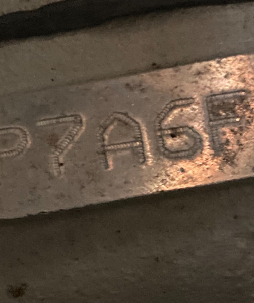

What ever way you put the number on don’t do it like the one on a block I’ve had for years. Maybe it worked way back when! But!??
Topic author - Posts: 1417
- First Name: Terry
- Last Name: Woods
Re: Using A Brass Plate When Changing Engine Numbers
No John, I'm not redneck enough to do it with a pin center punch. I have a set of number stamps.John kuehn wrote: ↑Thu Nov 28, 2024 8:35 pmTerry

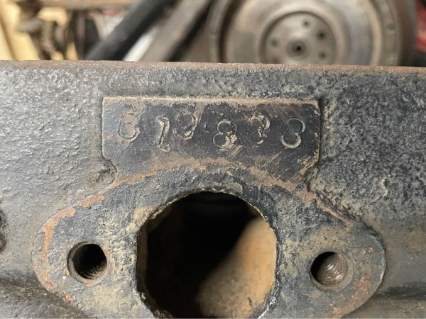

Make a stamping guide out of scrap angle iron or strap steel and drill mounting holes to mount guide using water inlet bolt holes. The following pictures of Ford assembly from around 1918-20 are taken from a Ford made movie on Model T assembly.
- Posts: 6609
I have yet to see a T model engine number stamped all in line and all numbers standing straight up. If I was a DMV inspector and saw this, I would suspect something nefarious was afoot.

I agree that the numbers were not all straight, at least in the early years. The freshly painted block is mine and the other one is for sale on Marketplace. Arthttps://www.mtfca.com/phpBB3/download/file.php? ... &id=202923
