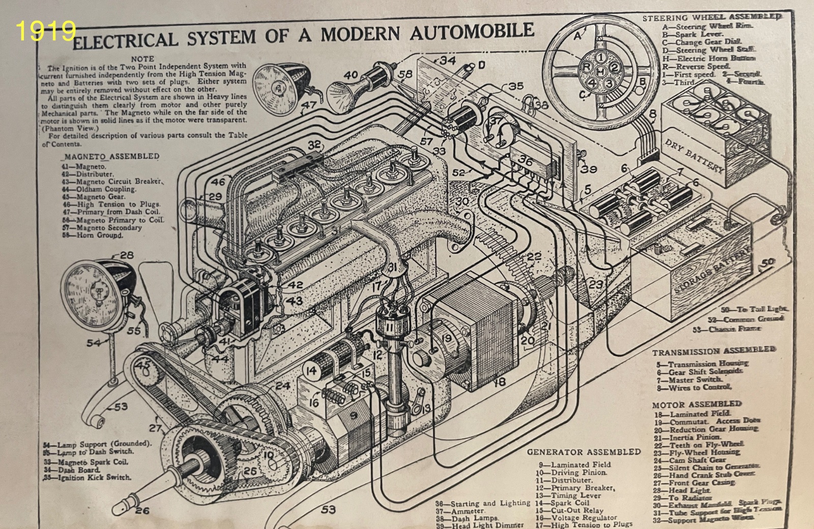

Post by DanTreace » Sat Nov 30, 2024 12:28 pm
The Model T low tension flywheel magneto and independent 4 coils and timer was a very effective system for ignition and certainly not needlessly overcomplicated.
The system up to 1919 did not need the storage battery for lights and starter to remain in good condition, even without the battery, the ignition would still work.
That could not be said for cars that required a battery for ignition, early cars used dry cell (non-rechargeable ) batteries for ignition source. Early cars were normally found on the side of the road not lacking oil, water, or gasoline, but the dry cell batteries were drained dead.
Typical battery systems of ignition for cars, the early Atwood Kent used dry cells, the others use storage batteries and a charging system on the engine.
Click on image to enlarge
Here is the modern car in 1919, as published in Automobile Ignition and Valve Timing Starting and Lighting including the Ford System, J.B. Rathburn, Stanton and VanVliet Co, Chicago Publishers, 1919.
Now this is a complicated self-starting and lighting and ignition system IMO.
click on image to enlarge
The high tension magnetos are very elaborate in construction, delicate and use lots of expensive parts, plus need oiling for maintenance, which was not needed for the Ford flywheel magneto.
Only two things can go wrong on the Ford magneto, magnets can loose power, or output terminal can be shorted by fiber band lining debris.
Ford's Model T was built to be low cost vehicle with high reliability for the average citizen buyer, as opposed to the wealthy auto buyers who needed to have a mechanician to ride along on the jump seat in their expensive and complicated vehicles. ;)

All Model A cars had starters, which require a storage battery and generator, while all Model T cars did not. The advent of the sliding gear transmission and flywheel clutch probably made the flywheel magneto impractical.
By 1919, Model Ts had electric starters and batteries, which could be used to run the ignition buzzer boxes. It might have been better to have had the electric starter earlier, but the famous price point may not have been hit on the original 1908 model, and the car may not have launched the niche that made it so popular.
