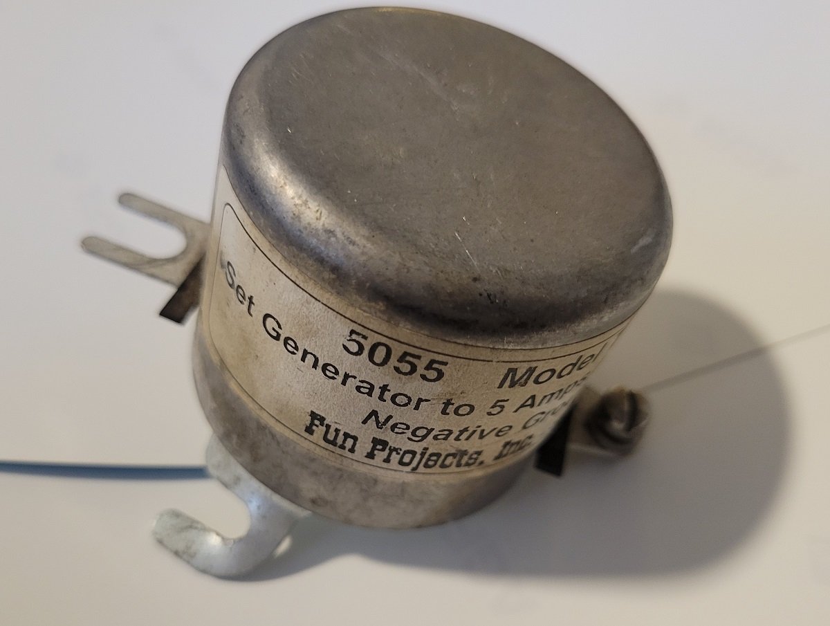

Post by Rodger Erickson » Sun Dec 01, 2024 4:28 pm
I recently acquired a used 5055 solid state cutout from Fun Projects - I'm assuming it's basically a diode with some sort of crowbar circuit to prevent a runaway condition. It seems to have a diode drop in the forward direction and a high resistance in the reverse direction. Does anyone have any recommendations on how to further test it to make sure it's OK to use?

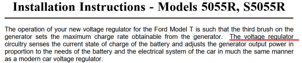

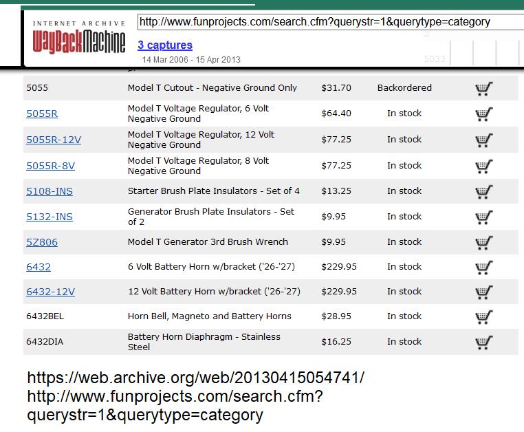

The 5055 is the Cut-Out & the 5055R is the Voltage Regulator
Instructions for the 5055R
5055R Inst.pdf
(42.69 KiB) Downloaded 54 times

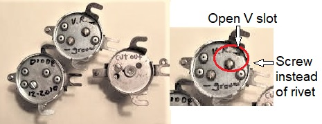

Post a photo of the underside The Top is the Voltage Regulator, the bottom left is the FunProjects Cut-Out and the bottom right is one of the many versions of original cut-outs or reproductions
5055vr under.png (127.47 KiB) Viewed 1721 times
