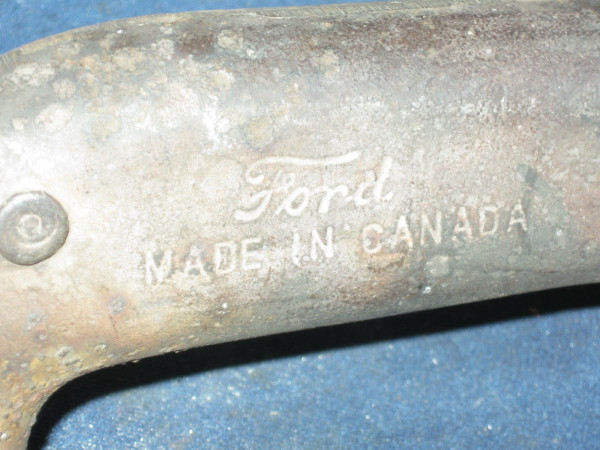

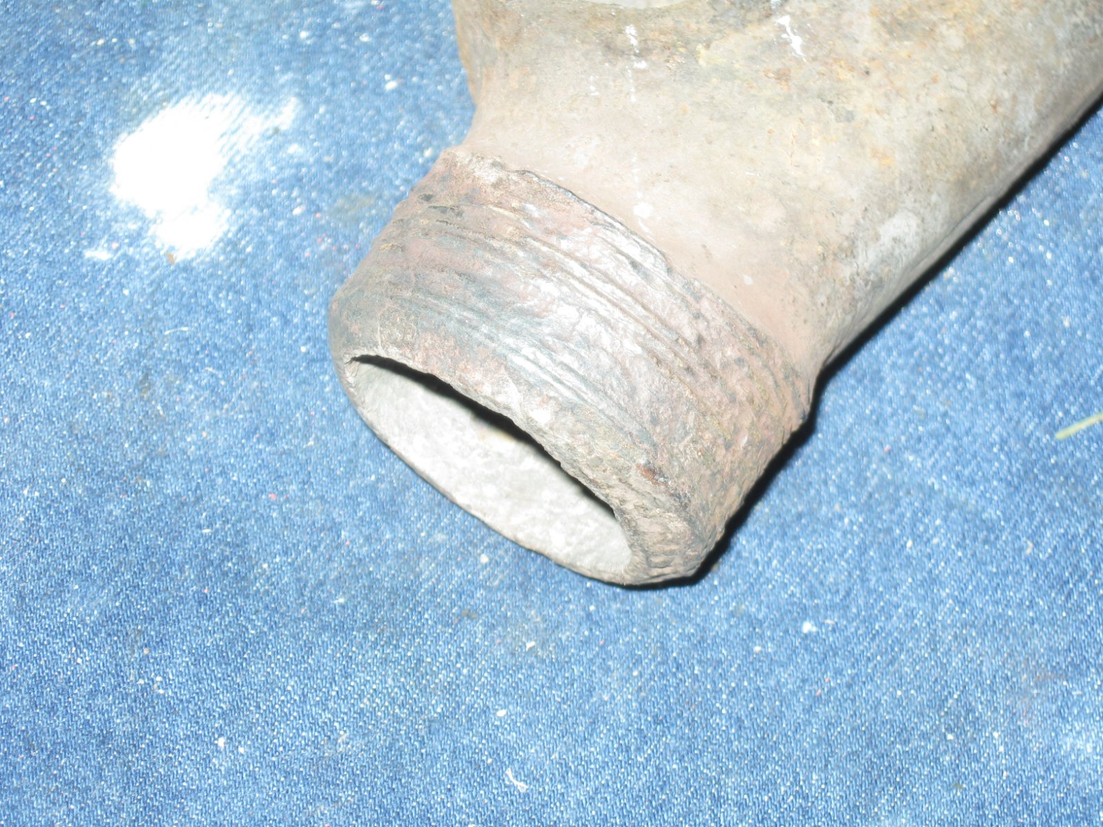

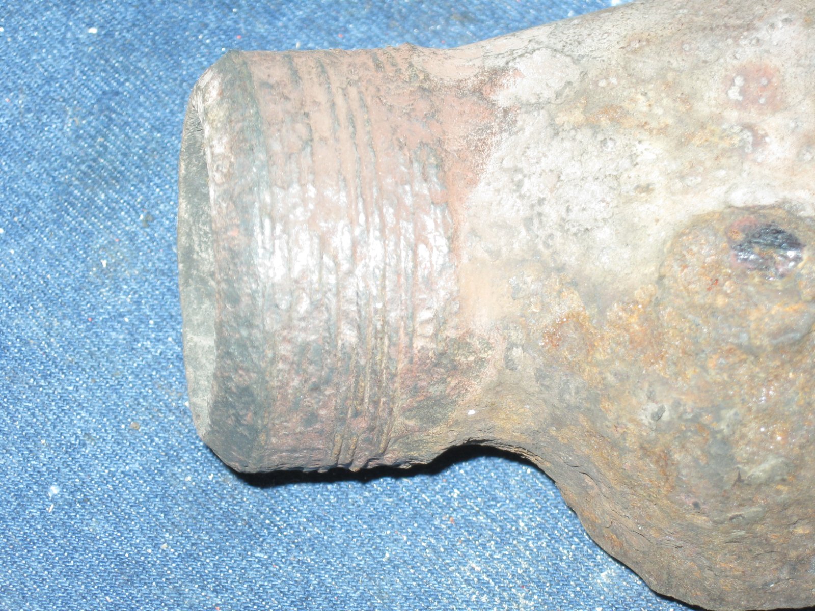

Knowing that if you stack-up enough time, money and skill, anything is possible; What is the viability of thread repair on an original exhaust manifold?
The only reason that I am asking is that this is a Made In Canada manifold and if it weren't for that, it would have ended up in the scrap barrel, straight-away. Aside from the "minor" loss of the threads (and a slight bow) it is a good looking manifold.
I know that a manifold can be straightened, but good quality reproductions are available, I don't think so for ones marked MADE IN CANADA. So, is it worth offering this project up to anyone (I'm looking towards my neighbors to the South in Canada with a side glance over to Australia) or should it just make it's way to the scrap bin? Also, How would you attempt to repair the threads?

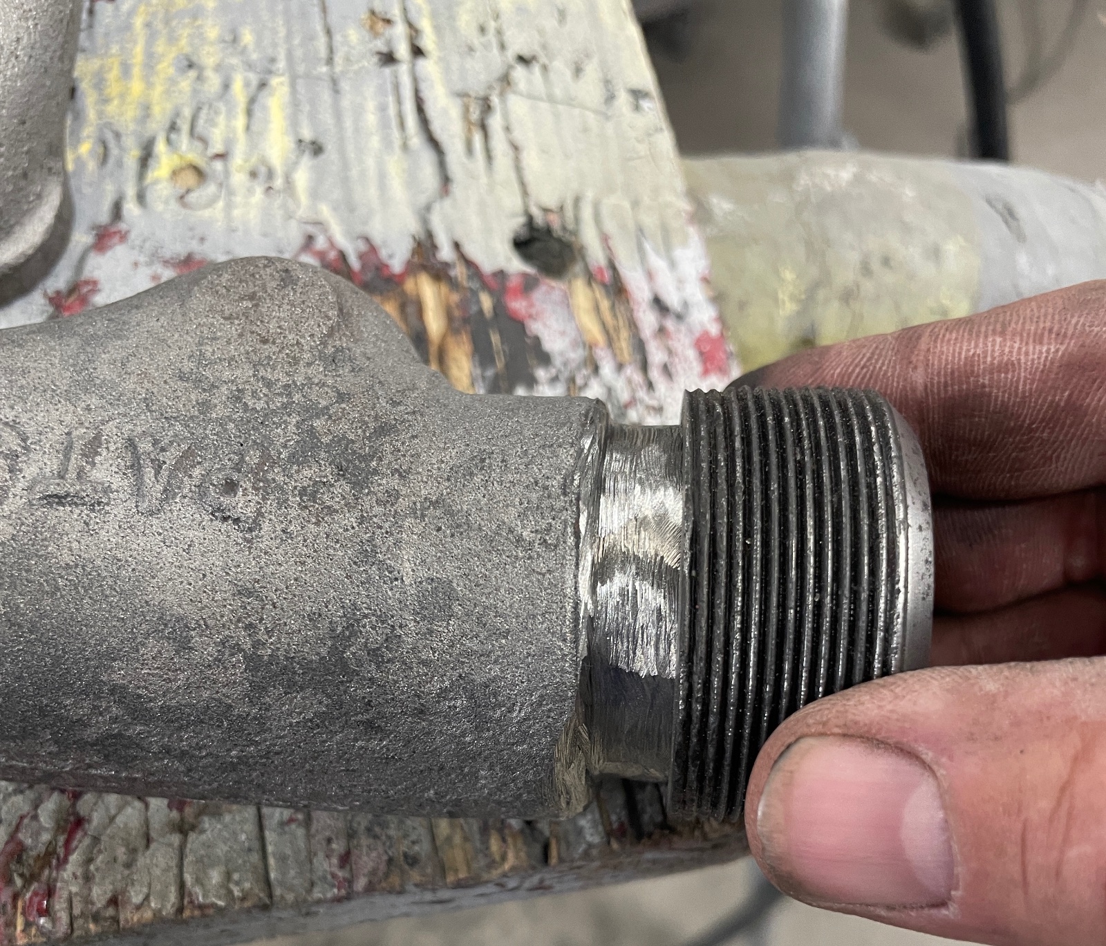

Hundreds of years ago, in the 1970s, I had an unusual exhaust manifold with horrible threads, I pulled out another manifold that had the #1 port broken off but it had like-new threads. Figuring I had little to lose, I cut the good threaded end off the broken manifold and the bad threaded end off the good manifold and arc welded the good threads on the good manifold. The result was fine; no cracks, no leaks, no warping and I drove the car daily for years.

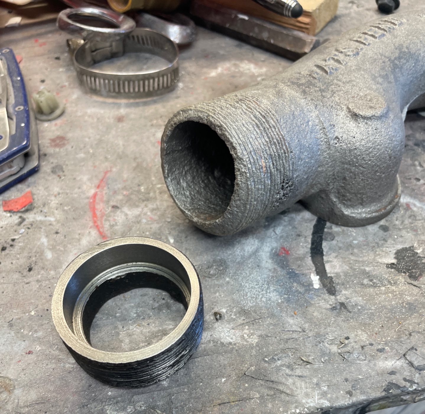

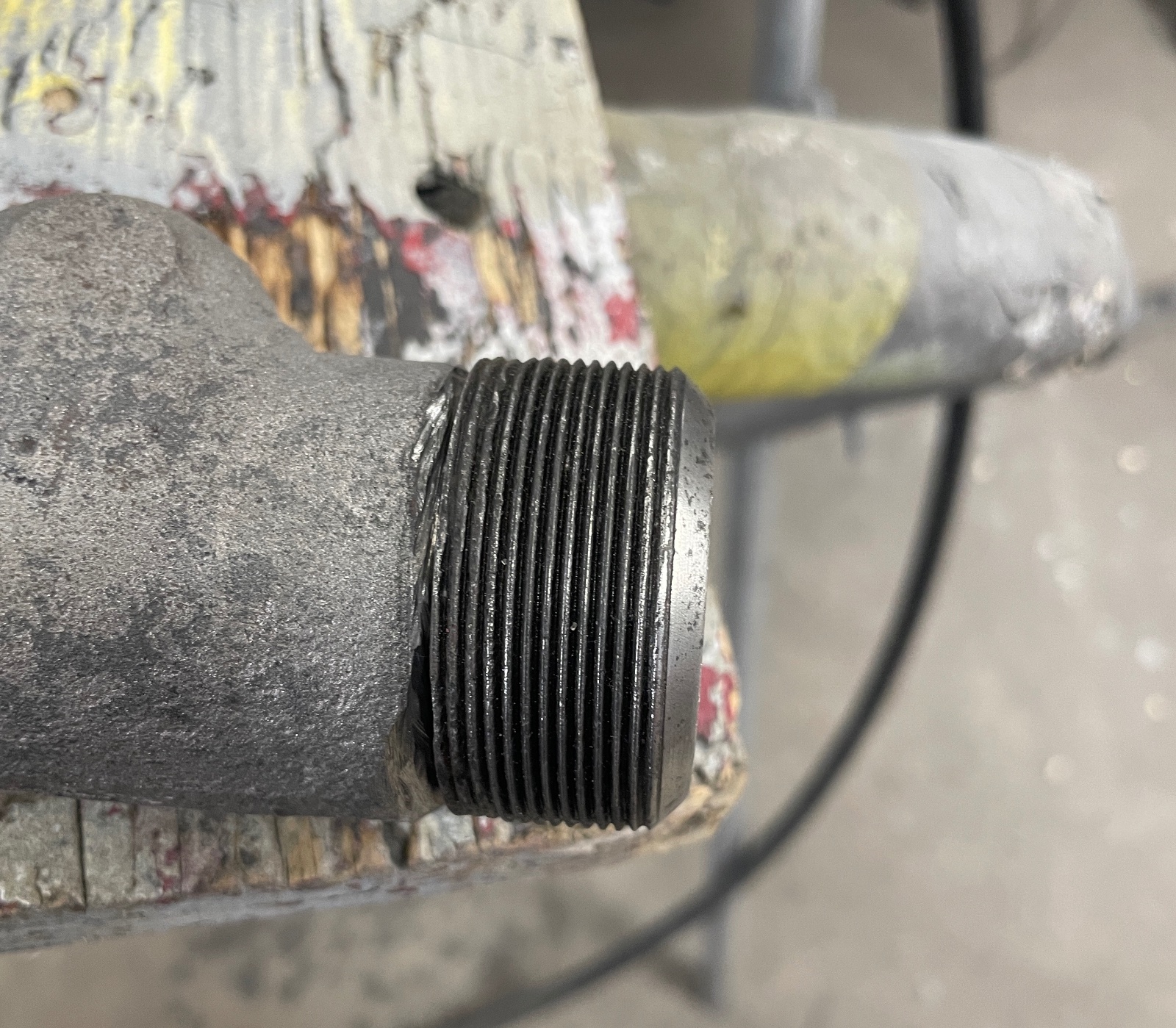

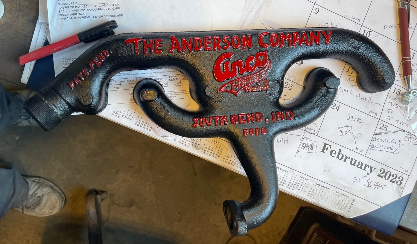

I obtained an ANCO manifold with poor/ degraded threads, so I took a warped standard manifold with good threads and cut them off. I then removed about 1/2 of the inner diameter of the replacement part on a lathe. I then carefully ground the bad threads from the ANCO manifold, checking the fit frequently. Once I was satisfied with the fit, I silver soldered the replacement on. It has offered no problems after 2 1/2 years of frequent use

I’ve done what Wayne suggested with great success over the years by turning the thread off in the mill using a boring head and shrink fitting a threaded sleeve over the OD using a .003” shrink fitting. You need to make a heat sink ring to put the sleeve into first to heat as the thin rink will cool too quickly. Works perfectly

Thank you to everyone that has posted.
When I first came across this manifold in a lot of parts, the only thing that kept me from putting it in the scrap bin straight-away was the MADE IN CANADA on it. After hearing from some members more in the know on Canadian parts, while yes it is somewhat "uncommon" here in the States, not so much in Canada and Australia, better ones can be found.
If doing a fine point restoration (or just being a purist) and this is the only one available, it can be fixed. After looking through this Forum and the old Forum, there was just not a lot of threads/posts on repairing the manifold threads, this new thread has come up with some, and I am sure that they will be read in the future. Thank you again to all that posted but it is time for this manifold to move on to it's new life.
