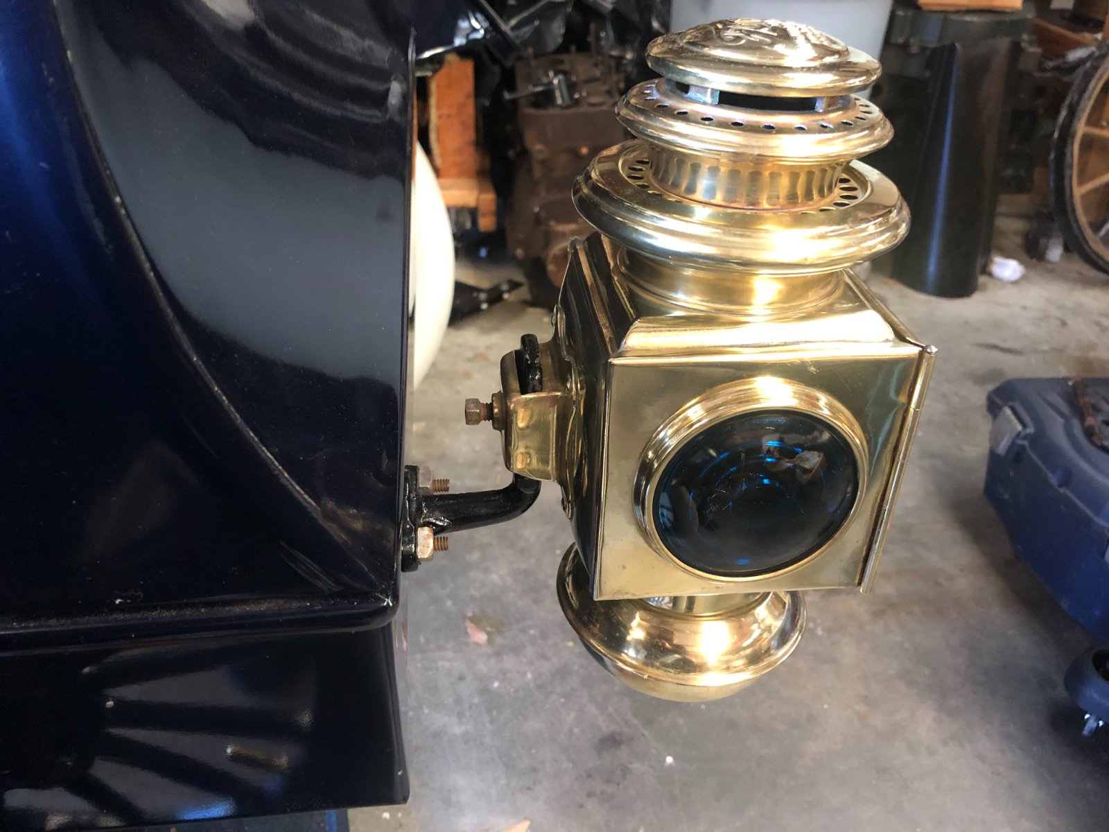

Cleaned up the rear lamp on my 1912. It was really kind of nasty, lots of "brown spots" rather than a nice overall patina. I am learning the joys of having a brass Model T!

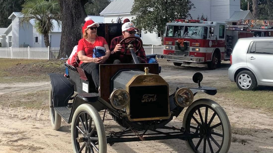

Participated in Saturday’s Melrose FL Christmas Parade. Finished the ‘12 open express which is my interpretation of Harry Jackson’s T, who was a turn of last century resident that made significant contribution to the early town, his delivery carried steamer trunks from the shore of local lakes and waterway from visitors who arrived by steamboats from distant railway in Waldo FL.
Photo is Harry Jackson driving his T transfer express. And my replica in the parade. Afterwards displayed in town park and met grandson of Harry Jackson, great time.

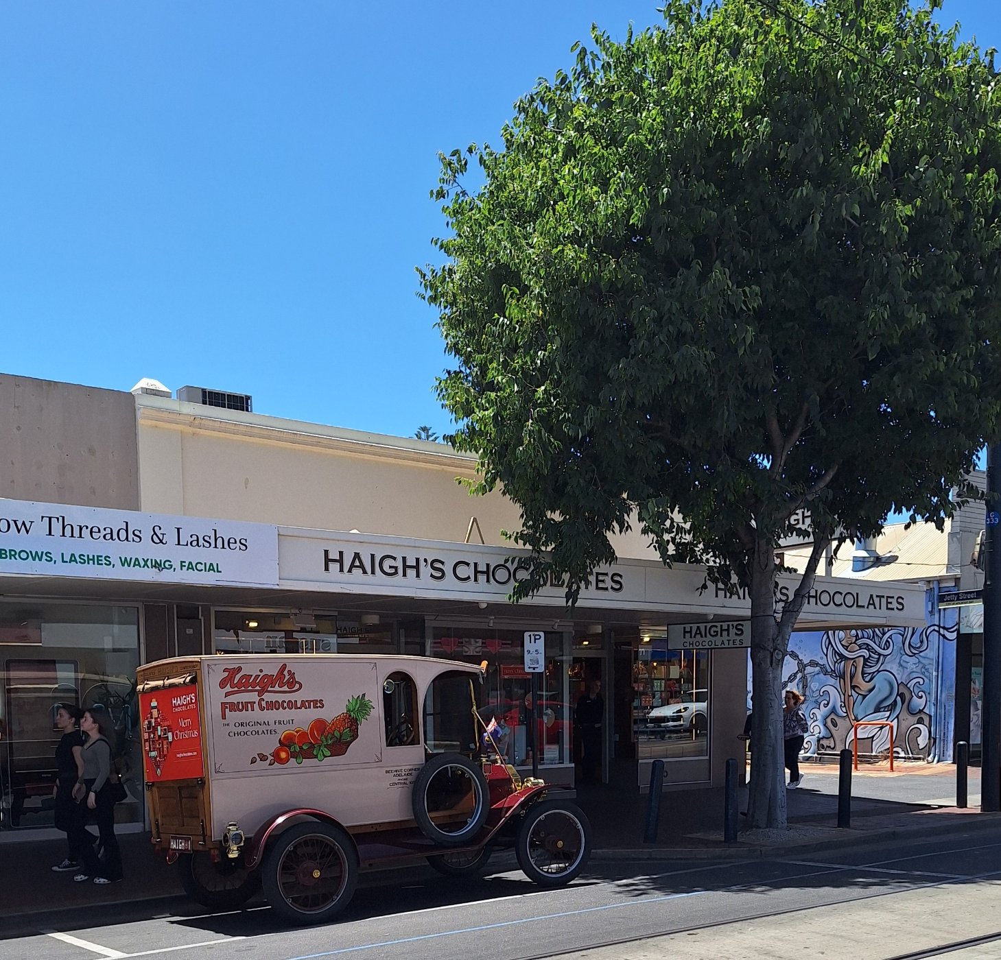

I had two days of driving around the city reminding people to stock up on their Haigh's Chocolate's for Christmas. Life is cruel at times but this is not one of them.

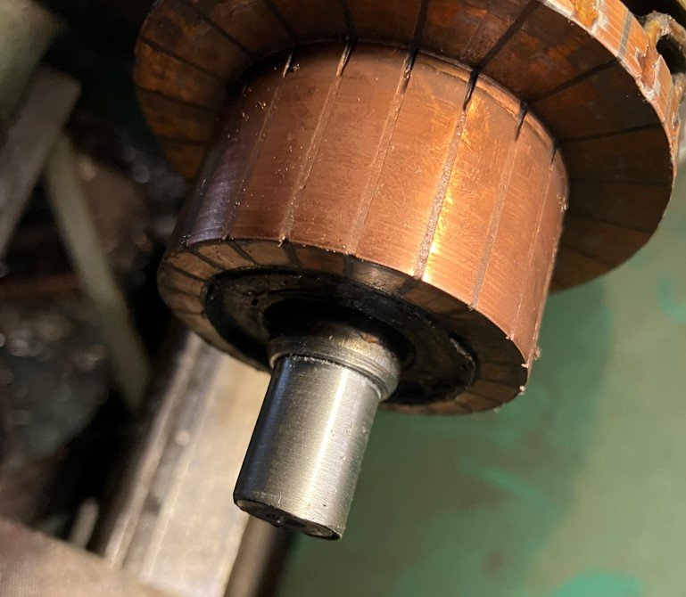

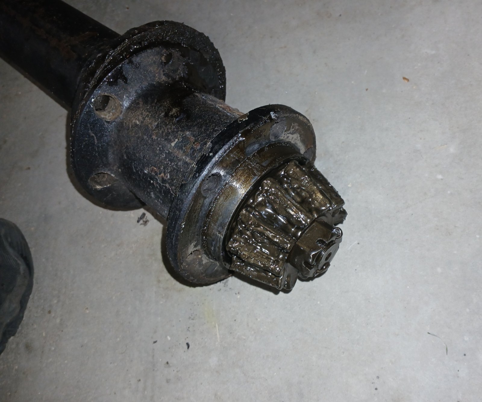

I worked on my starter and sleeved the shaft back to 500". I had a modern steering shaft laying around so I cut it and used a boring bar to get the I.D. correct before turning down the O.D. So I guess this means the sleeve itself is genuine Ford.
Yes I plan to clean up the commutator before installing the bearing and spacer.

@ some point your commuter had the mica insulators cut down. This is not done on starter armatures, only generators.(see the service manual) You can see the powdered copper brush powder shorting the segments. This makes for a weak starter. You will need to cut quite a bit of commuter to correctly fix.TMiller6 wrote: ↑Sat Dec 21, 2024 1:24 pmI worked on my starter and sleeved the shaft back to 500". I had a modern steering shaft laying around so I cut it and used a boring bar to get the I.D. correct before turning down the O.D. So I guess this means the sleeve itself is genuine Ford.

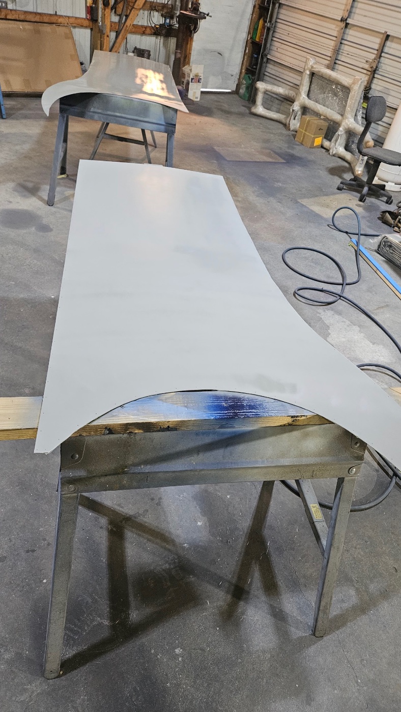

Shooting some primer on the interior side of the Delivery Car upper and lower body panels. Hope to have color on by Saturday.

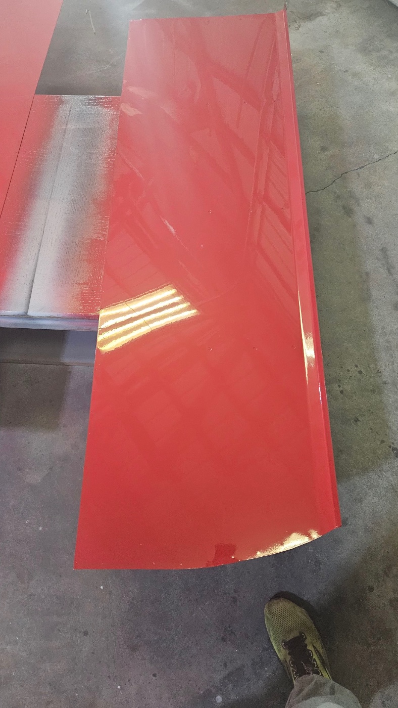

Got the color on the panels followed by 3 coats of clear. I have few little nibs that will need sanded out but overall pretty happy.

Looks good Mike. Wish i had all that space to paint!

Me too! At a friends barn!

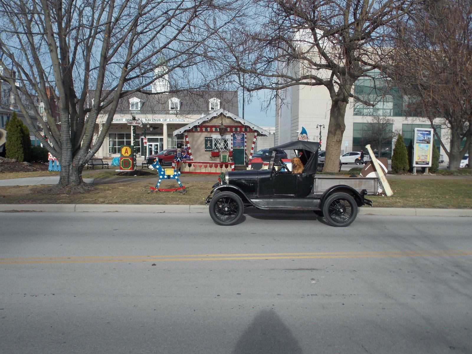

Took it out for a little ride today 50 degrees and sunny perfect T weather. Sandusky bay in the background the old Cedar Point ferry dock in the background on the left.
Santa has gone home till next year but his house is still here.

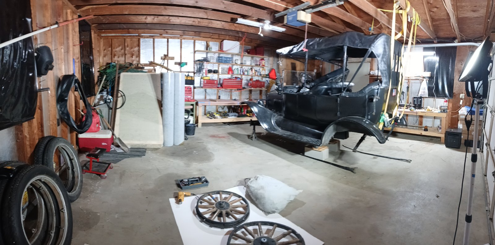

Took it apart some more...
Big list of things to do.
