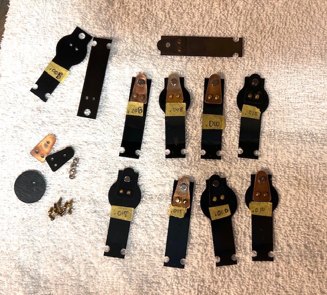

Prototypes
Prototypes

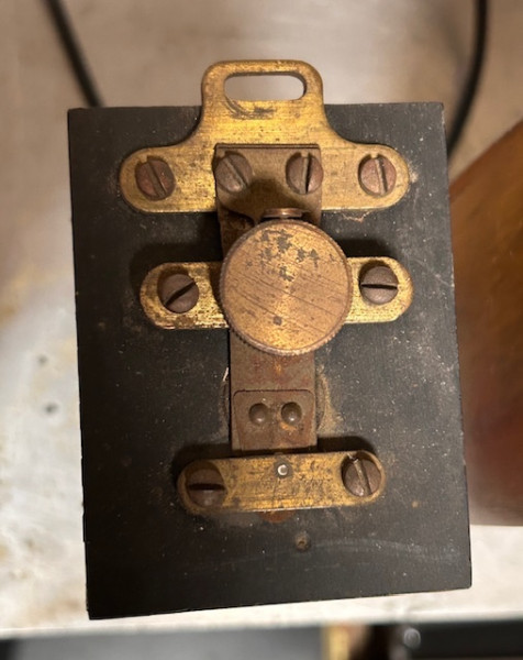

Original point
Original point

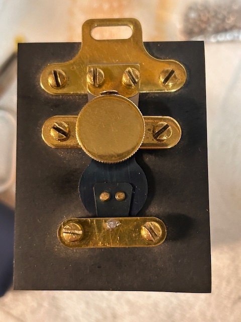

New point design
New point design

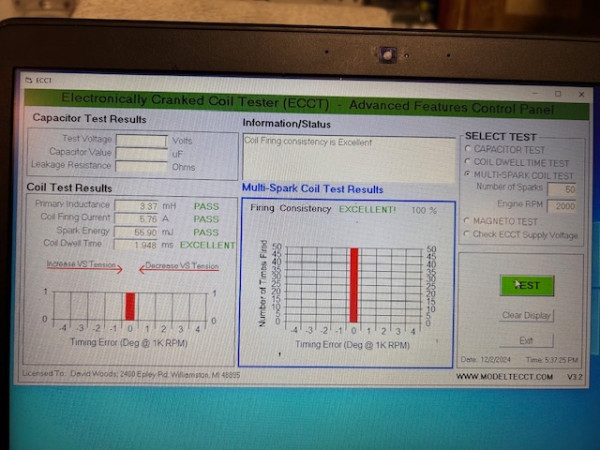

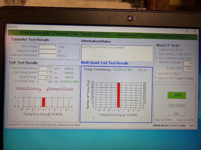

ECCT results
ECCT results
