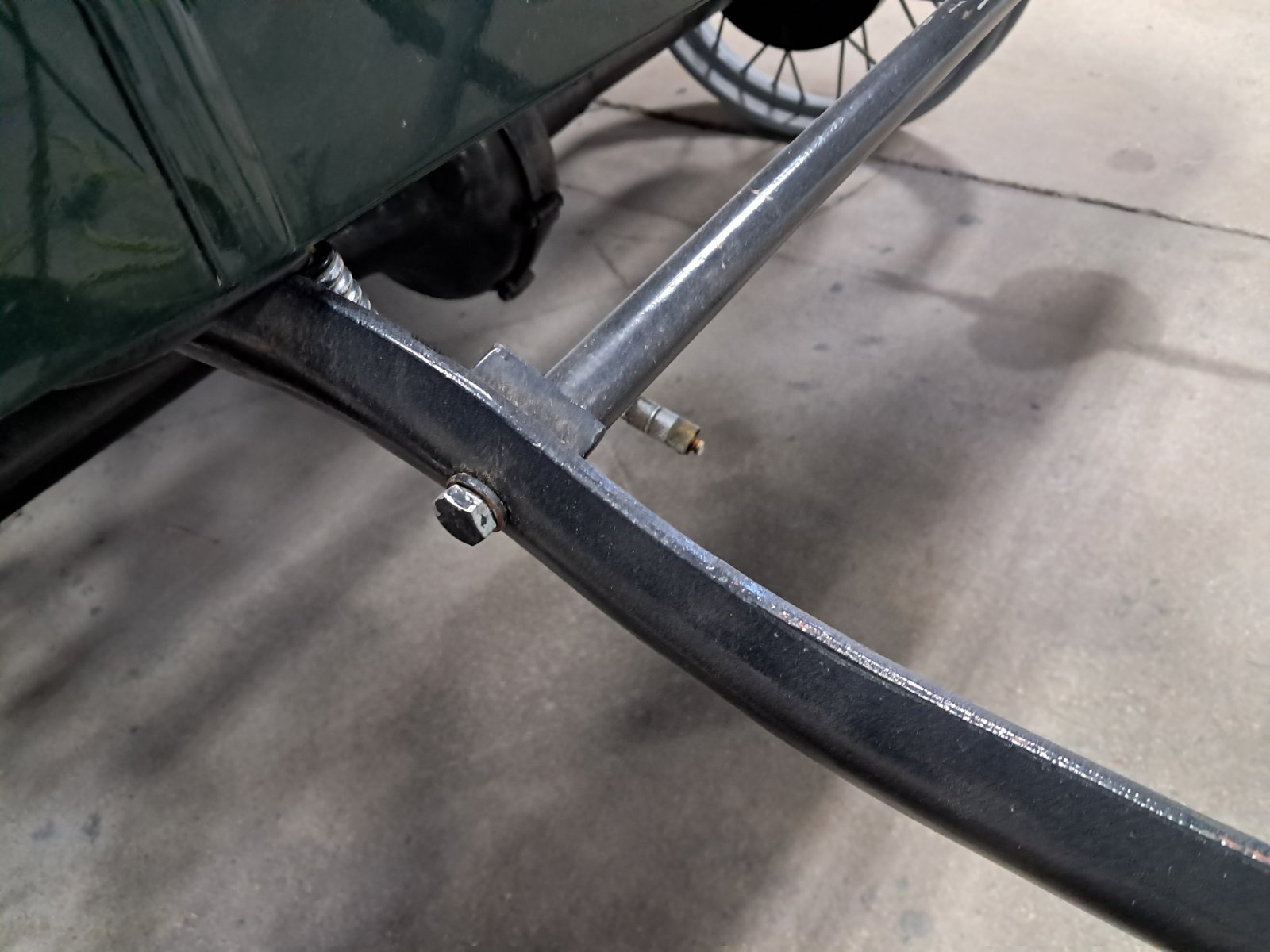

I can show everything for the front. It may take a day to show all.
Vern (Vieux Carre)

You can buy the hardware from the vendors and see what they look like but I made my own front plates from steel.
The modern carriage bolt holes are 1/2" but it looks like to me that originals might have been 9/16".
The nut is square.
front plate 16.jpg (55.42 KiB) Viewed 9361 times
Vern (Vieux Carre)

Post by 26modeltt » Sat Dec 14, 2024 1:13 pm
Attached are photos of the rear bumper brackets from my '26 T coupe showing a tubular cross member --- any idea of the manufacture?
I don't recognize that one. Never seen it?

Model A bumpers have closed outer ends through which a bolt passes. T ones are open ended.
